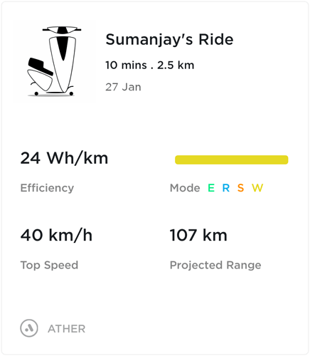

Achieved this efficiency following your tips. Thanks. :v:
Great to hear this, happy that my tips were useful.
