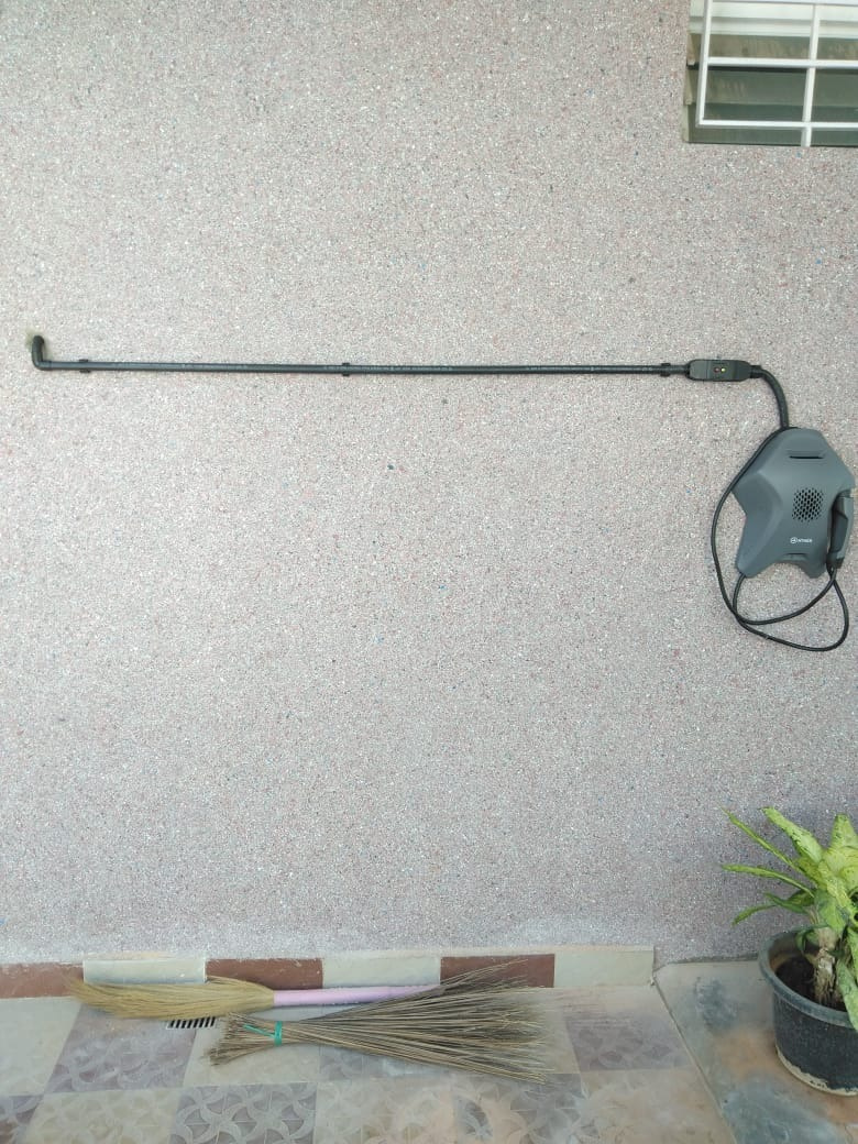

Hi, I just got the installation of home charger done today by Ather team. They had taken the connection from a normal 3-pin socket from within my home. I’m not sure if this is still the fast charger. I had seen pics in forum before that they take directly from meter. Can anyone confirm this is right installation?
