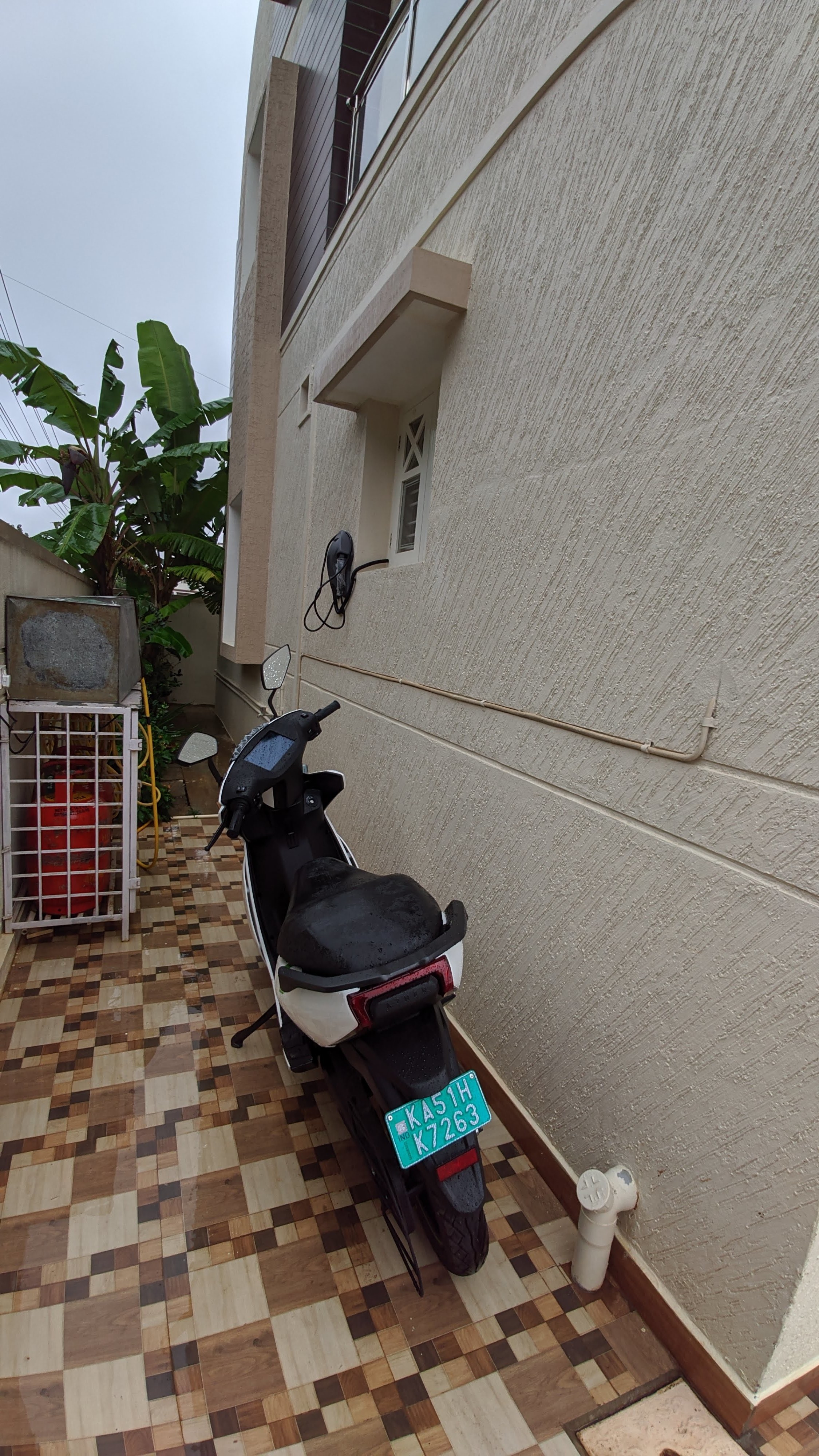

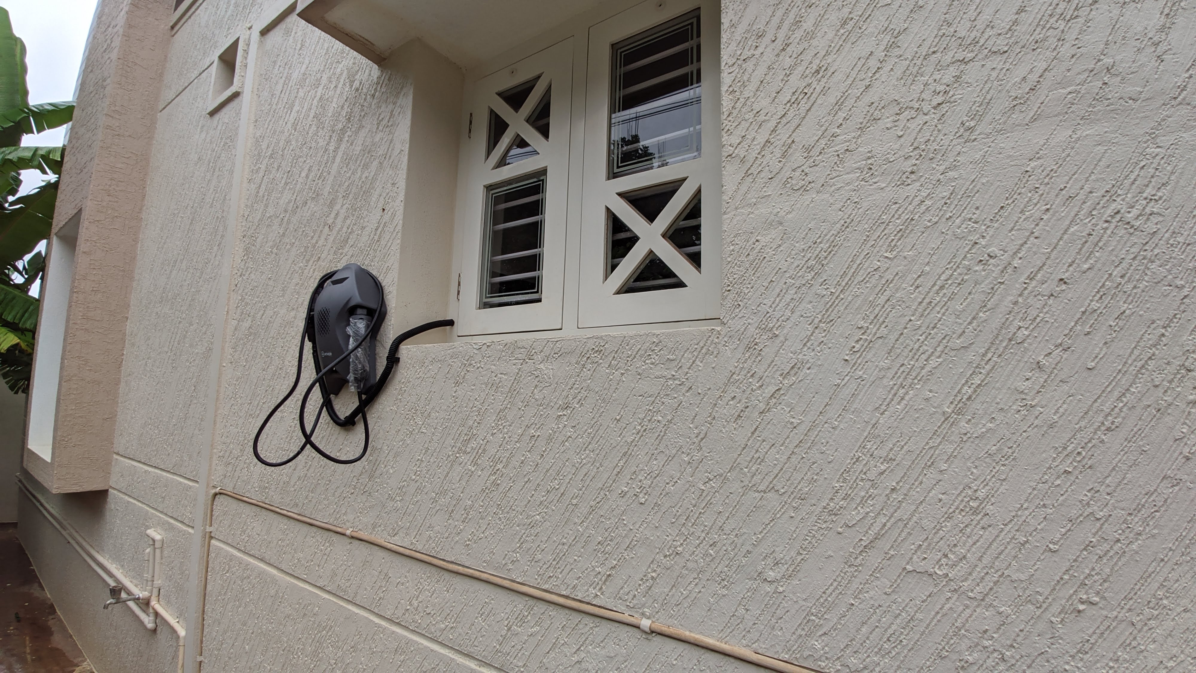

Another problem with the charging was, The Ather Dot was a bit far to connect to the vehicle. I could move the vehicle closer to Dot and charge but that would completely block the passage with no room to walk. I wasn’t there on the day of installation and my dad used another scooter to estimate the distance and that’s where the mistake happened, Ather bends way too much on the side stand and that scooter didn’t!
The passage will block if I move the vehicle any further and If I have to charge it I have to move till the cylinder area.
Since they were replacing the Dot on Monday, I called up customer care to request to move the dot by 1 - 1.5 meter.
The request was to move the dot from left side of the window to right side of the window.
Overview of distance between left side and right side
