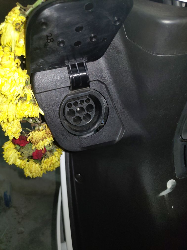

Just wanted to ask ather folks whether that spacing between the charging port and the space given is normal and unequal or it is a flaw in my ather or many ather scooters
Ohh yes, even I wanted to ask this. I can see the ground from this gap !! Is it normal ?
Even if you have it then i guess it is normal i feel
