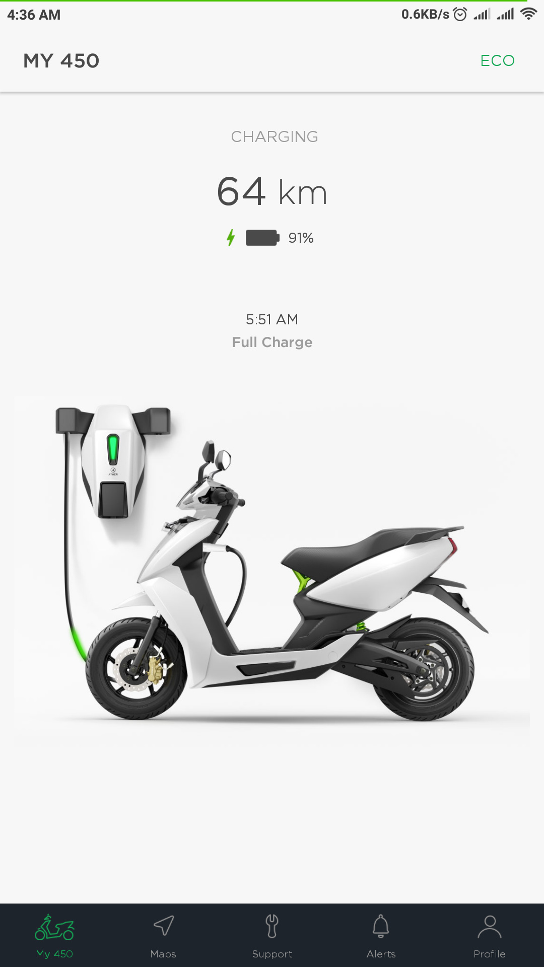

just wanted to share chatting exp al the way to 100%
it is kind of weird with the time to full estimate was never true…
but anyway it was full finally in the morning before i started

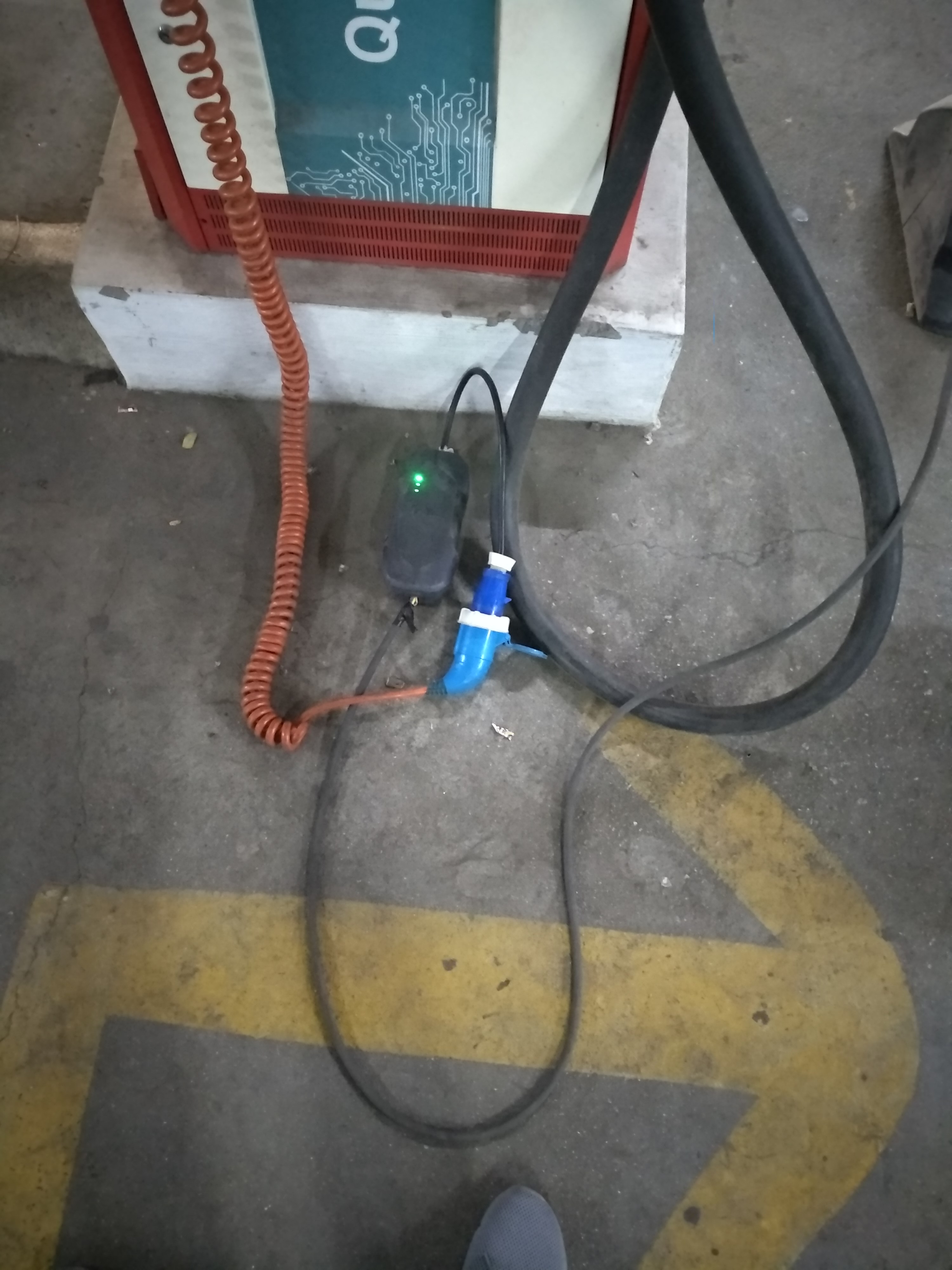

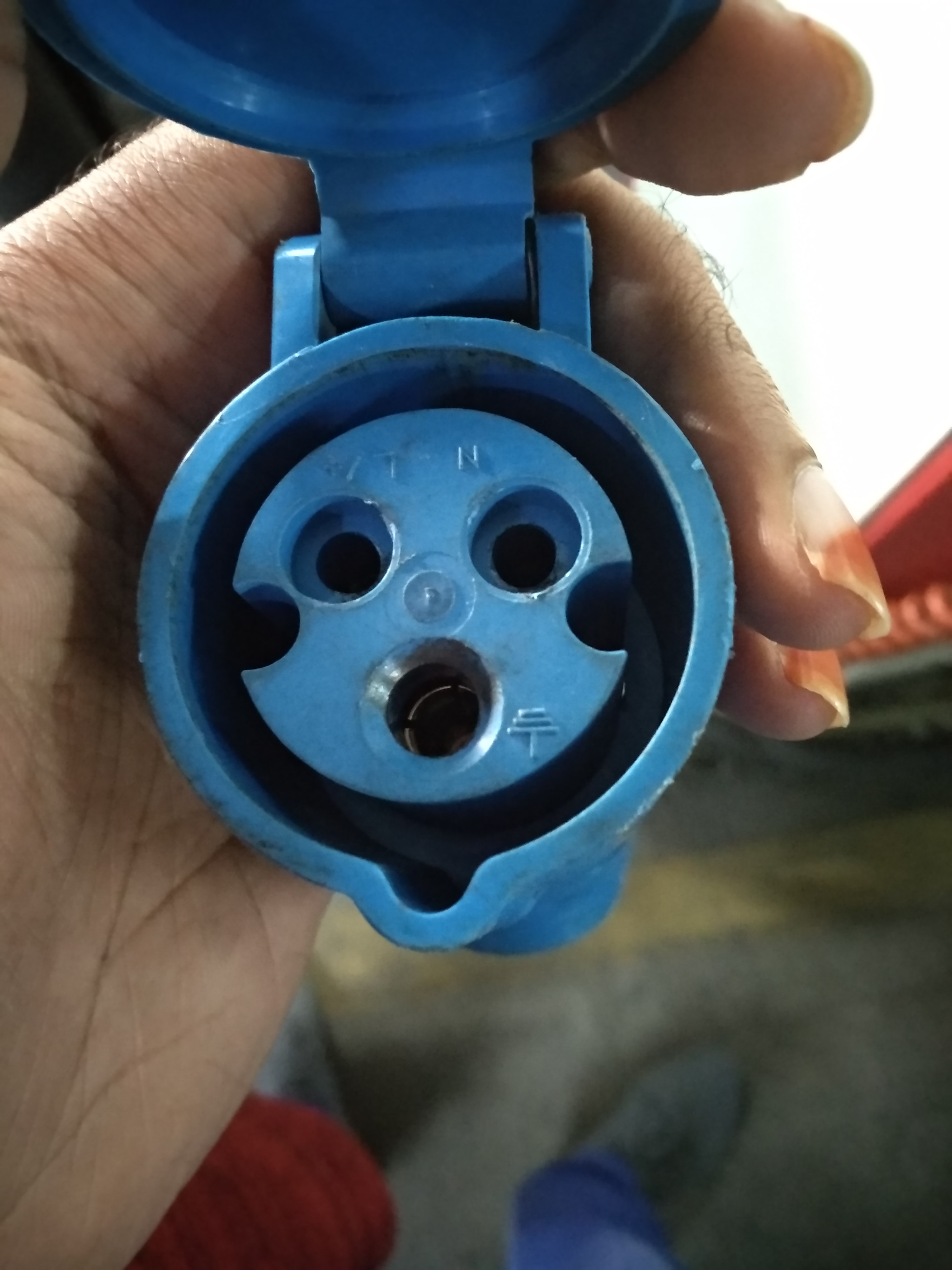

Below is the charging point in my office(Reva car owners use this to charge). Would I be able to use it once I get delivery of my 450 with the portable charging cable provided by Ather?
From what I have seen, the charging cable provided by Ather is a normal 5A 3 pin plug point compatible. So am not sure if the below point would be helpful for me.
I might have to drop an email to my office team to install a 5A plug point
@Shreyas Could you please confirm? Thanks
That socket is a standard industrial socket. Unfortunately you cannot connect a normal Indian 5A plug. Even getting conversion adapters is challenging and even if you do is not recommended, due to potential loose contact.
You will have to put a surface mount box with a regular 5/15A socket, next to it. Use a box with a shutter. So that the socket is closed from dust/water and insects, when not in use.

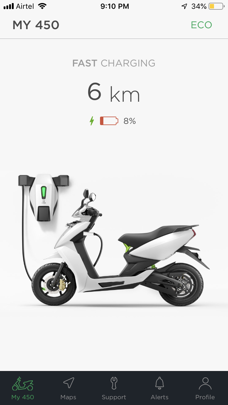

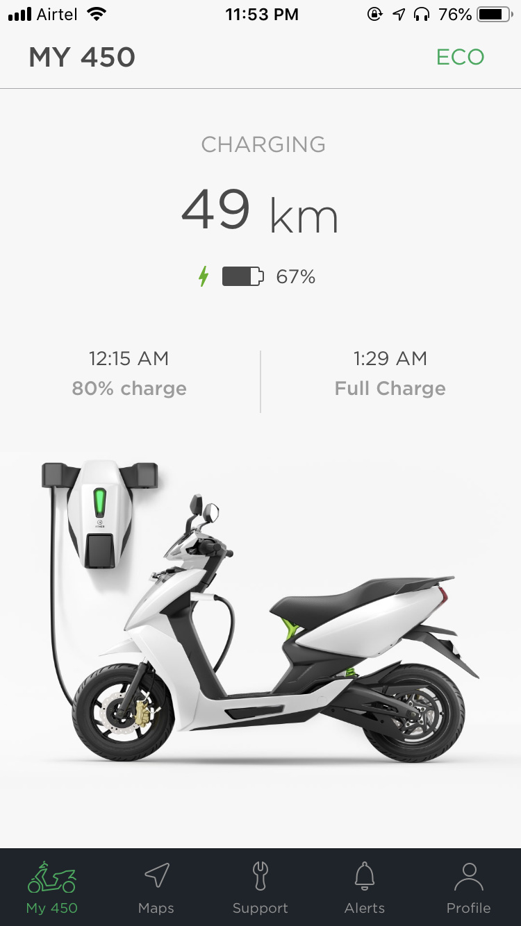

@Abhishek @Shreyas i was down to 6km at 9:15pm and charging till now (11:55pm) got it to only 80% (47km range). Is this expected? How much time is needed for a full charge?
generally it takes around 2+hrs till 80%
and 3+hours to 100%
with home charger
this will slightly vary at times depending on battery temperature
in your case i see this is slightly more time
but i believe it’s normal… may be took time to manage battery temp
please observe for few more times and average should be 2 hrs

I don’t know how Reva users charge using this but in our E20 such a kind of male plug is available in the car and the charging cable for that has a female socket on one end and a normal Indian 5A plug at the other end to plug it into power outlets.
5A socket will be the best solution until something new comes around.
