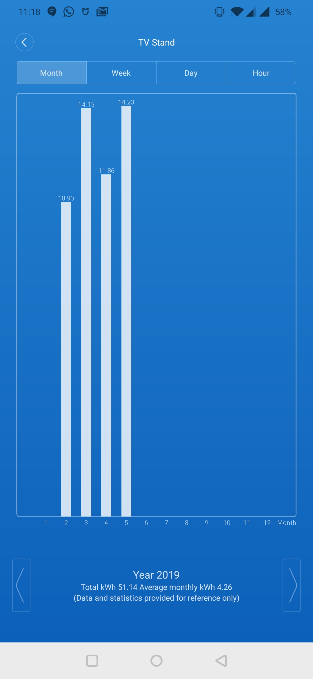

I have one of those Mi WiFi plugs that monitor wattage. I have to jerry rig that to the charging circuit when I get time. The Mi Home app gives me wattage and consumption data.
