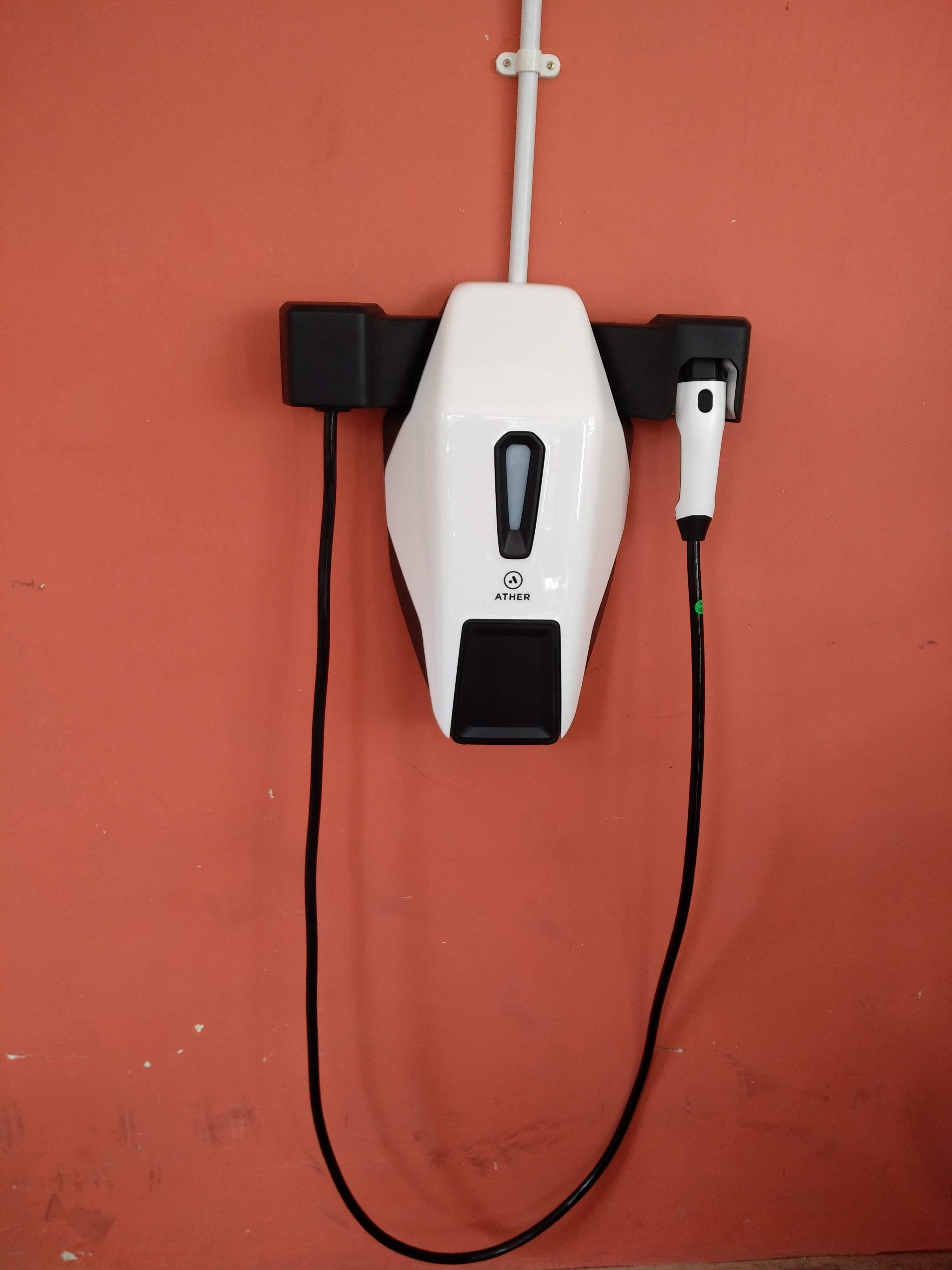

Hello Ather Team and Owners !!
Can you post some pictures of the charging setup done at your home?
Thanks !!
tadaaaa…
entire operation took 1.5 hours
