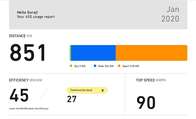

Just noticed something with regards to this
From an old usage report –
From this I’ve consumed about 45*850 = 38.25kW And I had consumed Screenshot_20210227-204104 51units
Taking a 10% loss while charging. That accounts to about 46kW consumed to charge the battery. But effectively I used only 38kW That’s an 8kW loss of energy in just a month’s time. Which I’m assuming is almost entirely vampire drain since my scooter was still relatively new at the time.
@tarun I think you should start taking this vampire drain a bit more seriously for future products and for the existing customers, we aren’t even allowed to shut down our scooter at higher SOC. I really think, you guys need to sort out this issue among old 450s in a regular service at least. This doesn’t look good. To be owning a known defective battery pack which could possible fail in the future when out of warranty.
