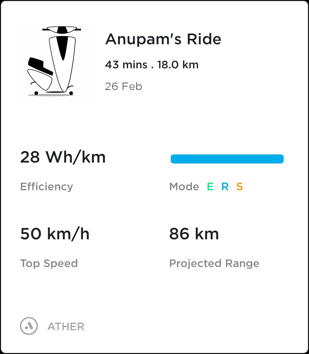

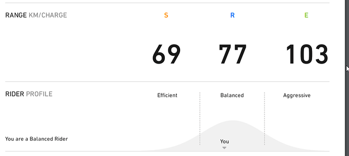

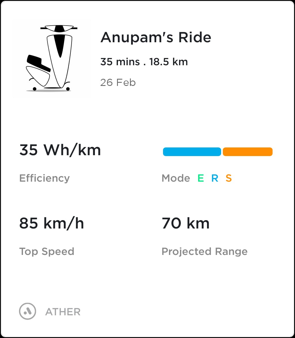

@abhishek.balaji From the past few days, I am observing something which I tried to understand but finally putting it in the forum for anyone or Ather to help me.
At my riding style, I usually get 75+ projected range in ride mode. This is also supported by the projected range showing in the App. But my Ather450 never shows higher than the 65Km range in ride mode in the dashboard, I think that’s normal for everyone.
But the thing I observed is the battery percentage always goes down with respect to the range shown in the dashboard. Like the 100% to 0% is calculated on basis of that 65KM range. In that case, even your projected range is high the real-time range is always as shown in the dashboard. I don’t thing after reaching 0% and covered 65KM Ather will allow riding that extra 15KM.
What is your efficiency? The dash calculates range in ride mode at ~37Wh/Km If you’re getting better than that. You should be traveling more distance than youre losing I’m range I’m ride mode.
If u normally get 75+ Km range then when you cover 65Km you still will have about 7-8 Km range left showing in the dash. But also account for some loses. You might be losing battery while parked which is why you are getting a higher projected range but still higher battery drain. How old is your scooter ?
I usually travel approx 40KM in a day. But the dashboard range actually shows low compared to the projected range. And battery percentage goes down accordingly.
I got it in May 20, So not one year. Also I start at 100% battery every day. So I don’t think after a 9-hour shift the battery will be drained so much that it will affect the range. So you agree there is a drainage issue with Ather’s battery pack. It must be addressed immidiately.

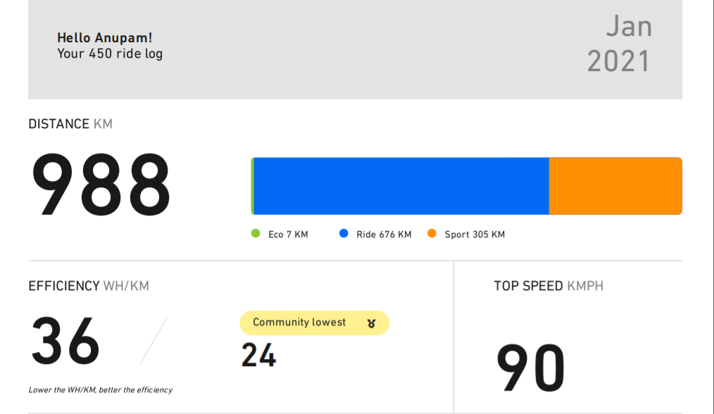

This is My Jan 21 Log.

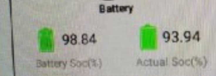

More like 94%
And when it’s 0% on dash it’s 6% This is why I actually never charge over 85-90%

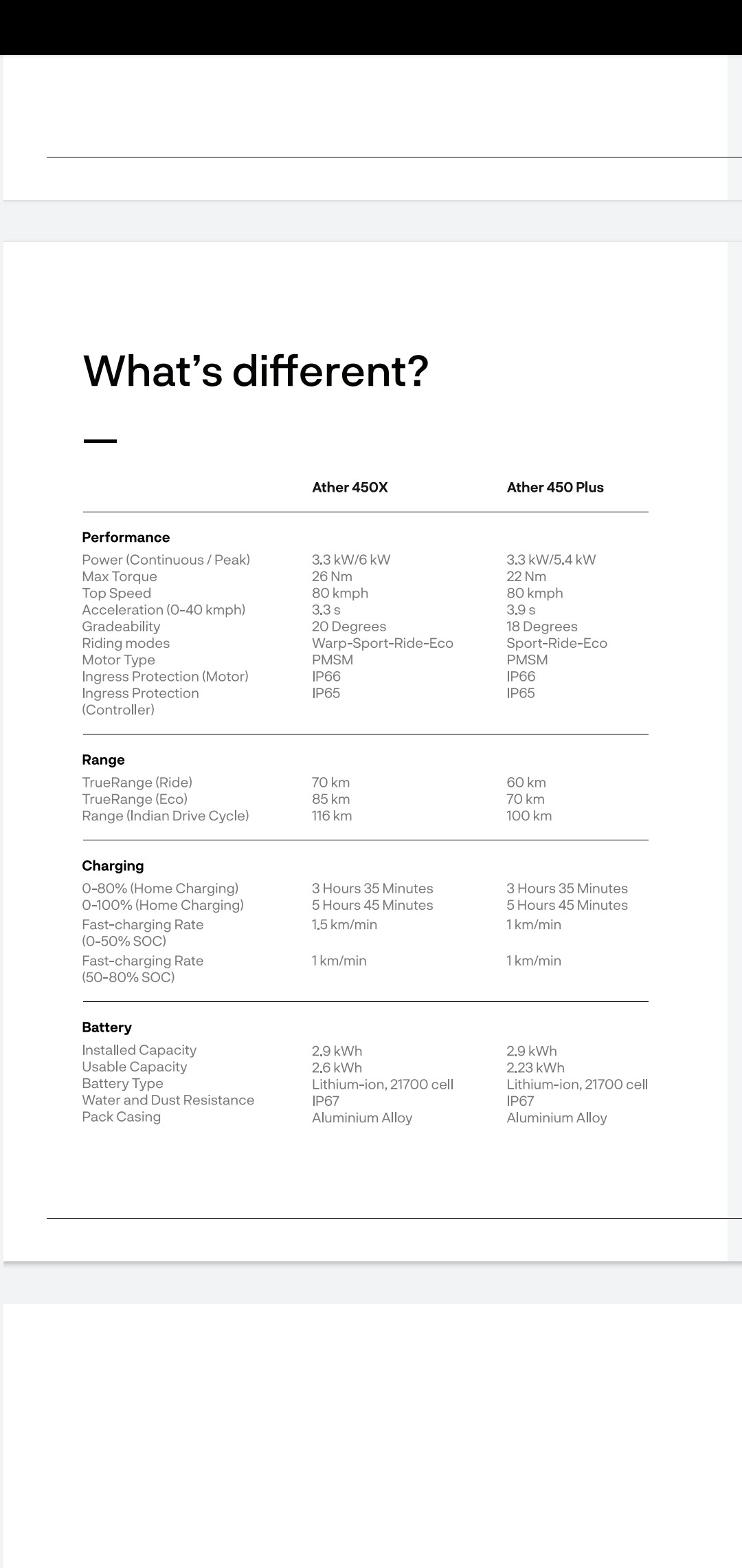

But they said like even 450 and 450x both are limited to 80% of their installed capacity in specification pdf right ?
Idk where they say 80%. Installed in 450X is 2.9kWh and usable is 2.7kWh 450 was installed 2.7kWh and usable 2.4kWh Both have some 250-300Wh of buffer divided on either end . That’s it. Definitely not 80% of installed capacity. Even iQube which has lowest has about 86% of installed capacity usable. Even tesla in their model 3 and S allow 90% of installed capacity to be used.
They don’t say 80% but the 450 plus comes to be 76%. So at 100% it’ll still be 88% So looks like the 450Plus will undergo lesser degradation than the 450. Maybe the only thing you’ll be paying for over the 450 ( but lesser range than 450 which is sad. ) They should have allowed the 450 plus to access 2.4kWh at least
