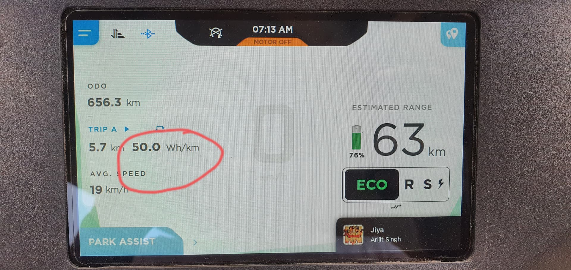

Is it possible to reduce 50wh/km
You have to ride efficiently. Follow the guidelines mentioned in the original post.
Actually to get to the efficiency of 30-35, you don’t need magic. Just slow acceleration is enough.
50 Wh/km is actually too high for any mode. Try to accelerate a little slowly. Instead of going at 40-45 kmph on eco mode, use the sports mode at 40-45 kmph. Avoid sudden acceleration if possible. 30- 35 Wh/km seems to be a decent efficiency number. Go easy on the accelerator, especially on eco mode and you shall do fine. :slight_smile:
