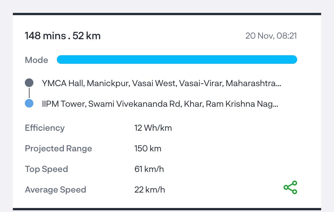

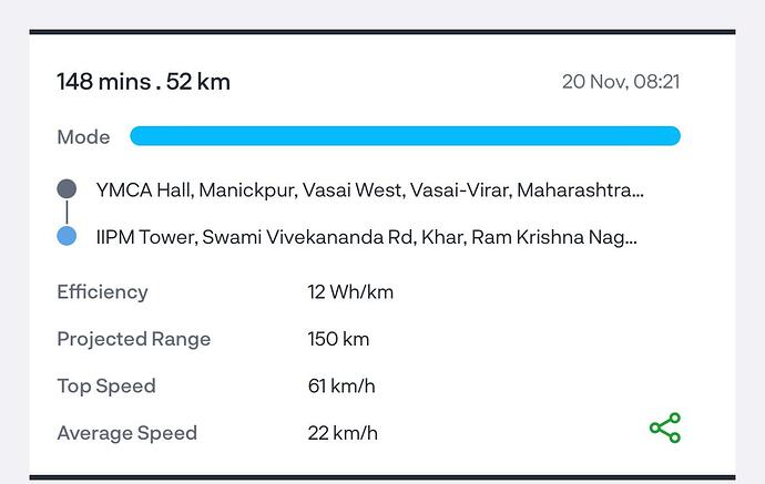

Whoa! Unbelievable! Can you please comment more so that it could be helpful? Might help develop a
wow. This is outstanding. In my case, even if I come down on slope, number is never less than 18. This is long distance 52 kms so surely not fluke. Please share some tips or hacks if you done any :wink:
There was nothing special that I did, the distance and the fact that there was moving traffic and not stop-go traffic helped achieve a steady pace, that top speed was while coming down a flyover, else the speed was between 30-40kmph. All you need is just a steady hand on the throttle.
To sum it up: Have a steady hand on the throttle, dont use the brake while you use the throttle. Ride in a controllable speed. Its as simple as that. :smiley:
What about regen did you use it?
Not sure if regen was there, but I did let go of the throttle while coming down on a flyover
Regen gets activated only after you push the throttle to the opposite side around 5 degrees. so I’m assuming no you didn’t use Regen but even after that an outstanding 12wh/km, my lowest is like some 25. will try your technique and see if it changes …
