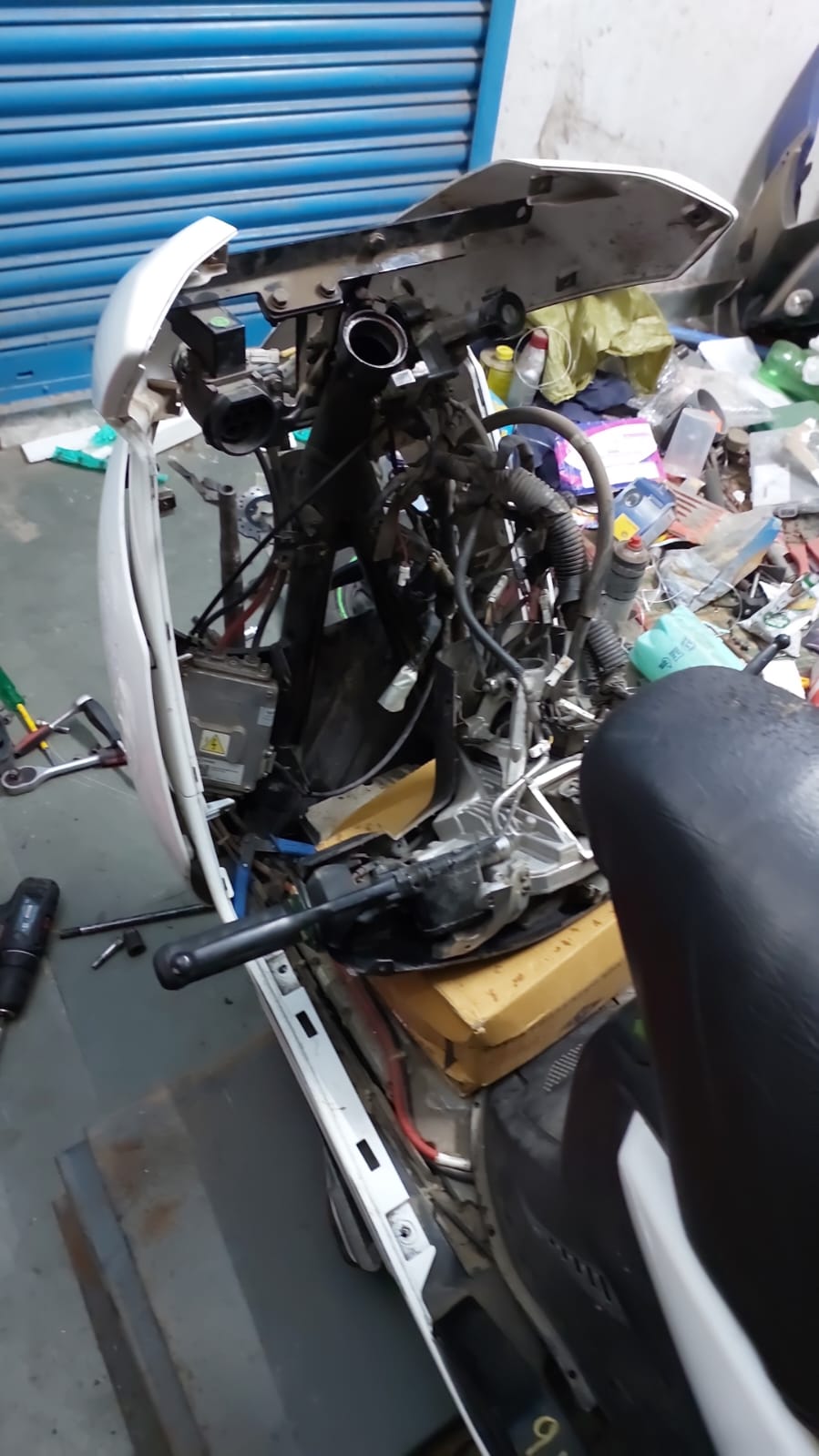

My scooter is dead, well not actually dead, but it has a handlebar locking issue which was sent in for repairs 4 times and looked 2 times at Mchillen ASC for a tyre and thread the issue. Both of them is blaming each other.

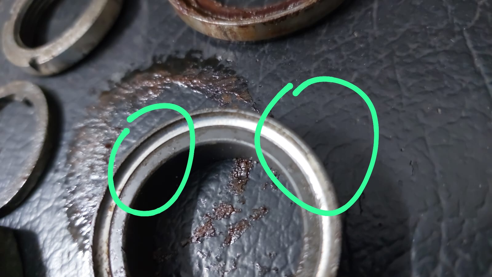

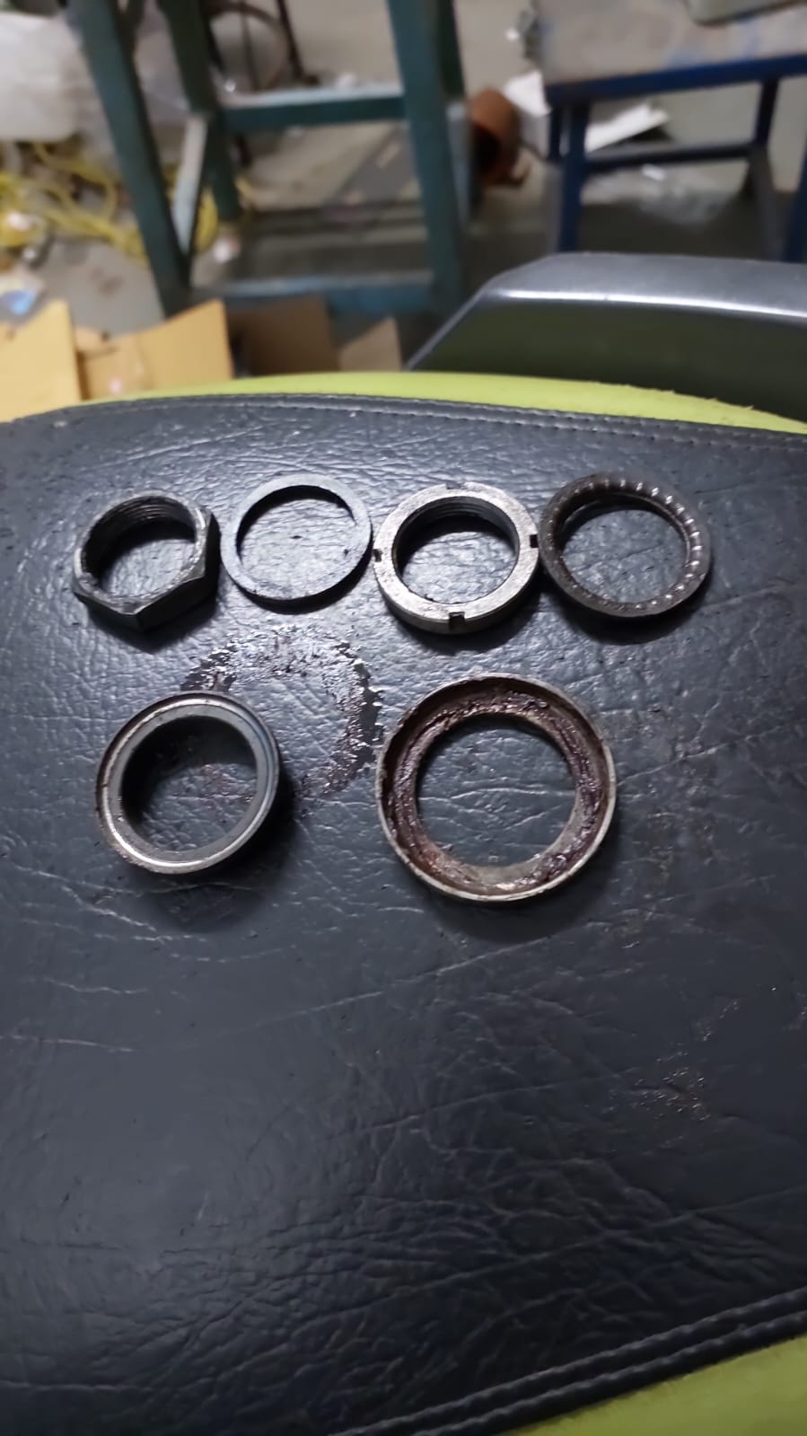

So I have opened up the scooter to find well GROVES in the cone set that’s why it was stuck at some time and gets released.
Well, that’s not the issue, The Nungambakkam ASC and Guidy ASC both will not sell parts to Customers, It’s like a Prison(apple) where once you buy their product and now you won’t even be able to repair your own thing. A simple Cone set of ~500 Rs is all you need, but hey who knows now it just might be a E-waste.
Any owner if you guys ever replaced a cone set do dm me.
New topics coming in as scooter got fixed by the Nungambakkam ASC, Thanks for the team.
Just got to know my Ather is having cone set issue. They are charging 2.5k approximately. Yikes !!! @abhishek.balaji. Is the parts really that costly in the market or you guys making money out of it. Please help, as I don’t have any other place to go.
