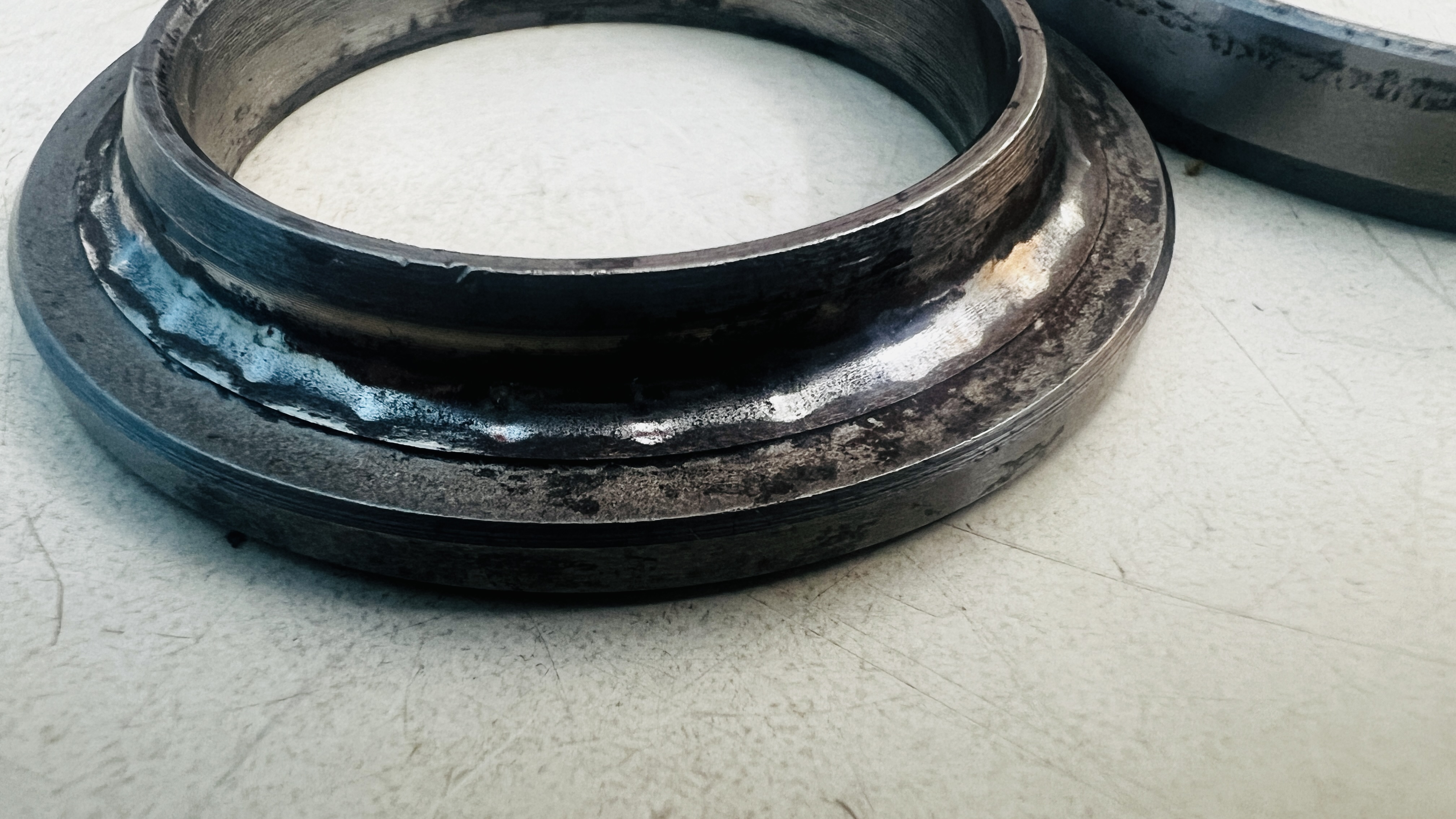

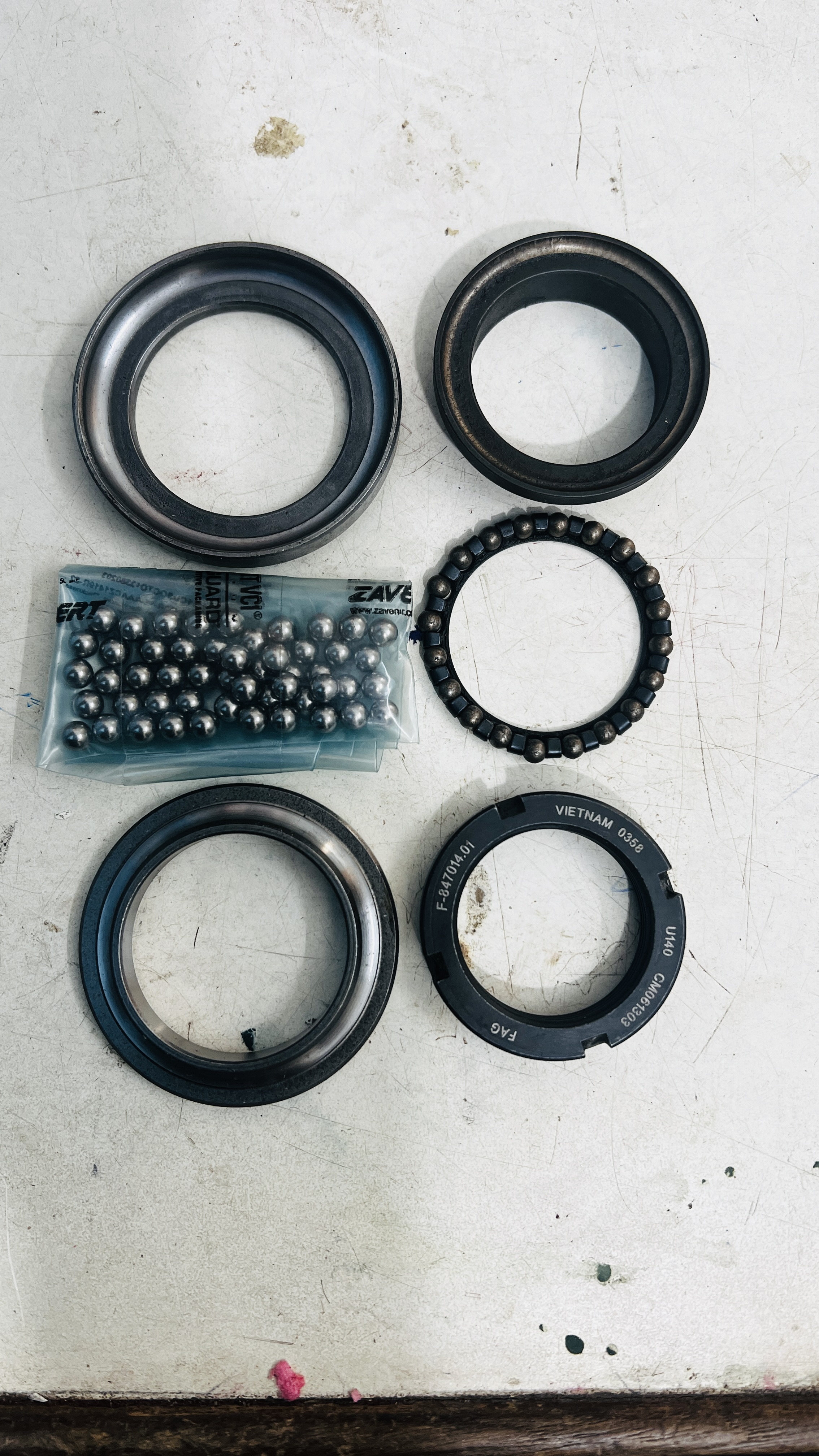

Hi Ather 450x gen 2 cone set is of 2 different manufacturer matching, one bottom match with Suzuki and the Top matches with Vespa, I have recently changed myself and cost around 1500 Rs as I need to buy both manufacturers cone set and use only one side of them, reason i changed was after 34000 km odo in 3 years my handlebar started having shaking and warranty expired and there is no service slots available to quick fix
Which model in Suzuki? and Vespa Classic?
I will upload all details via a video so it’s easily understandable
How to replace Ather cone set
Again. I saw the whole video. You haven’t mentioned the parts from which it was taken.
For top. Which one is it Vespa Classic or some other model? And bottom one which is it? Suzuki Access? Burgman? Motorcycle like Gixxer?
If you could give us just the part number printed on the both the package that will be helpful.
This is for Vispa And Suzuki access new model for bottom

Because of price and labour time i planned to fix myself, it was a good experience and learning, and happiness after fixing all is even more satisfying

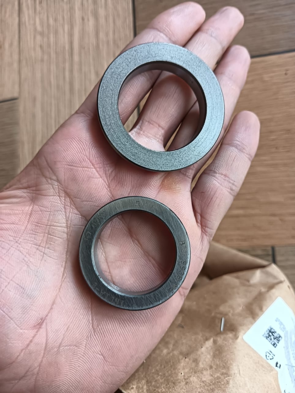

My Ather Gen 2 handlebar started shaking at 13,000 km. I bought the original Ather cone, which cost me around ₹2000 including labor charges. Without labor charges, we can’t buy the original part from the showroom. The actual cost is ₹1259, and the labor charge is approximately ₹650 plus GST.

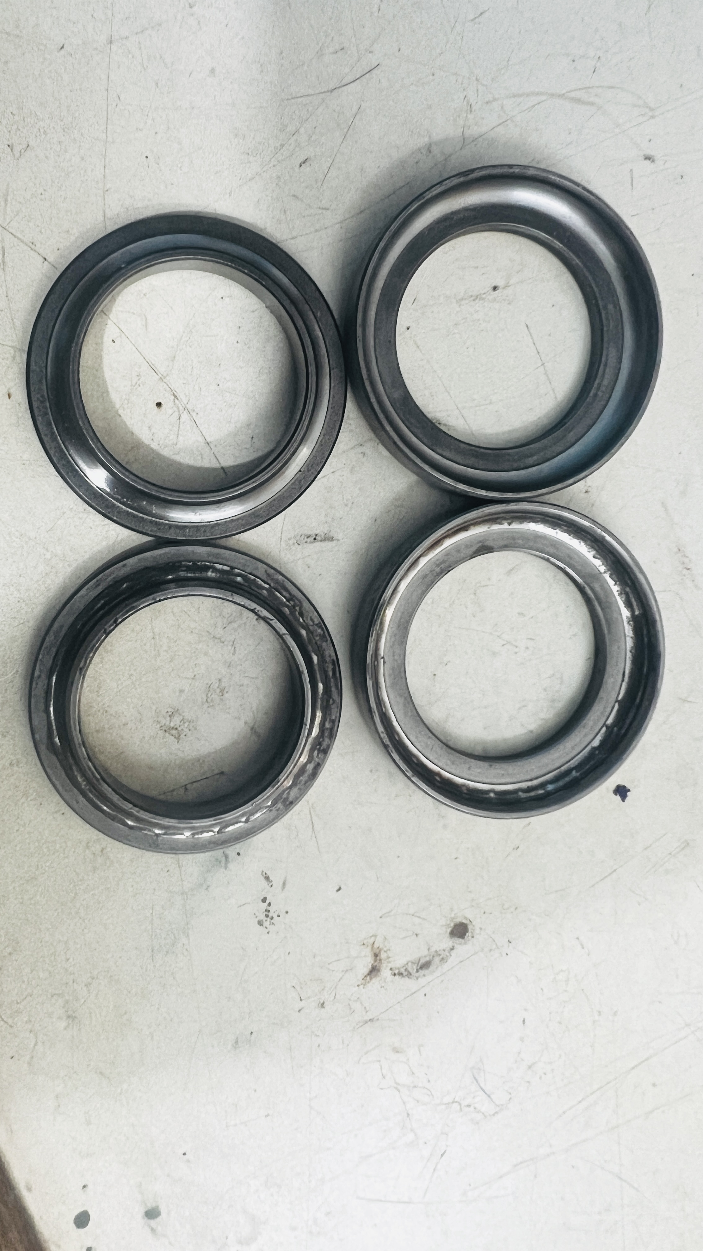

I changed it outside the showroom for some reasons. When I was changing it, the technician told me that the “Access” cone set supports the bottom side and the Vespa cone set supports the upside, so we can use those as well.
I had the same issue. I even told them several times to change the cone set, but they didn’t do it. After that, I paid extra to buy the cone set from somewhere else.i had same issue … even told them several time to change the cone set but they diddnt do after that i paid them extra to buy coneset from somewhere else
