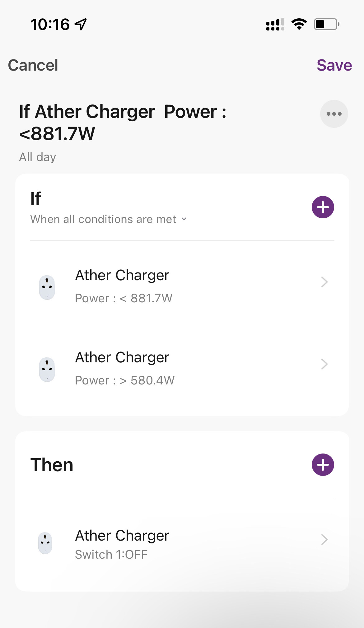

If you’re usage is over 30-40Km a day charge to 100% overnight irrespective of your SOC. If you’re usage is under 30-40Km put it to overnight charging and set up an automation on your smart plug. As mentioned in the first post of this thread. It’s works relatively fine on the Wipro app and smart plug. My mother uses the scooter now everyday for 20-30Km/day and so she plugs it at night. I’ve set a charge start at 4AM and an automation that stops charging when power delivered is <800W so she wakes up usually to a SOC of ~ 86-88% everyday. It makes perfect sense for her usage.

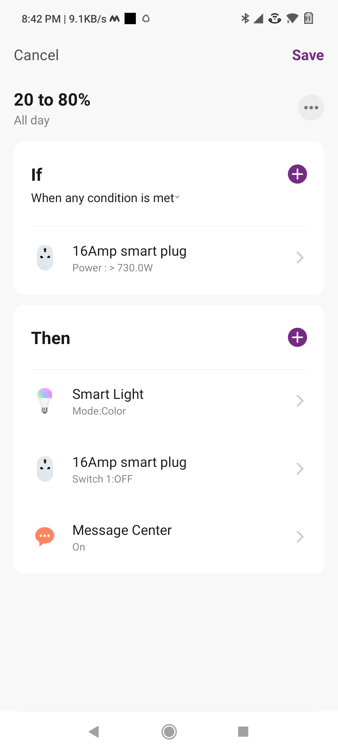

An update on gen3 smart charging
This setup stops at around 80-81% (ignore the smart bulb , just added it for fun, changes colour when reaches 80% charge :stuck_out_tongue:)
