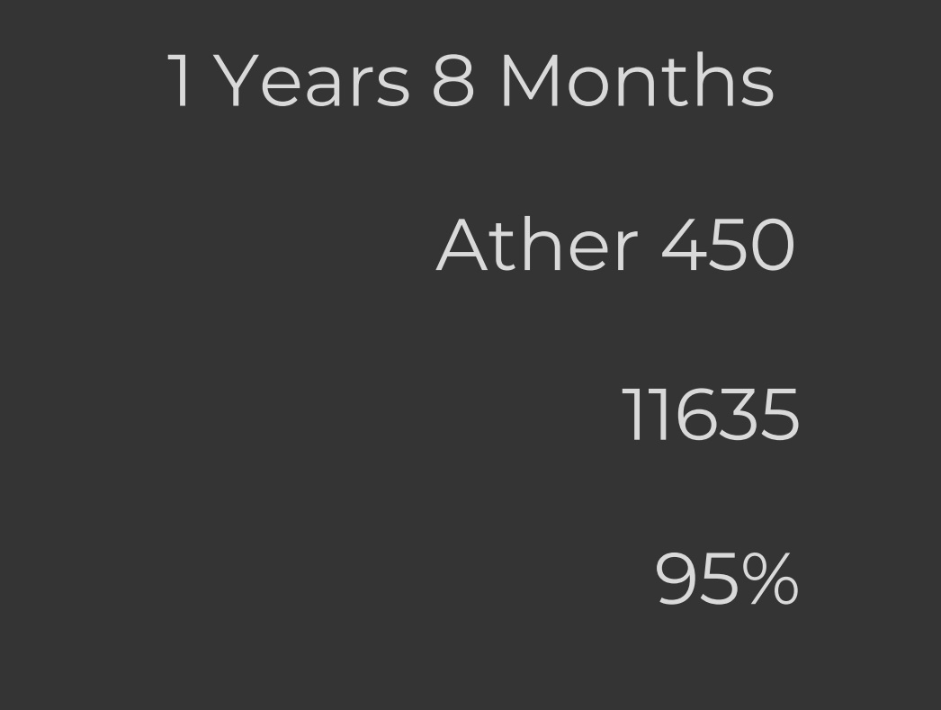

The answer is not a simple yes or no. The truth of the matter is, in 10 yrs we really don’t know the battery will be. Neither does Ather. Or at least they say so. I’m sure Ather has some data on Km aging or aging based on cycles of charge and discharge. But I don’t think they’ll have enough data on ageing of the battery with time. Especially so in your case when you won’t be clocking a lot of Km in the long run. The ODO dependent Battery degradation will not be so high and time dependant degradation will affect you the most. Of all the EVs on fhe market. I truly trust the battery in Ather the most. It’s had its issues but all been more or less resolved. If you really want to use it for 10 yrs. It’s possible since your usage won’t be more than 25-30Km ( you porbably need it for 10Km a day) at the end of 10 yrs you’ll definitely still have enough range to get your through the day, provided you follow a few things.
So as you can see that a fellow owners Ather battery had degraded to 95% after 11k Km. He had not done anything to slow the battery degradation. Absolutely nothing. He used to plug in overnight charging almost every day. So his charging was 70-100 , 60-100, 50-100. And the battery would sit at 100% overnight and stay at w pretty high SOC throughout the day. Those are pretty bad conditions to be In, if youre a lithium ion battery.
If you don’t mind the slight hassle of monitoring charge cycles. Trying to keep the battery at 55% SOC for most of the time it’s idle. The. I truly believe that it can significantly improve your chances of being able to use this scooter for 10 yrs. This is what I think. But I sadly don’t have any proof to back this up. I’ve made a consistent effort of preserving my battery for the past 5k Km of the10k Km I’ve had my scooter. I’ll be doing a degradation test on my scooter soon and I’ll post here about my battery health presently. If it’s still >97% I’ll take that as a sign that my methods of charging have actually affected the degradation. I know of people who have used lead acid batteries for 4-5 years. These should comfortably last you 10 yrs.
