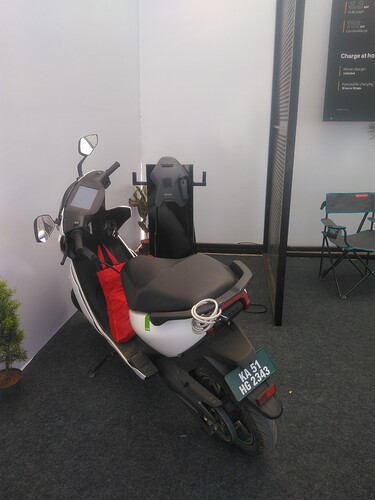

Charging at TATA URS Charging station after discussing with manager.
Blinking red once in a while. Showed C004 error once and re started. Anyway it’s charging now.
Need to charge enough to reach Ather temporary charging
Is the error still persistent? If yes, then only charge till you can reach the Ather’s temporary charging point.
Nope after hard restart it’s charging now…but slow…will charge for 15% and head to Ather charging

Finally
I don’t think I will be able to complete the trip with 1st gen charger…it was showing red in Ather point itself…
