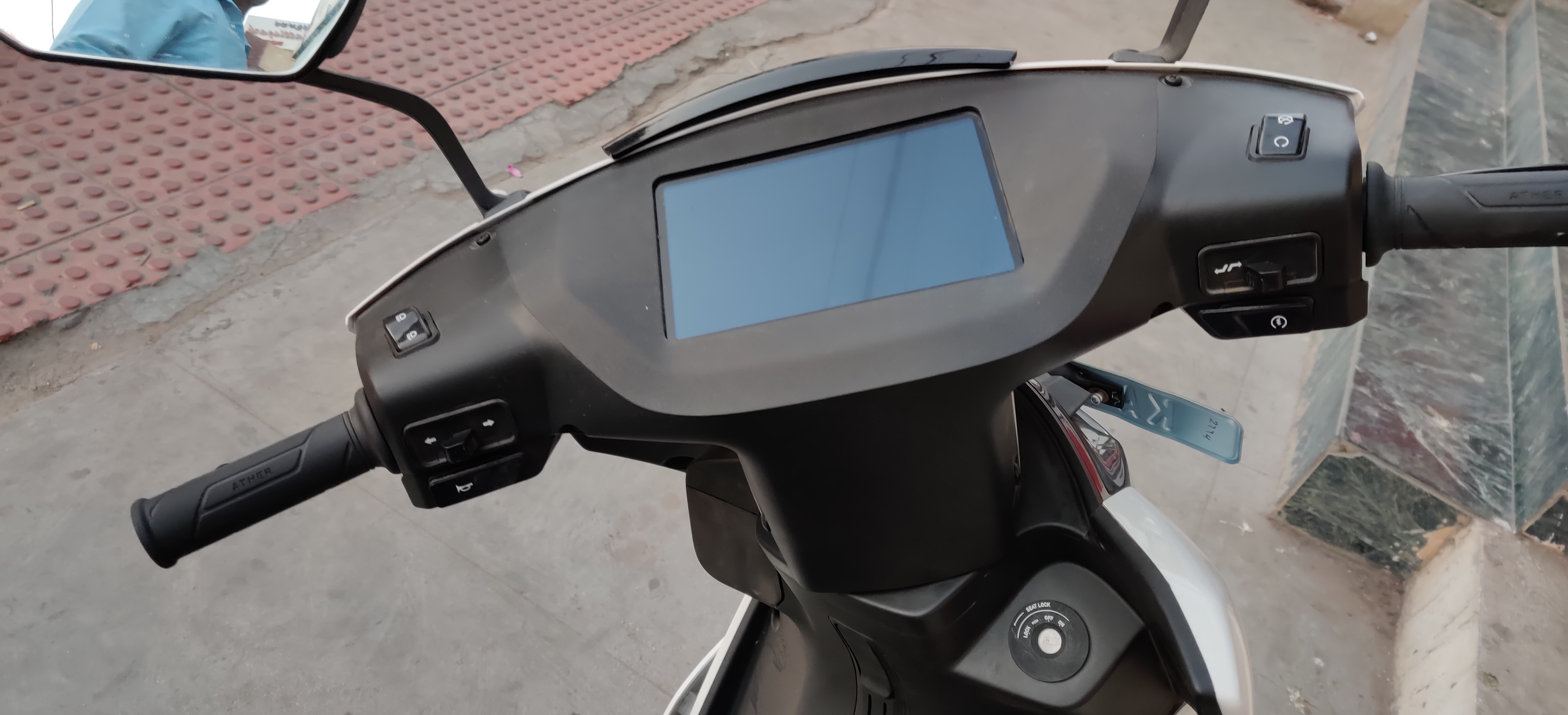

Here you go
My flight too faced same issue…today service team visiting my place…
I faced this issue in the middle of a flyover climbing when ather suddenly lost its power and this this message came Low power mode , I did what was on the screen told me pulled to safety turned off the key waited a few seconds and turned it back on
It worked for me

Some scary experiences here! In comparison, I should say I was lucky. My bike stopped responding when I was at home. Tried all the 'Jugaad’s mentioned here but no-dice. Been chasing CC for the last 3 days for a manual flash - hoping it’ll be done at least today.
My issue with @Ather.Team is something different. I didn’t even try to install the OTA as I was in a hurry to go somewhere. It AUTO-INSTALLED! without my permission!! And it failed and bricked my bike! Now they don’t have remote access to rectify and I have to be at Ather’s mercy to get it up and running!

Facing issue after new update , When switch on key the ignition do not start the motor & screen is blank nothing in display .it happen today 5 times from morning to night
Trying 3 times on/off , still no response ATHER totally dead
I
Then Got the idea press the seat where the lock happens ,
then trying Again the ignition & Ather starts for ride …
After reading above owners are facing lot issue with new update
Leaned Do not switch off the ride in middle of anything jus reach the destination then do anything

Just finished 900 kms , and for the first time , I become a victim of my ather going completely blank , did all the possible things , but couldn’t do anything…My vehicle didn’t start at all…!! Called up the road side assistance, and within 1 HR the bike was towed and taken to service station.
Request the team to kindly get this rectified immediately. I wish I shouldn’t have updated it…I never thought would face such type of problems… Moreover , ather team was very immediate in their response.
To all the fellow owner, don’t update , I guess they have stopped rolling out the update itself. Their is some serious bugg…!! Loss for me is now I don’t have the vehicle with me , and I hope the service guys get this rectified immediately and bring it in a good condition.
