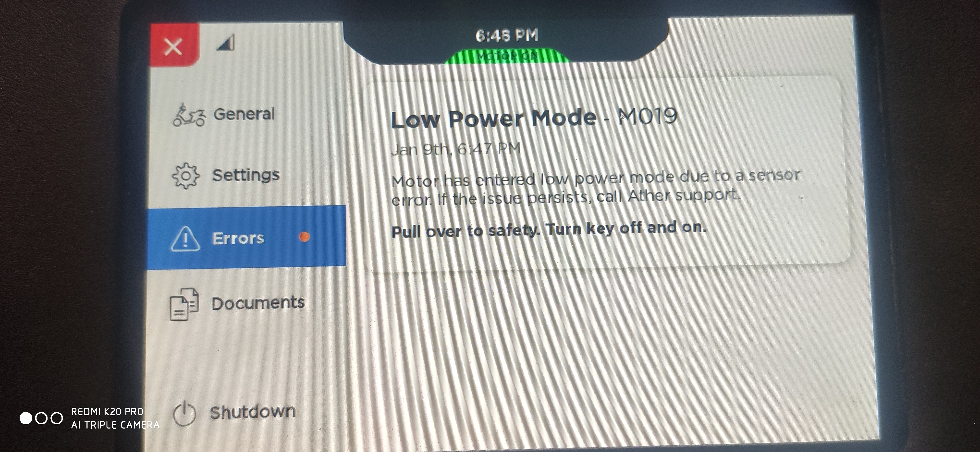

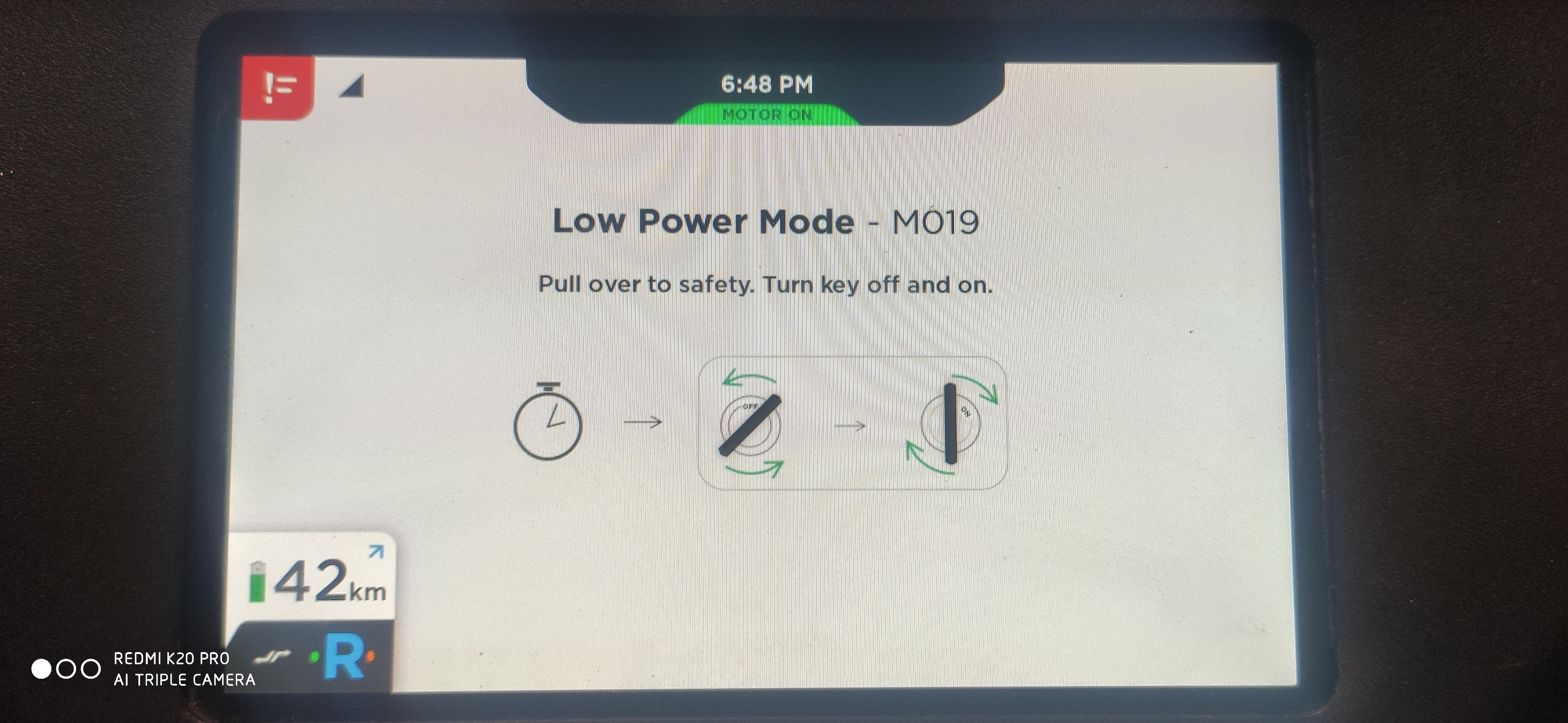

Today happened to me also twice and also got this error message
Ather support team member told their is a service person near my home come from your office. I came home now they have not called and not picking the call. This is a smart way of service as I am also at home so… I need to follow up tomorrow again. @Ather.Team this is my 4 bad experience in 1 month.
