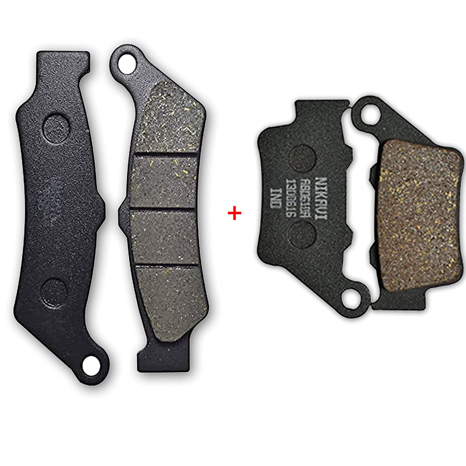

Can anybody let me know the break pads compatible with Ather ?
But what about its quality and how much it will last who knows

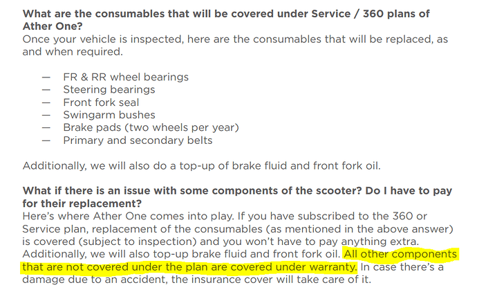

@power_light2000 What about this ? It says other components that are not covered under service plan are covered under warranty.
That statement is clear as spring water, what doubt you got, “All other components that are not covered under the plan, are covered under warranty”. This means that every electronics, brake callipers, display and battery will get a warranty of 3 years; if they fail on their own in this timeline they will get replaced.

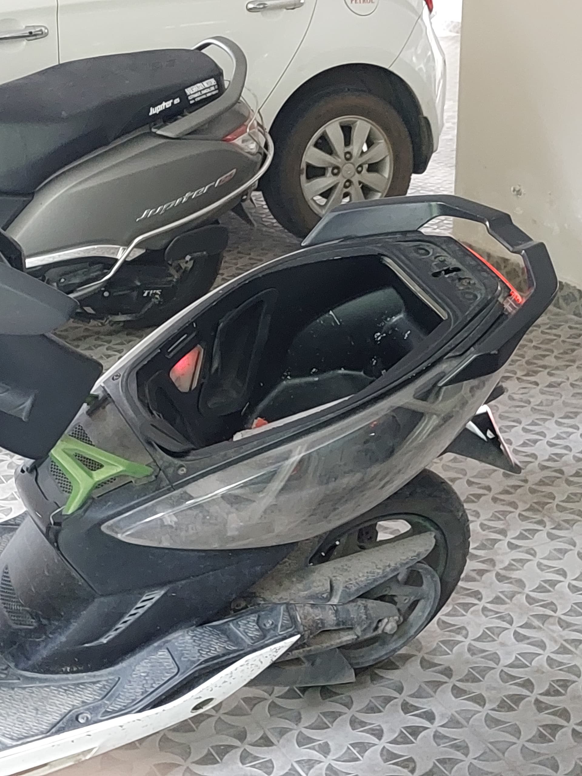

Surprisingly yesterday I got a call from Ather saying you have crossed 4000 km so we will send a technician to inspect your belt if it is loose and tighten it free of cost . the guy came today morning and checked and it was a little loose and after tightening and checking it he left . was surprised as I had not even called them once saying anything regarding the belt :sweat_smile: but still it was a good experience just wanted to share it.
ps. on a side note the technicians scooter had full scratched up broken down look but he had completely transparent panels on the side .
have never seen this panel before …

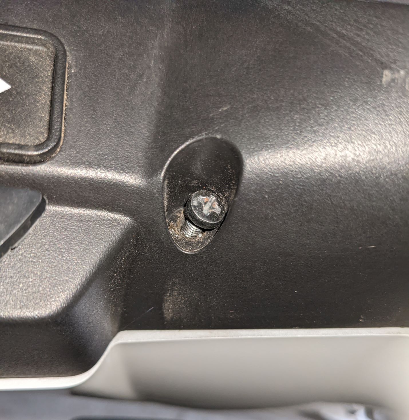

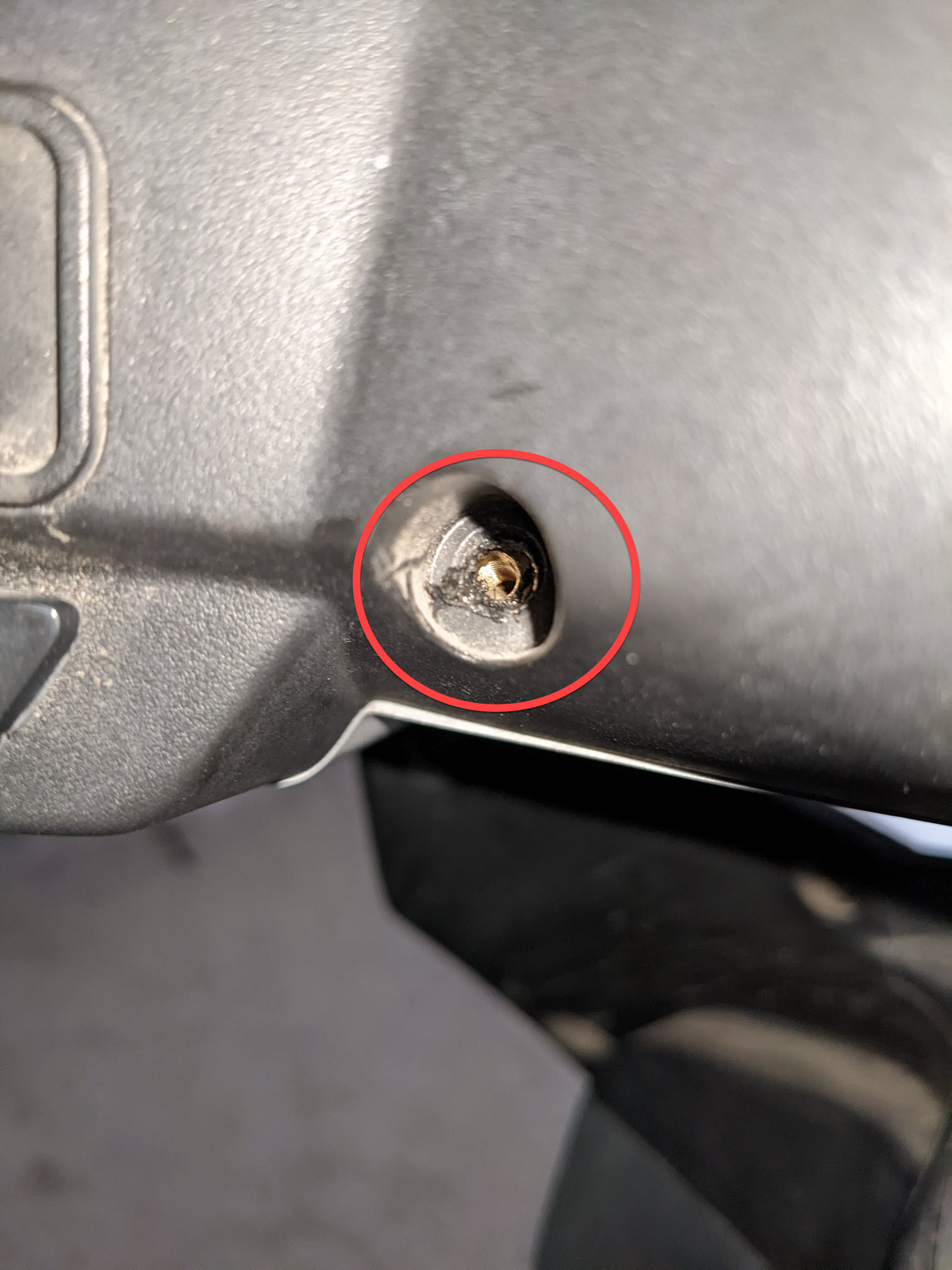

The problems started in Feb 2022 when I raised the request to get the 2G module replaced by 4G. The technician who was sent seem to be untrained and in the process of fitting back the cowl cover, he ended up stripping the thread due to which he was unable to fit the screw. The issue was mailed to Ather.

Screw not installed correctly.

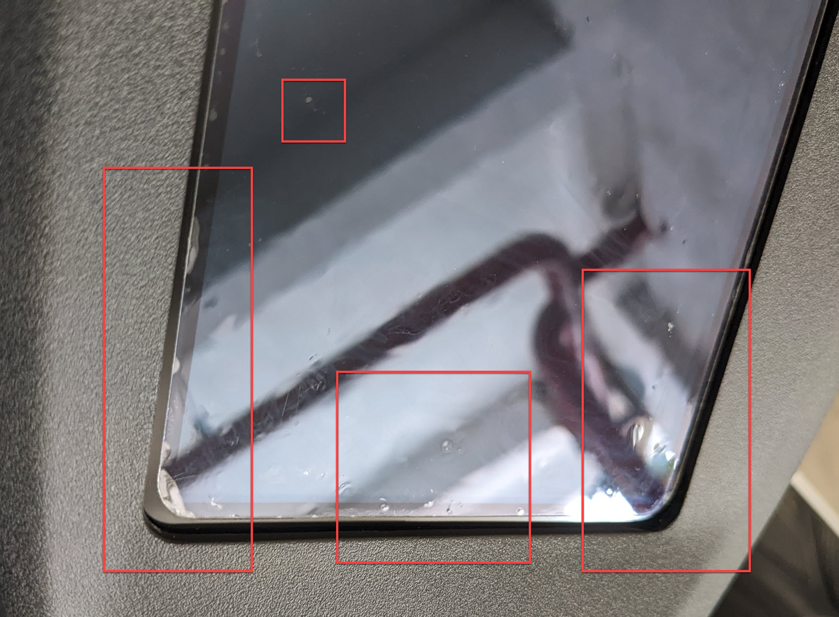

  2. For applying the screen guard, the technician did not have the required tools to apply the screen guard. I had to provide the isopropyl alcohol and cloth to clean the screen. The screen guard was applied so poorly with air bubbles and gaps that I am sure it will fall off in some time.

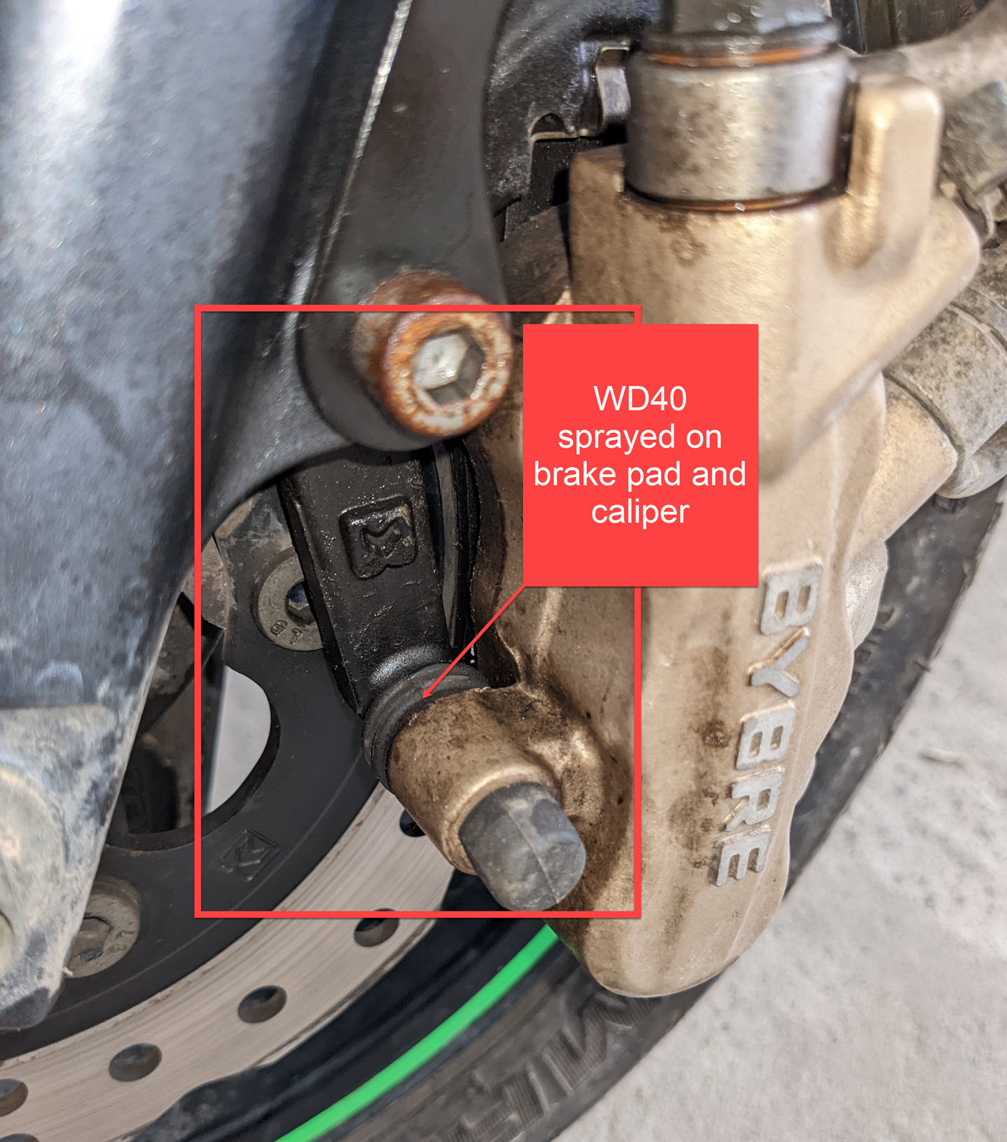

  1. For the brake disc heating issue even when not applying the brake, the technician did not diagnose the issue properly and was not even ready to listen to me trying to explain what was the issue. He sprayed WD40 on to the calipers and also spilled it on to the brake pads. The front brake is performing poorly after soaking up WD40 and I am unable to use my scooter now. He did not carry any brake cleaner spray and hence is unable to get rid of the oil on the brake pad and disc. Now he says that the vehicle needs to be picked up and taken to the service center. He was unable to remove the caliper for cleaning as well since all he had was a T-Handle allen key using which he could not apply enough torque on the bolts. I am not sure how such basic things as not to get oil on brake pads are missed by the Ather service engineers. I am also not sure on how the pickup would be done since it’s risky to take the scooter on road with a non-functioning front brake. I hope Ather is ready to cover the risks here.
