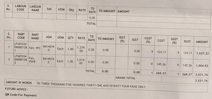

Ok. So I had similar issue. My 450 stopped charging last Tuesday evening and would throw C014 & C036 errors - both relating to the onboard charger. I’ve seen this before and the issue was with the cooling fan on the onboard charger not working properly.
After having seen your post earlier I was a little concerned that I might have to either spend ₹32,000 and replace the onboard charger or spend ₹10,000 and buy a Portable DC charger (Gen1.5). The service team picked up the scooter last Friday and, to my relief, called me on Saturday to confirm that the 2 fans on the onboard charger needed to be replaced and it would cost around ₹3500.
Both fans were replaced and the total invoice was ₹3532 (on Service Pro, so no labor or pickup/drop charges). The older parts were returned back to me.
thank goodness only the fans failed, Looks like a lot of GEN-1 owners will share their after warranty services provided by Ather. Let’s see how the ends get tied up.
