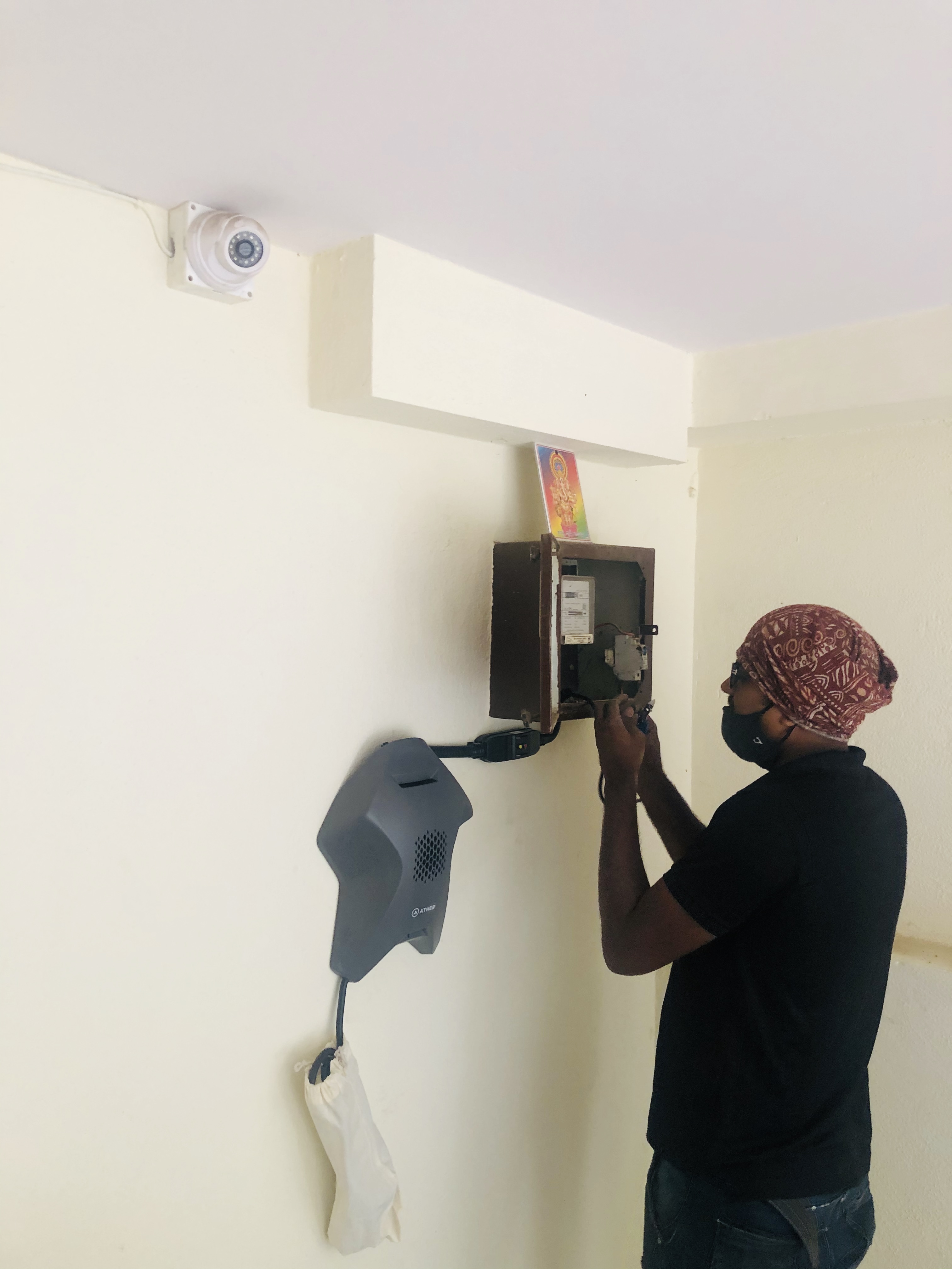

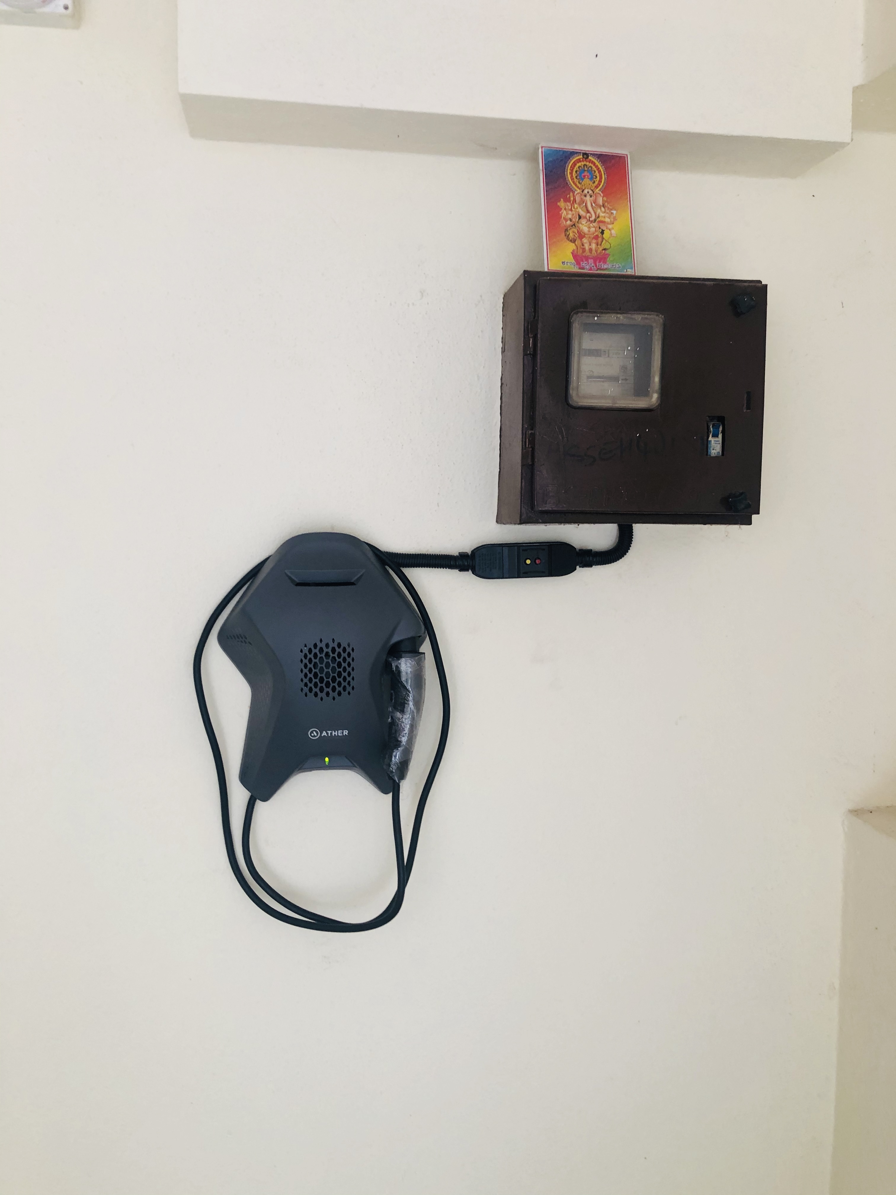

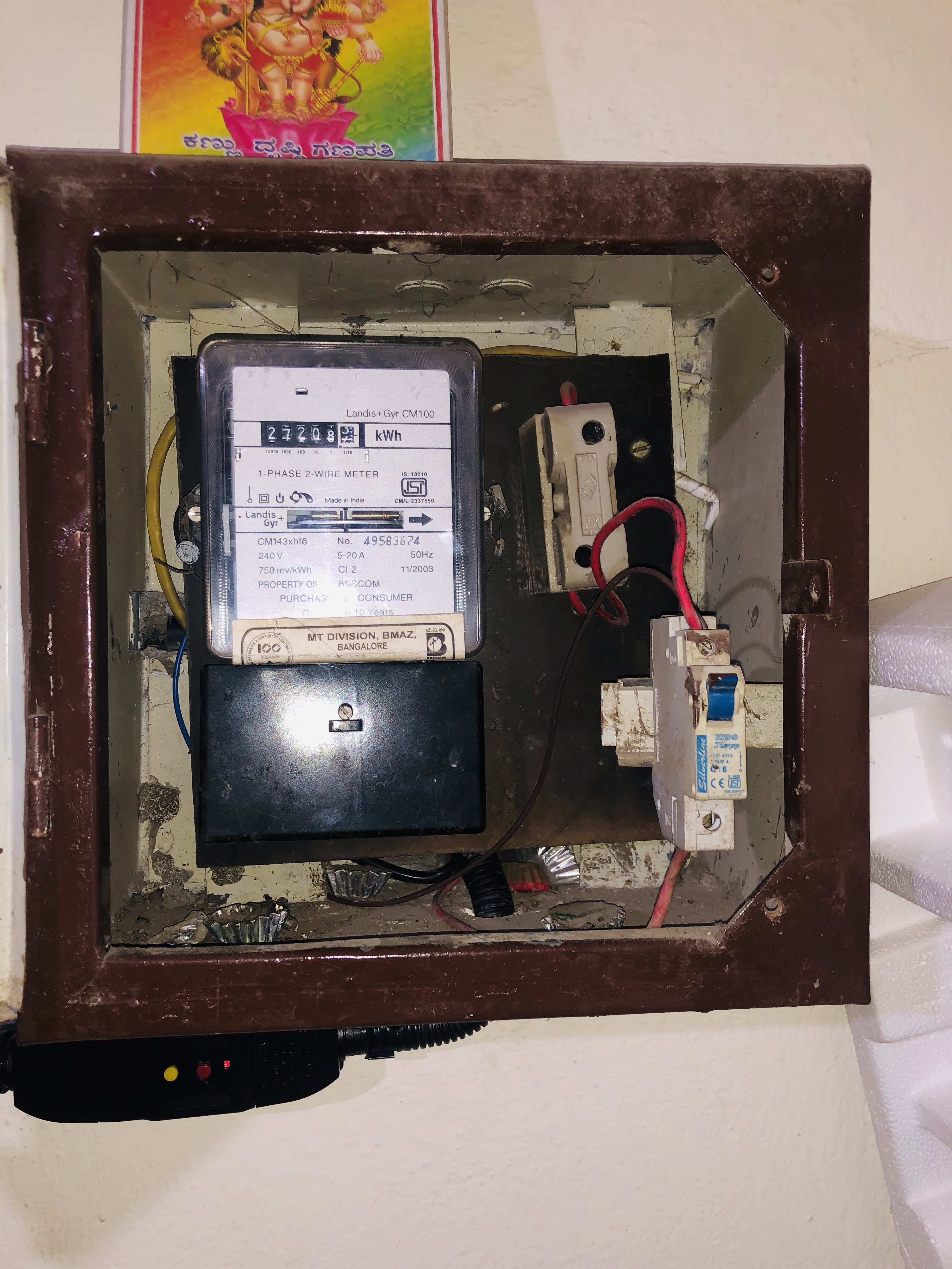

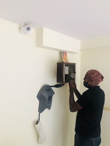

Wanted to get clarified about this with other owners. Ather dot was installed on Tuesday and technician said BESCOM will not object not to worry, the same was expressed by local electrician. Now one of the BESCOM engineer called me and said we cannot put a line in the main line/board as it may become tampering of the metre. Please guide me, I have attached some pictures for your reference.
This is my setup since March 2019 and not once has the BESCOM meter readers even bothered asking what that Green and Yellow wires are for.
Only if you tap a wire from the meter itself would it be tampering. Any tap done after the meter is not a problem.
Can you share the complete photo if possible, from where the wires have been connected, is it coming from behind the metre like mine ??

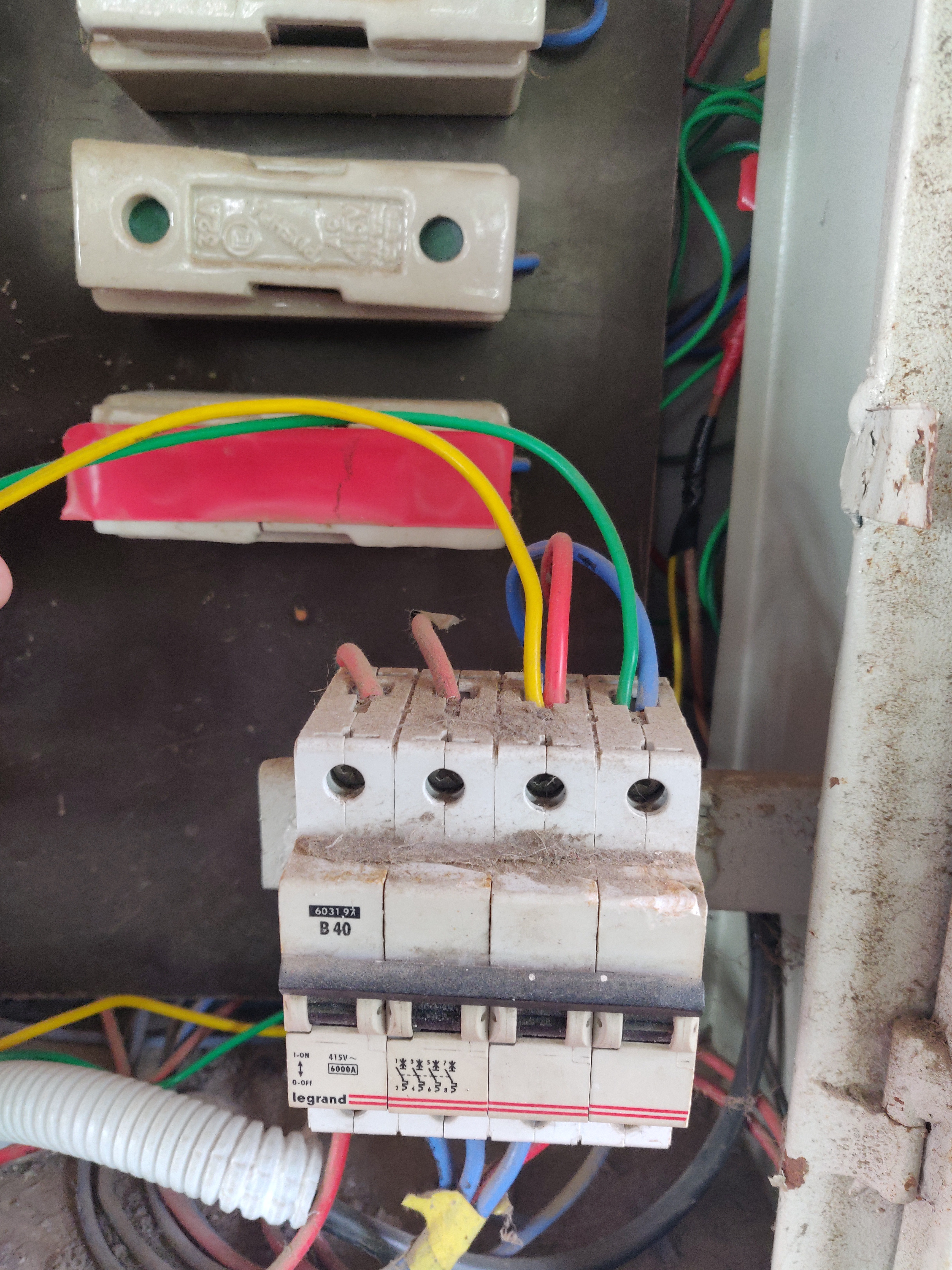

I need to know dot installation process in case buildings/societies where all meters are situated in a meter/electrical room. How to draw wire from our meter in meter room upto the parking space? If anyone has done this, pls send some pictures too.
Here you go.
The wires are tapped from the output of my main MCB (after the meter) and routed via a PVC duct from underneath the meter box.
In fact you can see the WiFi switch too that sits on the left side of the box (first photo).
Thank you so much !!
Would be nice if anyone can share any information on such type of installation. I would have a similar issue.
