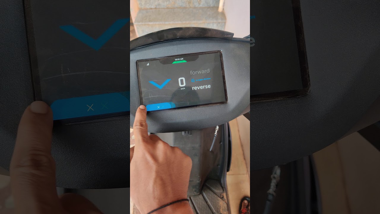

The new update brought a new bug, I don’t know if it’s the same with others. When I accelerate and stop the dashboard automatically goes to maps, this happens repeatedly and every single time. I have to ride with maps on even though I don’t need it on the screen. Please help.
Can you share an image or a video of this happening? Please record only when it’s safe to do so. Would like to understand the exact issue.
Here is a link to my video that I just uploaded to YouTube because I can’t sent it here, please do have a look.
Thanks for taking the time! Have reported this to the team.

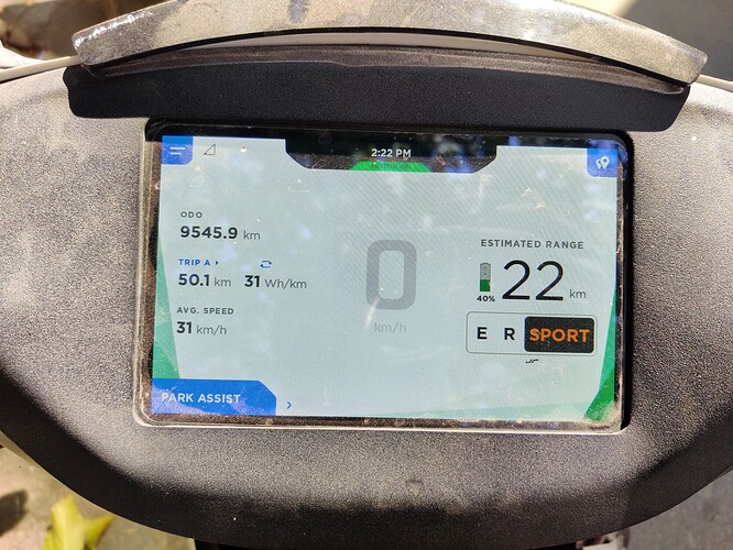

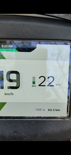

Hey @abhishek.balaji just noticed a small bug in the ather 450 dash or maybe that’s how it’s designed I took a photo of the dash, thankfully so I can actually show you proof of it happening.

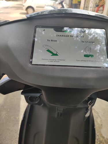

This image is at 2:22 as you can see my ODO is at 9545.9 Km and trip A at 50.1 Km Another image at 2:23PM with Trip A at 50.3 Km I was regenerating down a slope and the screen froze. I tried a normal key off and everything. Didn’t work. So did a hard reset and it worked but after the reset this was the reading on my dash this is at 2:25PM looks like with the reset my dashboard forgot the last 5 minutes worth of ride. My ODO actually decreased to 9545.8 Km. I’m assuming this is how the dash is designed. This post is just in case it wasn’t.Idk why all of the sudden it detected changer and asking me to switch of the Scotter. Probably it might be a bug.
The wireless charger might have become active!
Lol…charging on the Go!
lets bring that person forward who once asked for wireless charging as a feature. Man you got your request implemented. Haha
Today morning, I charged my 450 up to 80% and switched off power supply using the MCB in my flat on the second floor. This is how I do always. This MCB powers up the Dot in the parking slot. As I neared the scooter, I found that that the display was on and status being shown was “Charging 80%”. I double checked if the Dot was on by any chance. It wasn’t. Appears to be a malfunction or a bug. Ather, please check. Thanks…

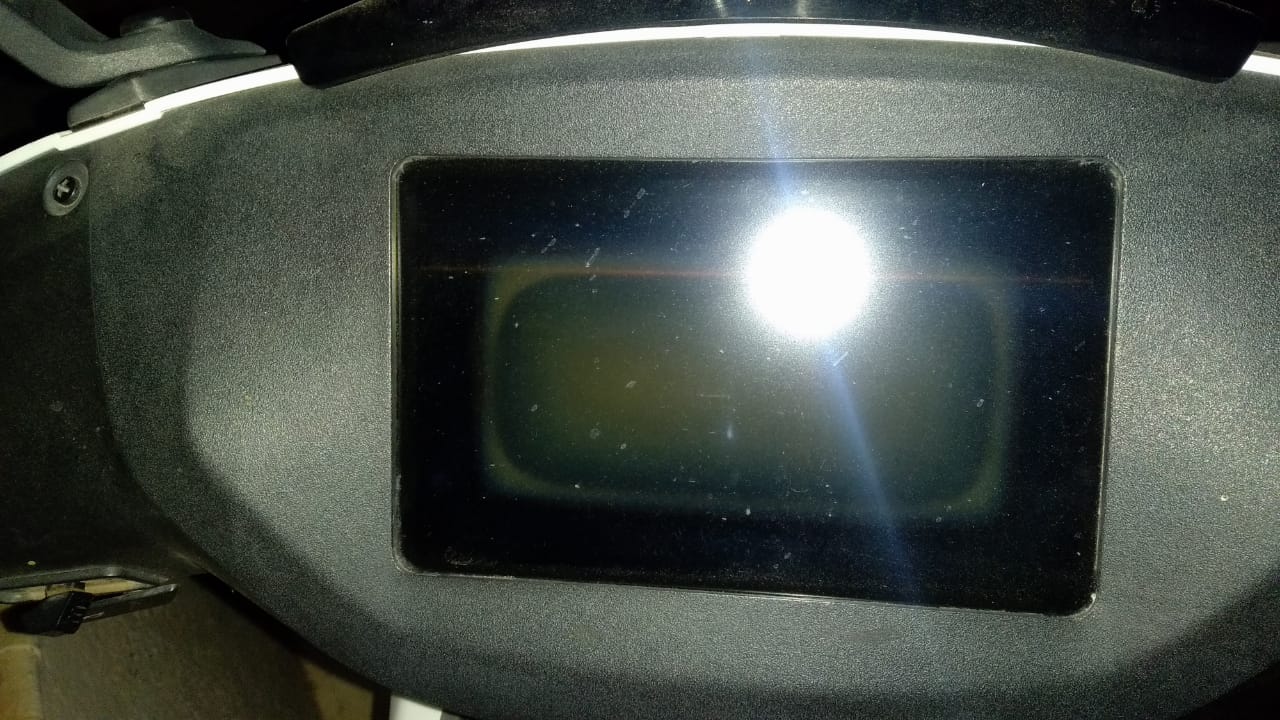

Hi @abhishek.balaji I have sent email related to screen turning yellow and burn in a square shape. The reference number for this thread for future reference is 117127 is the email response I have got. When can I have this rectified.
Im sure im not the only one here having this issue. Scooter is mostly in the shade and never in direct Sun exposoture. Let me know how to get this rectified.There were a large number of 450s with defective screens that would end up like this - including the one on my old 450. They should not deteriorate even under direct sunlight and sustained rain. They qualify for warranty replacement.
Yes and all of them got a UV protection 3M film on it. I have one on mine and I park in sunlight a bit and nothijjg has happened to my dash.
