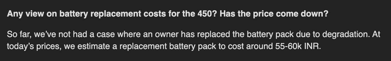

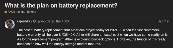

On multiple discussions over last 3 years, the battery replacement cost was projected to be around 30k - 35k. I was surprised to see Ather has revised its estimate to 55k - 60k.
  • Is the battery cost on actuals turned out much different than the earlier projections? Or
  • Is it because of new battery cells being used in 450X is costly? Or
  • Being defensive in projection to avoid a backlash later?
I understand that the projection is always approximate, but revision of the projection from 35k to 60k is almost double.
A post from Ather on 2018:
FAQ compilation based on discussions:
Even during 450X launch, i remember the current battery cost was mentioned around 60k and expected to come down to 40k at the time of replacement.
I think Ather themselves will remember this and there should have been a valid reason for this change. @abhishek.balaji Would like to know the reason from you.
Yeah, projections from previous years, 450 vs 450X costs are all different numbers. Let me find out the details and get back on this.
I have a feeling that the battery costs for replacement are increased to 55-60K to justify the 450x price increase. Ather’s fixed costs are much higher and their volumes are very low. Margins on 450x must be much higher to cover the fixed costs and turn the company into a cashflow positive overall. There may be pressure from investors lead to this change from 450 to 450x.
