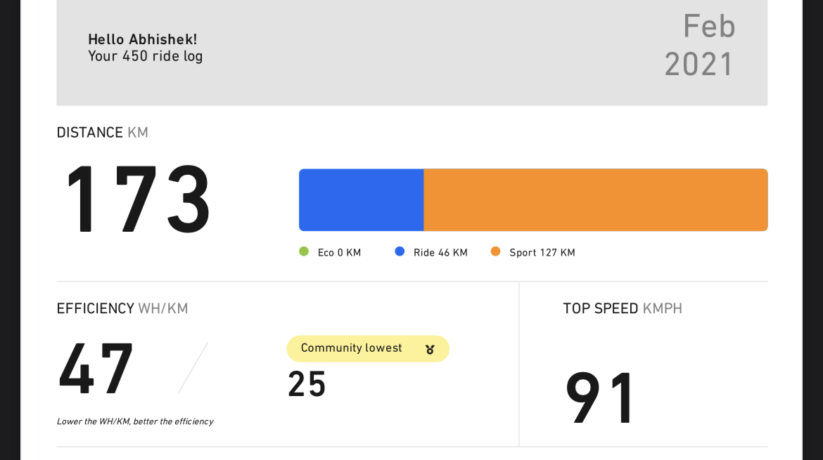

  • I don’t have a smart plug etc, and my scooter is often plugged in for days a time when not using it.
  • not an easy rider. My ride efficiency averages around 36wh/km and very often is 44-50Wh/km.
But not an avid user of fast charging, maybe once a month or so.

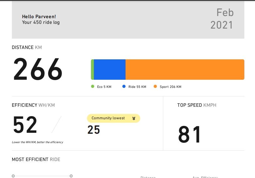

Welcome to the 50Wh/km club, man I was waiting all alone in here :stuck_out_tongue:
52 is my best umm also the worst according to Ather

Oh I remeber this phase. It happens when your commute per day is under 15Km it’s a coping mechanism we Ather owners use when we don’t need the range. To pin the throttle every chance we get :stuck_out_tongue: that was me in lockdown. Every grocery shopping ride - 50-55Wh/Km.

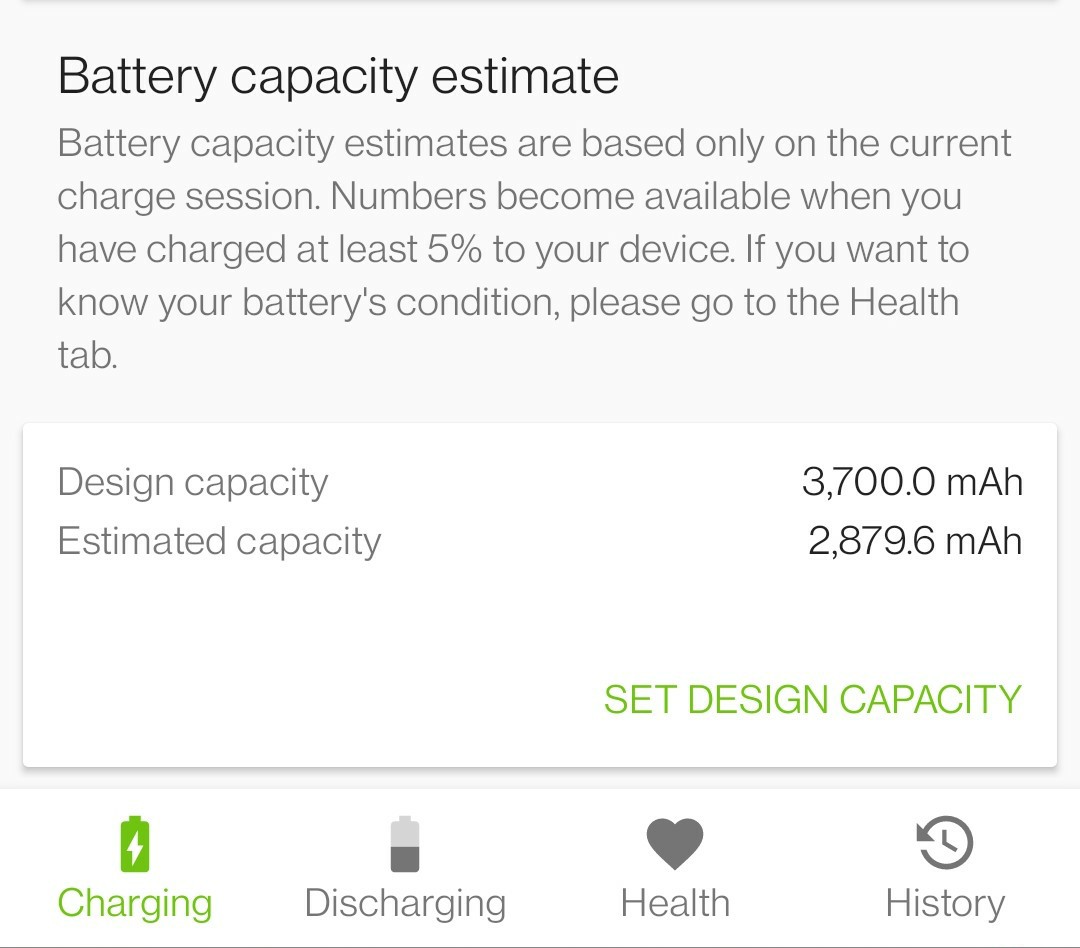

So you don’t actually know your battery health either? Could someone share how hard it really is to estimate the battery health of a battery. Because on android there are just so many apps that can do this after a few charge cycles.
What happens if you offload these apps on the 450X dash? @abhishek.balaji @cyberboysumanjay ?
Don’t have anything to share right now but should have a clearer picture in the next couple months.
