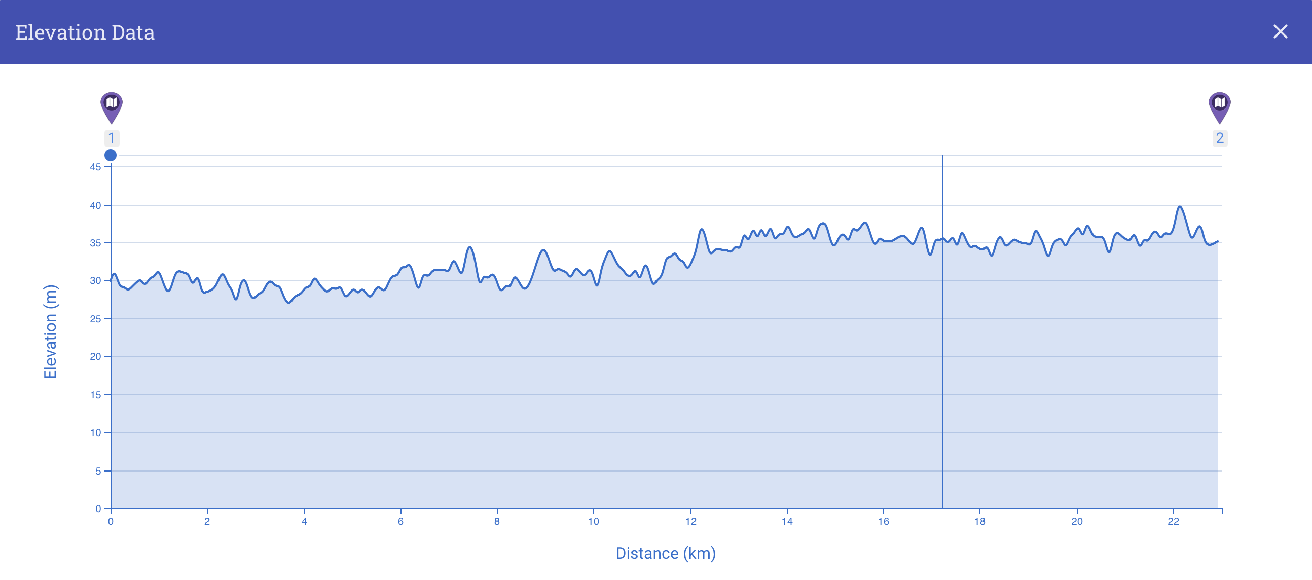

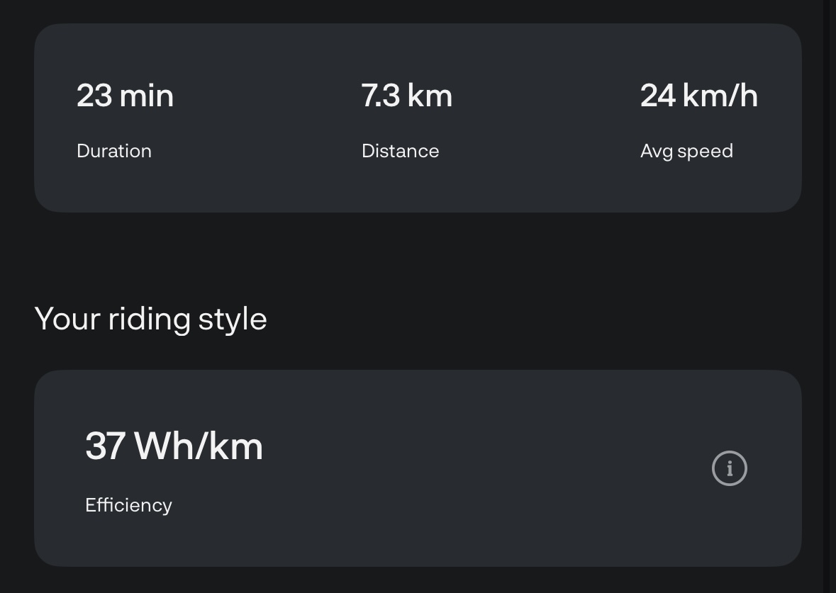

Today I thought to test the battery degradation with two continuous rides after charging to 100%. Will add screenshots from the Ather app at the bottom for reference.
Ride 1 Distance - 36.4 km Efficiency - 41 Wh/km
Ride 2 Distance - 7.3 km Efficiency - 37 Wh/km
The average efficiency for the total ride of 43.7 km is ~ 40.3 Wh/km
The total battery energy consumed for 43.7 km is ~ 1.76 kWh
Elevation is negligible in this test and weather is around 28 degrees Celsius.
Battery percentage came to 1% after the above two rides. Since the battery degradation of my Series 1 is above 70%, will go for the claim. :slight_smile:

How did you conclude that the battery degradation is below 70%?
Was the battery drained to 0% after completing those two rides? In that case it is 1.76/2.9=61%?
Forgot to mention, battery percentage came to 1% after those two rides.

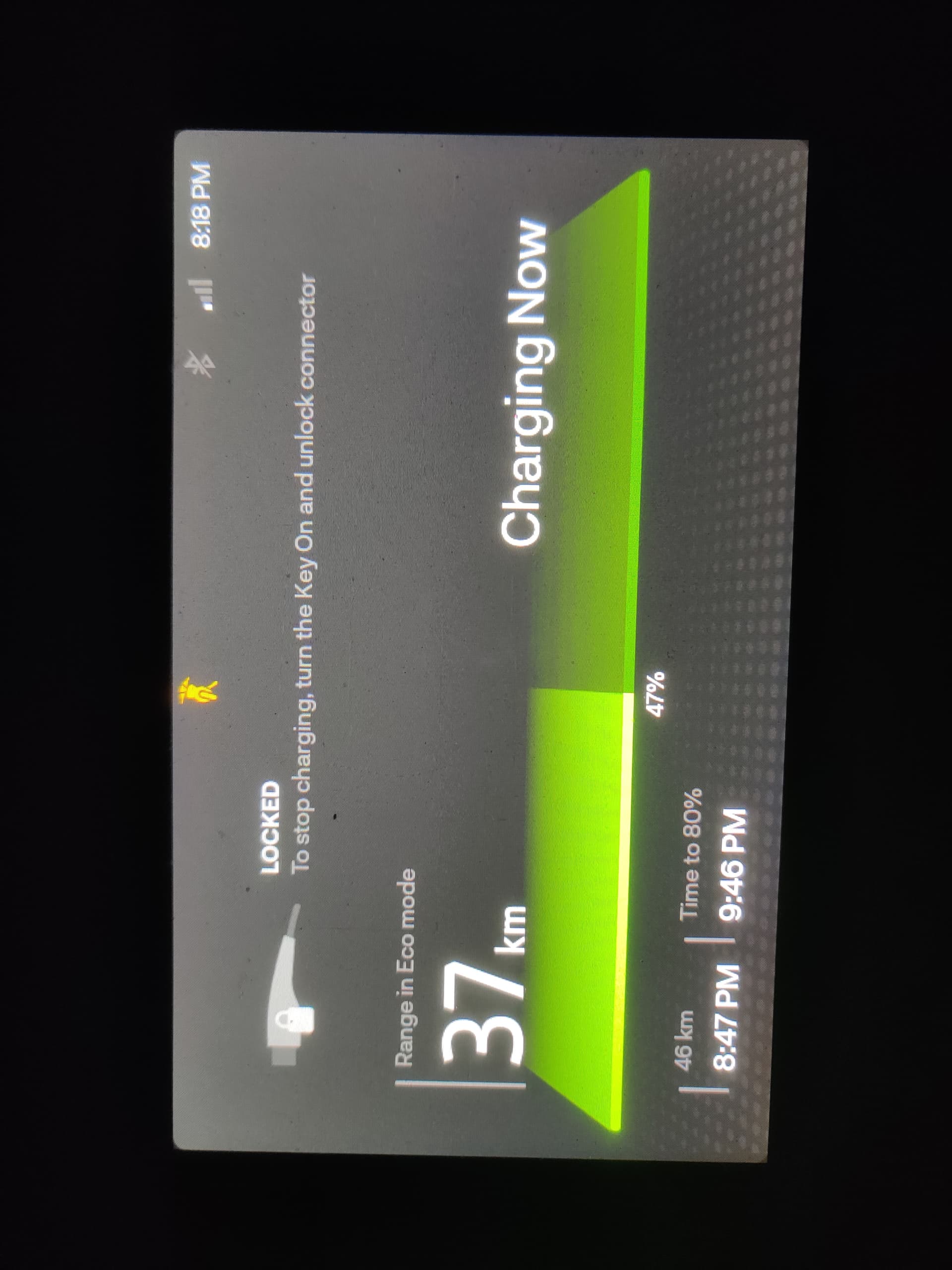

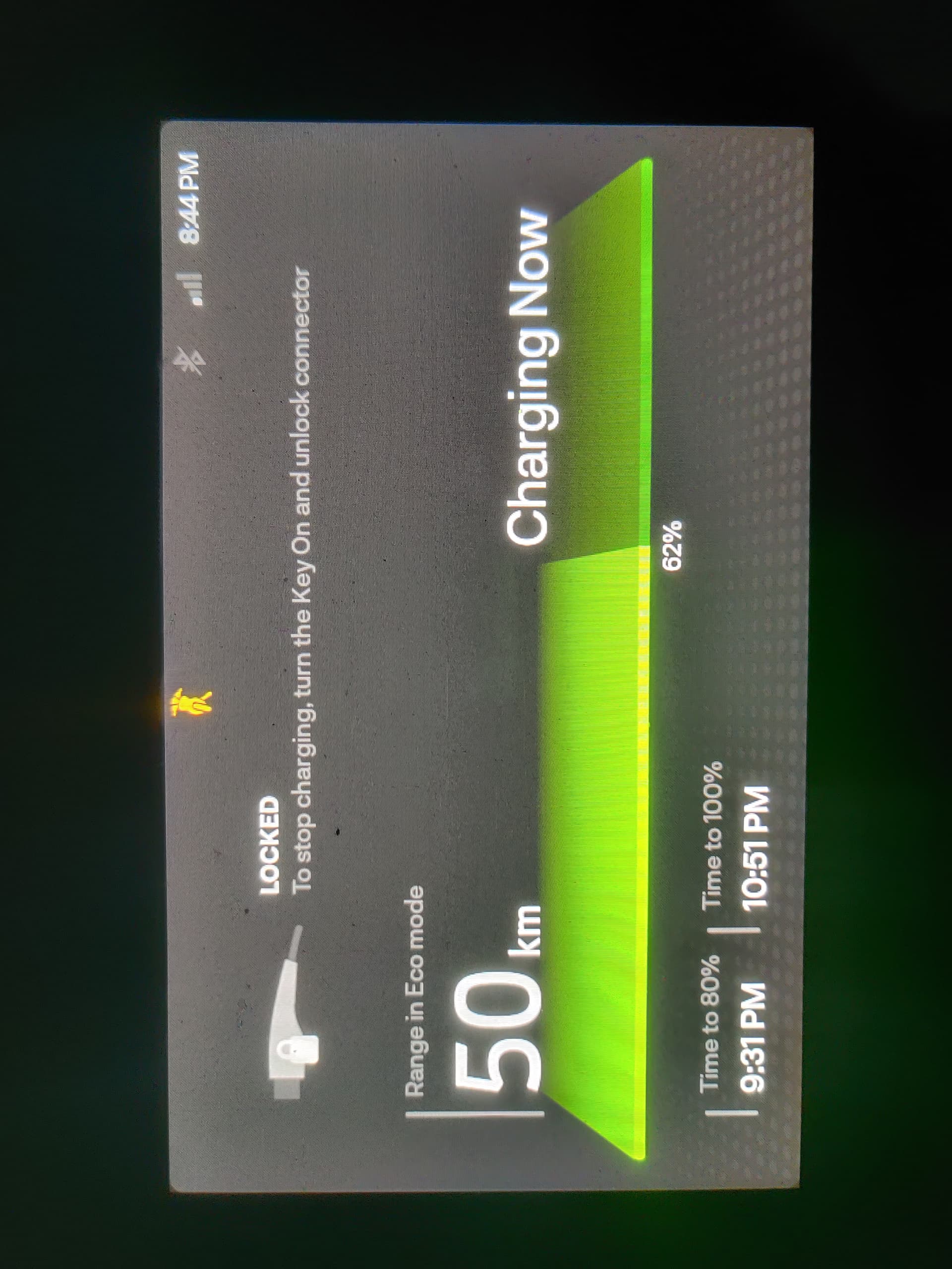

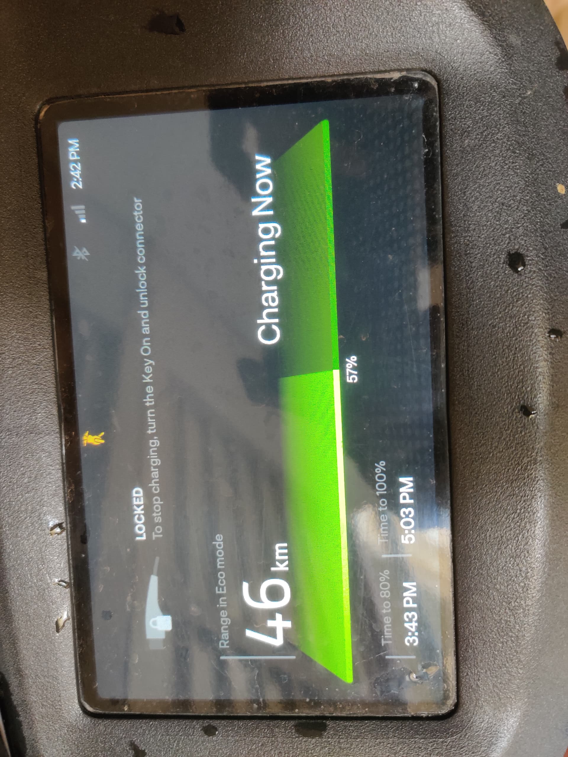

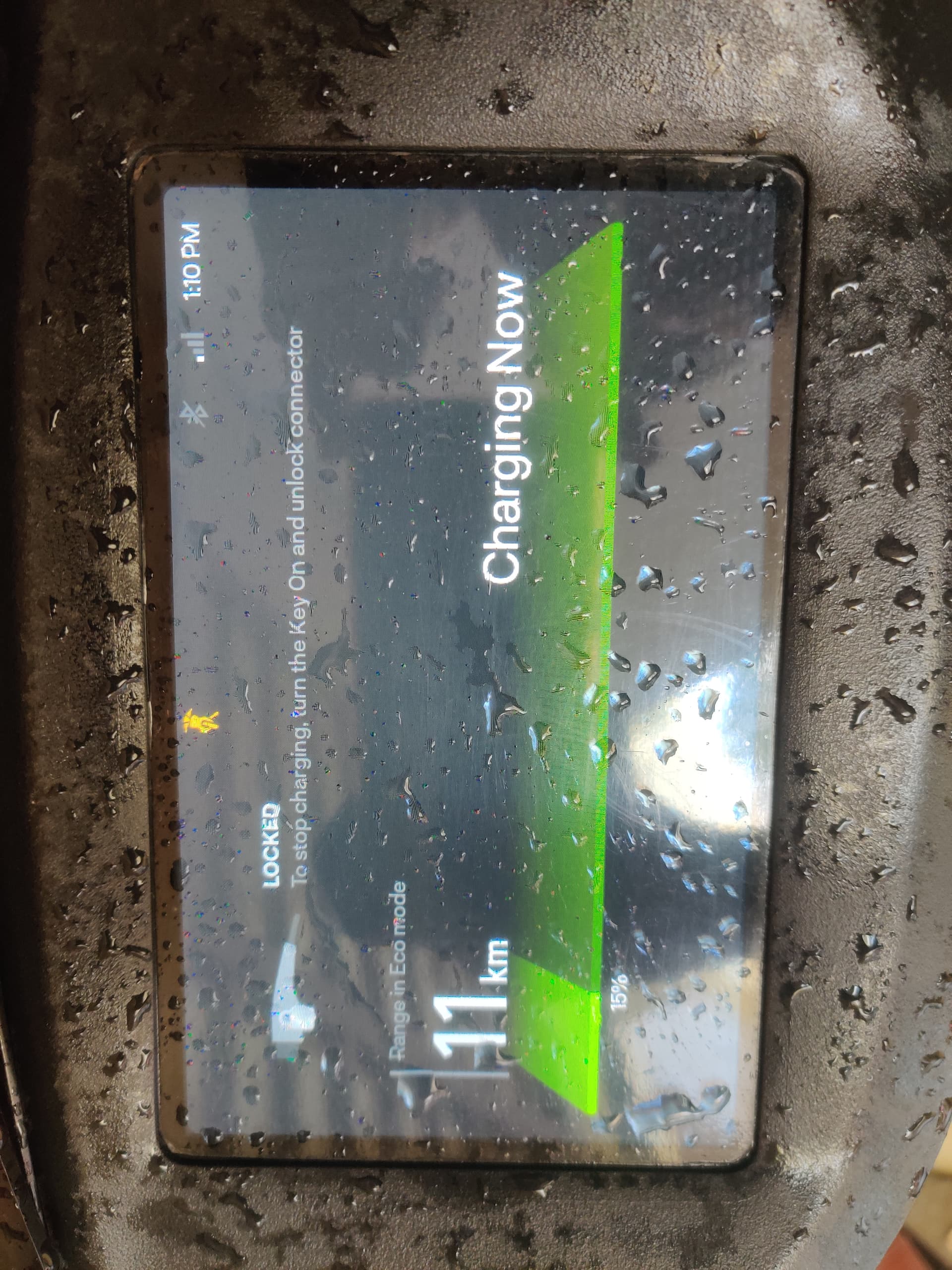

Hello guys, I’m facing this new issue where the battery charges much more in certain amount of time than normal.
Mine is a 2nd gen Ather, it used to charge 1% for 2.5 min all these years. now its charging around 15% in 26 mins instead of around 10% as seen in the first set of images. around 42% in 1hr, 32mins instead of around ~37% as seen in the second set of images.
and yes,
  1. I have fully charged the battery overnight for many days so that the cells could be balanced.
  2. I have done a full cycle i.e from 0 to a 100 and to a 0% again.
The issue seems to come up again and again. The service centre guy doesn’t even understand the problem, he says the battery health is fine and the balance is also fine. However, I’ve never trusted the service centre since I’ve faced multiple issues with them numerous times.
example: once the back wheel alignment was so bad that i could fell the breaks pulsing periodically, I had to pinpoint the problem, they never understood the reason.
I still have numerous mechanical issues unresolved. I have not had enough time to check it myself or deal with the pesty service guys who never seem to understand the issue.
Objective of this post
  • Is just to know if such charging patterns are common as the battery ages? old owners please let me know.
My vehicle has done ~30,000kms and is 4 years old.
