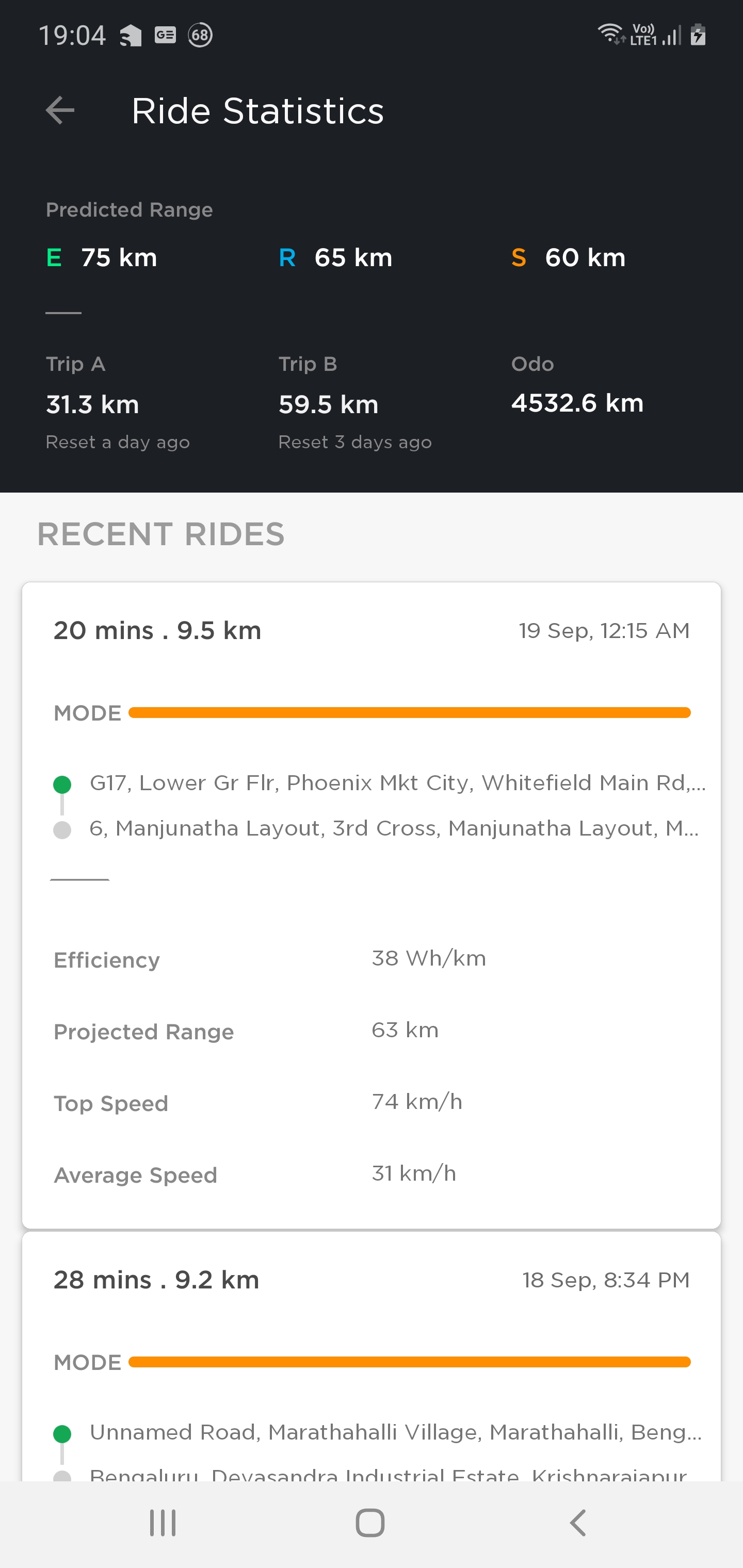

They were mainly flat roads with less or no traffic. No hard stopping and acceleration and I maintained a speed of around 20 KMPH.
The ride stats are really weird after the last OTA update.
If I ride using all 3 modes, they all somehow try and match up to the 75, 65, 55 limit of range. Which is very false.
I’ve ridden smoothly in only sport mode and even with an average of 27wh/km my estimated range in sport mode never shows more than 65 or 75… (I used to get 85-90 before on average)
I feel that Ather is really complicating the whole predicted range thing. While there can be complicated algorithms predicting range based on energy consumed, terrain, driving style etc, at the end of the day it is a simple linear math.
Remaining battery capacity / average wh consumed. And that’s all I need to see when I am riding. The current way of displaying range based on the mode is not useful. The range should not change based on switching modes. Just keep it simple and show one value based on the battery capacity and the wh/km average.
I change modes based on the riding requirement and will control the amount of power I need.
What am I missing here?
I tried all three modes on a single ride, followed by several short rides on sport mode. The predicted range seems to get affected only in the dominant mode.
