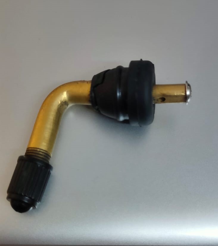

I purchased TPMS on 10/06/2022, For installation of TPMS the service center mentioned that they get it done from outside tyre shop. I have to change the tyres as well, hence they told me to go this shop where they get the TPMS installed. This shop is an authorised Michelin tyre shop Hence went to same shop. Change the tyre to Micheline Pilot Street pro 2 with same profile 90-90-12 and installed TPMS.
No issue while installing the rear TPMS, while installing TPMS on front wheel we faced issue with valve leak. TMPS was installed on front tyre, when inflated and checked in water, there was a small leak in the valve. The tyre shop tried to put adhesive to check if it can be leak proof. However, have to remove the valve, as leakage was there in the valve. While removing the valve the rubber lining of the valve got damaged. There was no other way then just pull of the rim. The TPMS sensor is intact and have no issues.
At service center they didn’t have any extra valve, they told me to buy a new TPMS instead. It’s a valve issue and not the sensor issue, this valve issue can happen to any vehicle going forward. I understand, this is new product and won’t be available immediately of the shelf.
It’s a humble request to send only the valve to the service station for which I am ready to pay as well. Without valve I won’t be able to use the TMPS. Eagerly awaiting your response on the same.
I am attaching photos for front tyre TPMS for your reference.
Thanks & Regards Chetan Visal
You could have returned both valves and asked for replacement as this is a manufacturing defect. Usally both of them will be in paired to each other.
