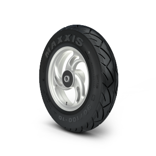

MAXXIS
  1. M6309
MAXXIS M6309

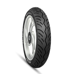

  1. M6307
MAXXIS M6307
  1. M6302
MAXXIS M6302
  1. M6016
MAXXIS M6016

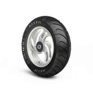

  1. M922F
MAXXIS M922F
  1. M6000
MAXXIS M6000

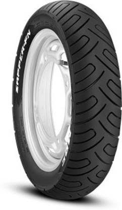

  1. ZAPPER FG (Stock Tyre)
MRF ZAPPER FG

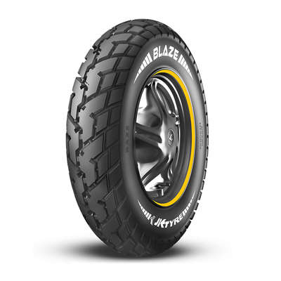

  1. BLAZE BA21
JK BLAZE BA21
  1. BLAZE BA22
JK BLAZE BA22

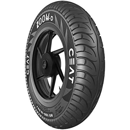

  1. ZOOM D
CEAT ZOOM D

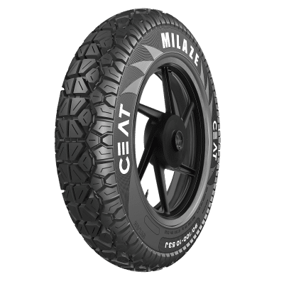

  1. MILAZE
CEAT MILAZE

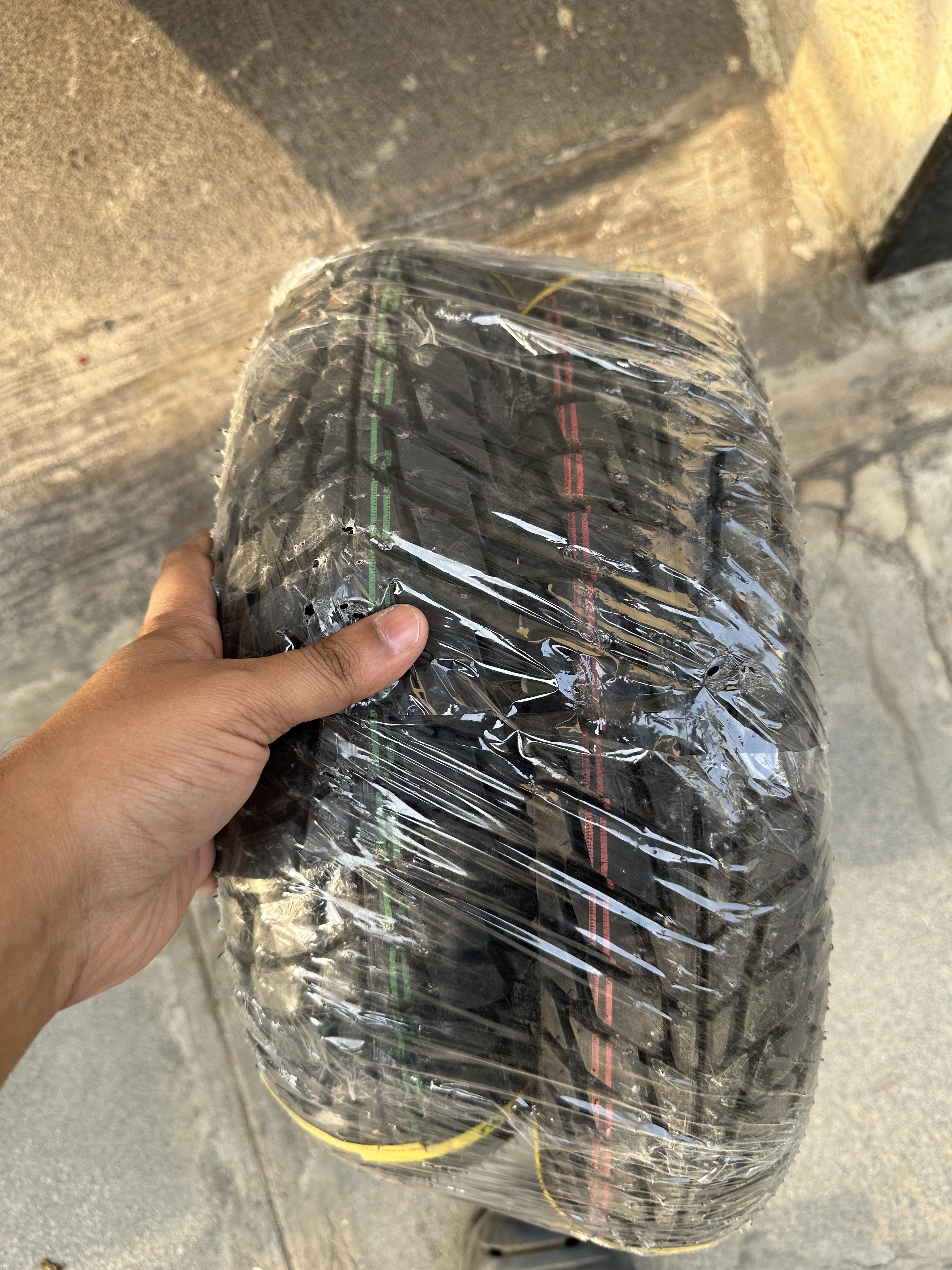

As the Gen 3 scooters comes with 100/80-12 back tyres, the previous generations can also use the same size tyres . Even though Ather is yet to release the MRF Zapper N used in gen 3 scooters as an accessory, We can still use the one’s available in market currently. Most of them are front tyres used in TVS Ntorq but does the job for us. But do keep in mind that replacement tyres are never the same quality as OEM fitments .
MRF ZAPPER FN
images (1)
Though the tread pattern looks similar to the Gen 3 stock tyre, compounding is different.
Now coming to the change in ride feel, wider tyres always feel more comfortable compared to the stock tyre. Gives us better confidence while riding, especially in corners and while hard braking.
I have changed the same MRF ZAPPER FN 100/80 12, Grip is much better than my previous 90/90 12 stock tyre.
But the efficiency also affected. May be more than 5 kms
No range drop for me. Did you get the belt tension adjusted from the EC after the tyre change? If not, please do.
Some dust in belt, after a wash i get a proper range, Got good grip and confidence while ride the scooter
Got 450x pre-owned, the rear tyre is completely bald.Planning to get Ceat ZoomD.Can tyre be changed from a nearby FNG or need to go to the Ather Service center ? I dont want any problem with warranty claims.
You can change the tyre at any tyre shop. Just ensure that after changing the tyre, get the belt tension checked at the Ather service center. As regards the warranty, better to fit same size tyre the vehicle came with.

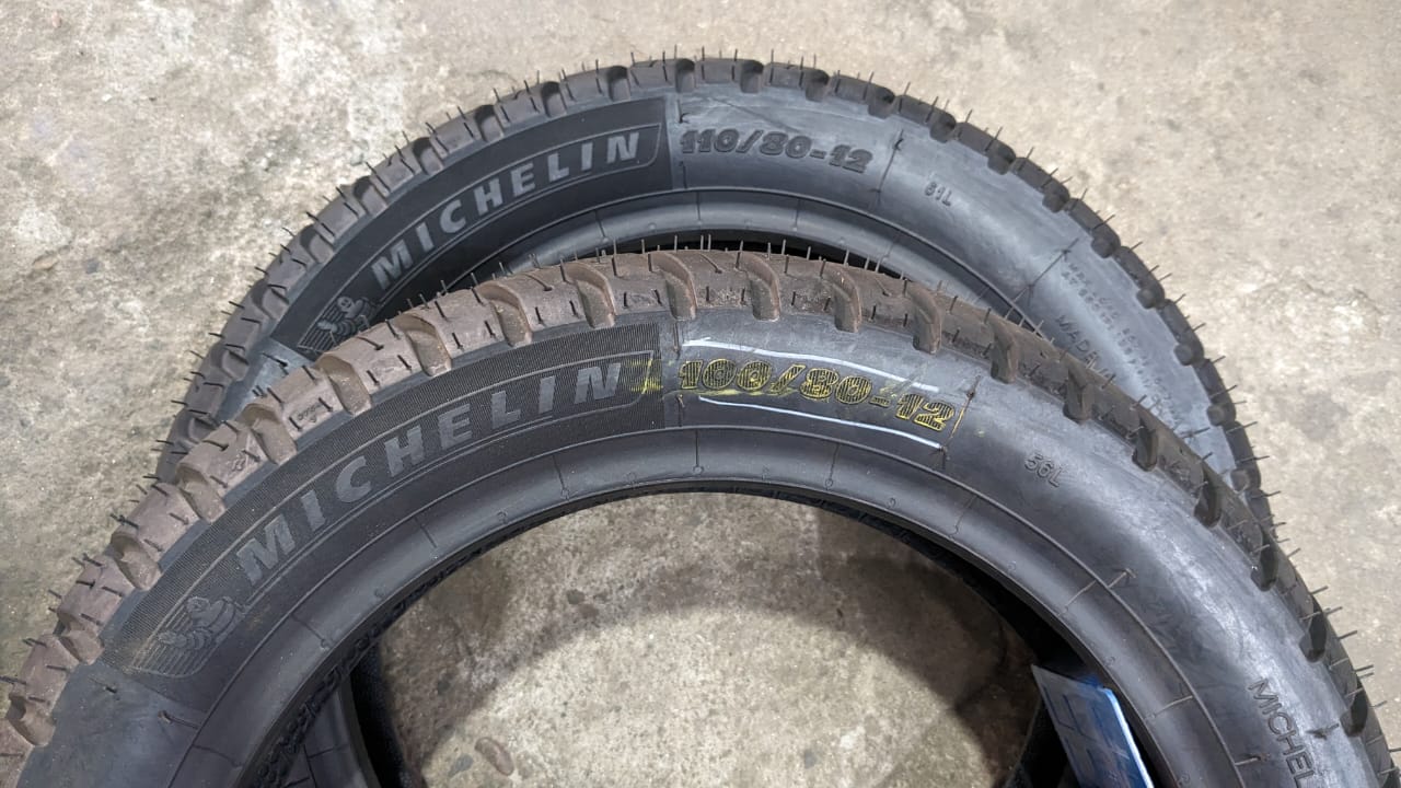

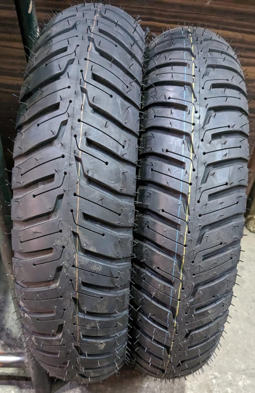

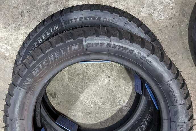

The All New Michelin CITY EXTRA
City Extra is all new for the 100/80-12 and 110/80-12 Size
Earlier They had Only 90/90-12
This will really Helpful for Better Riding But 3-4 KMs Range Drop maybe There But Not Sure
Really Waiting for 100-80/12 Michelin Pilot Street 2
Picture Courtesy: @tpav.vasanth
