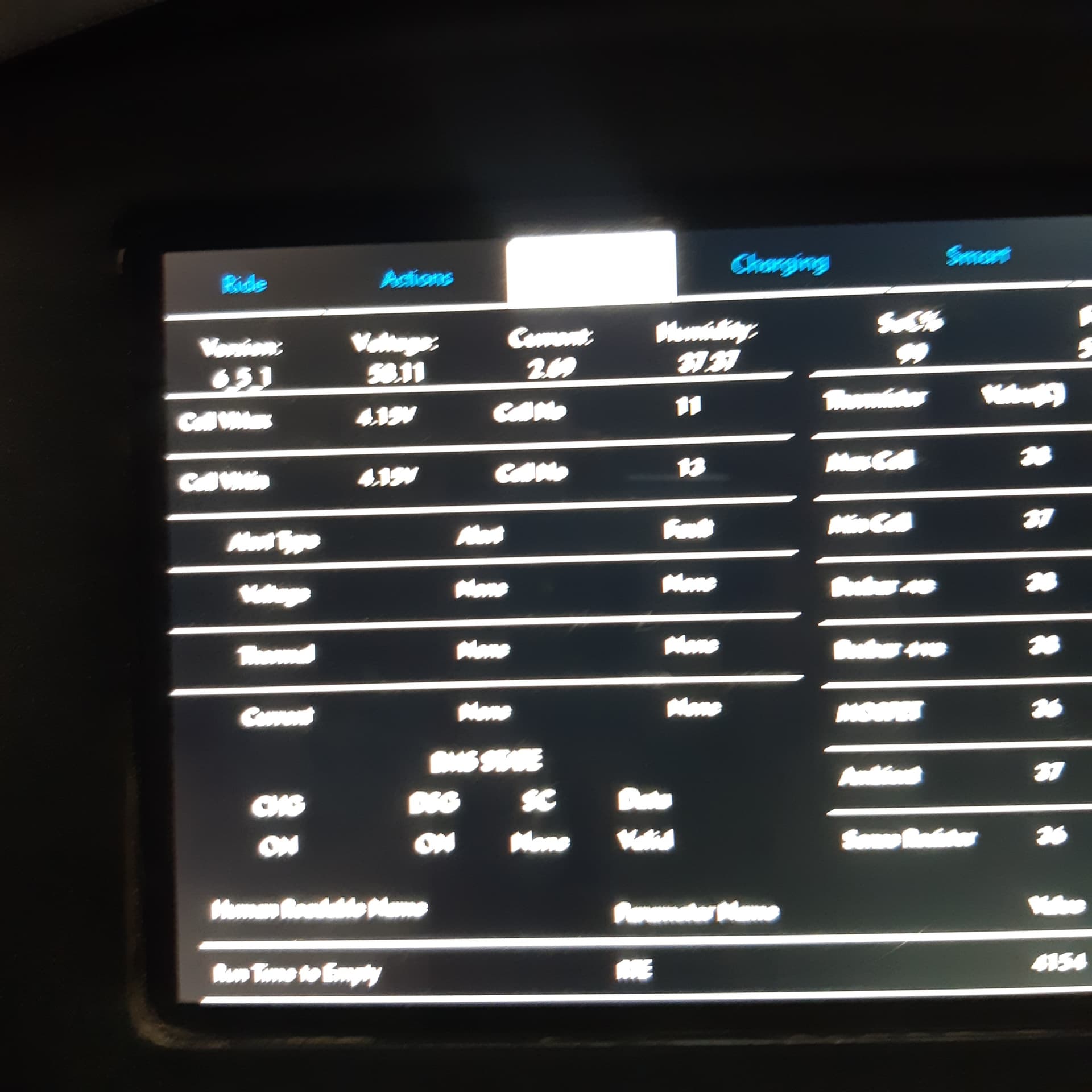

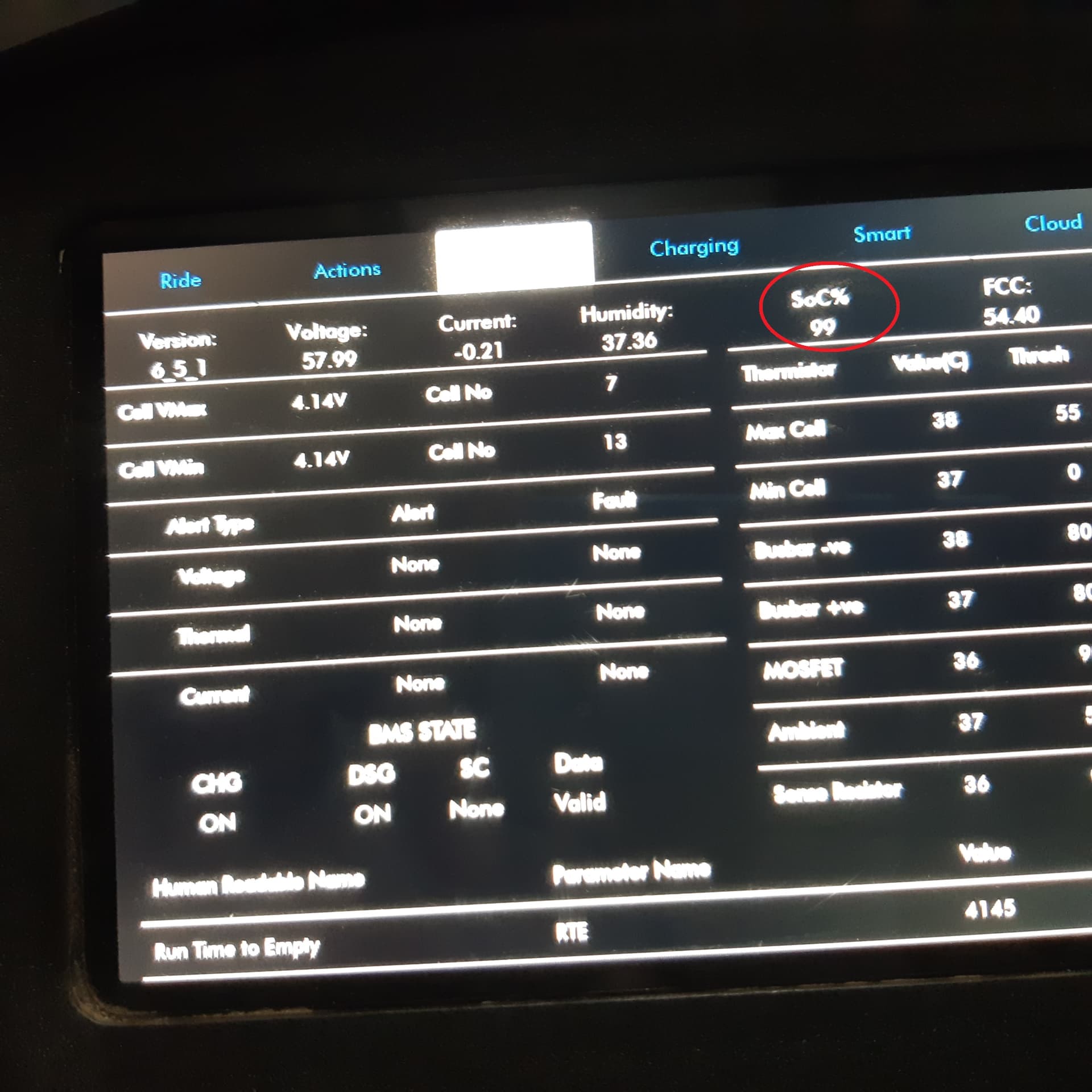

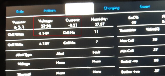

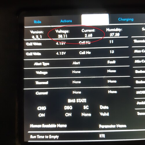

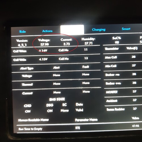

My battery Pack is behaving extremely weird, I keep it charging for almost 3 hours at 80%, when I come back the charger is switched off and the battery is at only 99%, I have been complaining and complaining to Ather CC about this issue long back they took it to the service centre twice once with even my DOT saying it might be the issue but no, the DOT is not the issue my pack is the issue.
Here are the Pics of BMS indicating the charge is switched off the battery at 57.99V considering that there is a buffer of 11~12% the cells never go above 4.15v the pack should charge to 58.1
But it never does, So I restart the charging system, and the Dot charges it again to 58.11v at 2~5 amps and then again it switched off at 58v and the pack volt drops again to 57.66v
and the dot again stops charging can anyone from the battery management team respond to why my pack does not want to stay at 100%
or has the SOH is now dropped? I have been complaining this fact for almost a year now
