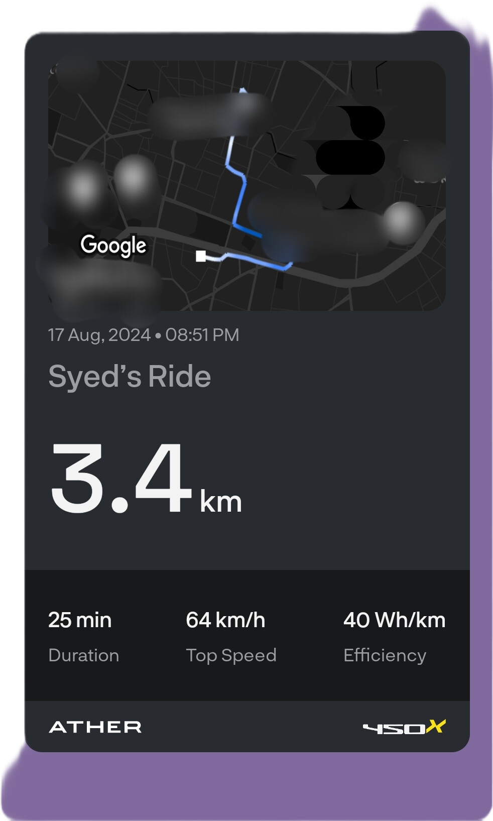

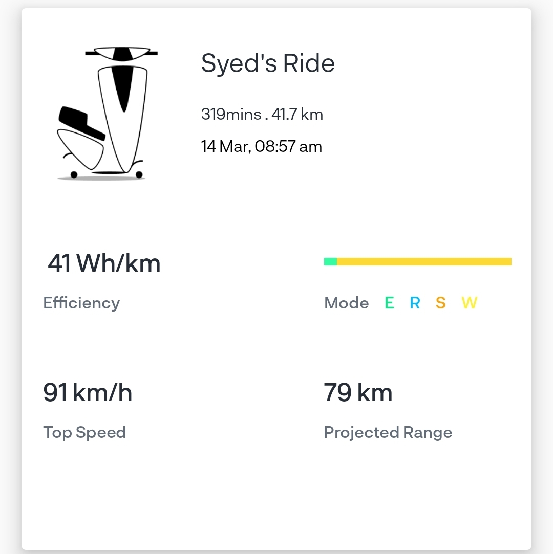

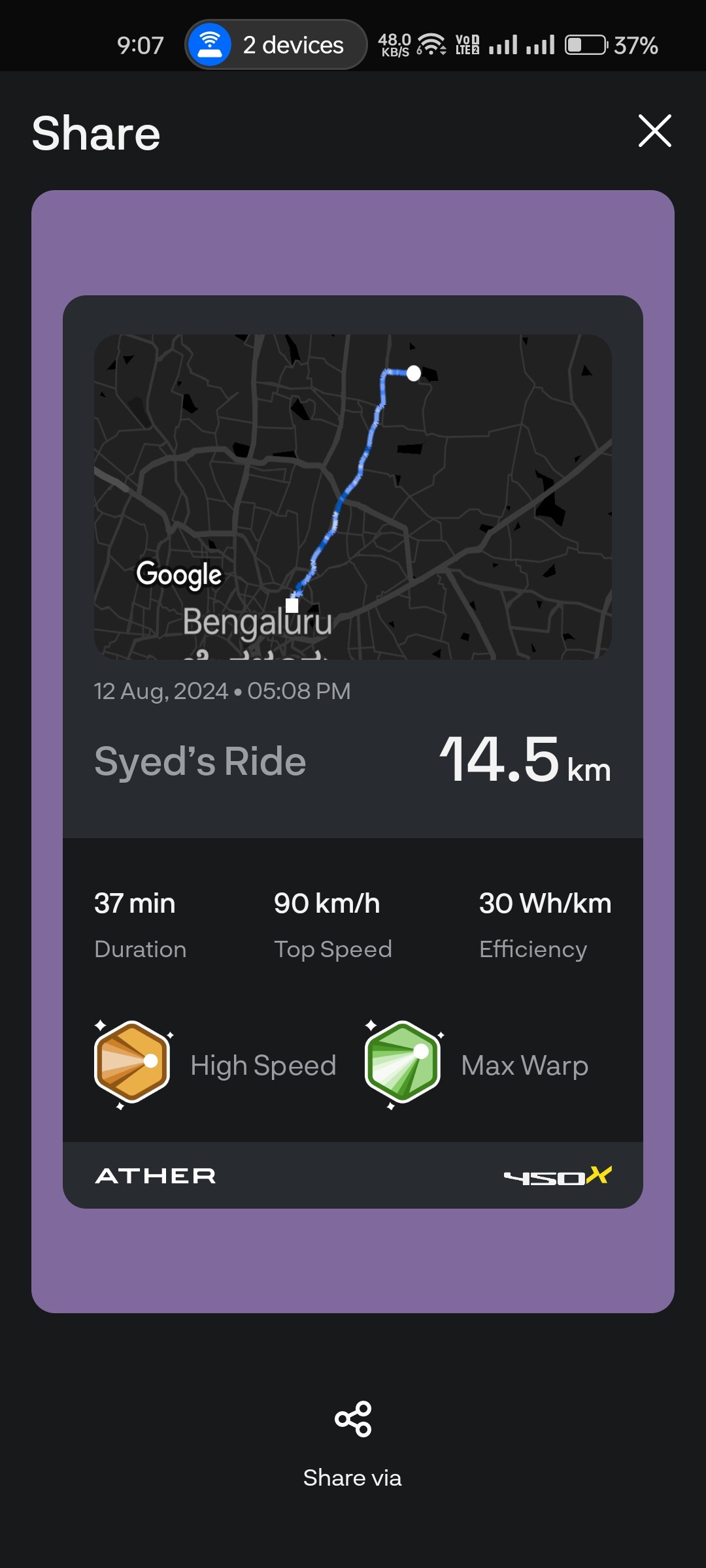

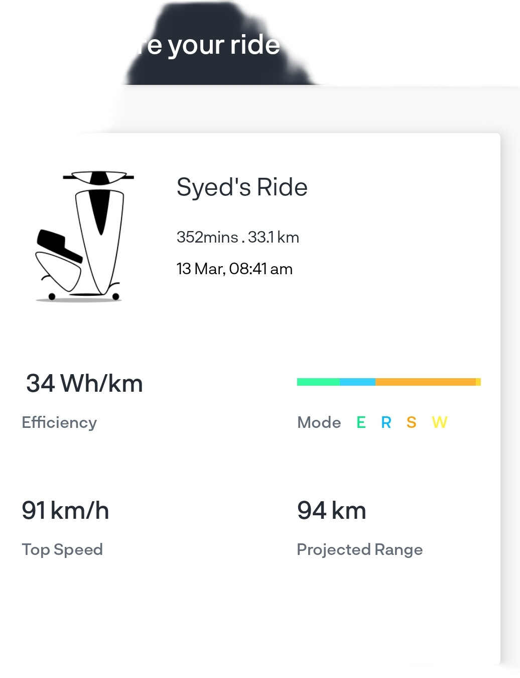

Share both the ride stats here
Cannot find an recent one as I had beta for few days now Best efficiency I got on warp (1st image )
2nd one is present wala
How do you manage such bad efficiency of 41kmph? The worst I have got on my 450s with a pillion rider is 35kmph, and that too riding at 90 for quite a while
I too don’t go below 36. You were driving really bad.
But I don’t drive rash just tend to always open the throttle full after a red light stop or any stop cuz warp is really addictive :face_in_clouds:
Yeah sudden acceleration is one of the main culprit
Even casual rides give me 40wh/km
Something’s wrong either with your riding style or your scooters battery
