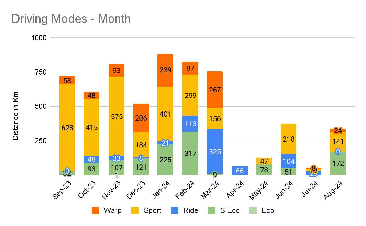

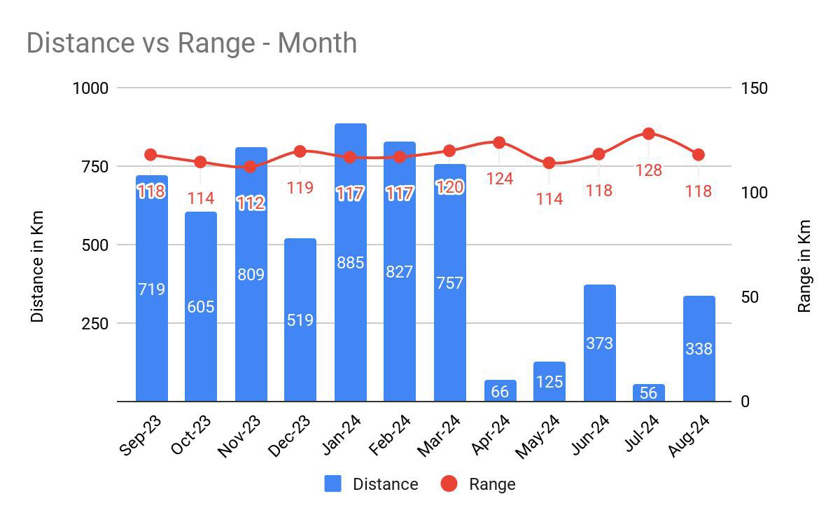

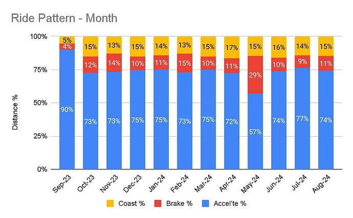

Here is my stats, it includes solo and with pillion. So it gives an idea what’s the average range I get on each mode and there’s no big difference.
Use brakes only when it’s needed, try to use the regen when you want to slow down. My friend was using the vehicle in May-24 and see the dip.

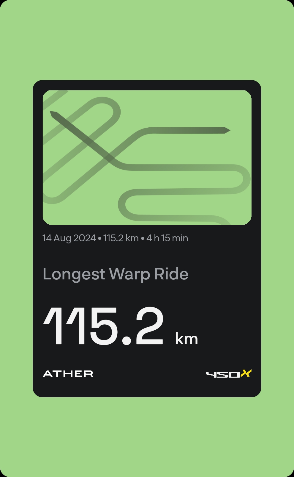

The above images shows my experience in warp and sport mode
The ride that I could never forget with a 420 days of ownership and the beast accelerates at its best.
