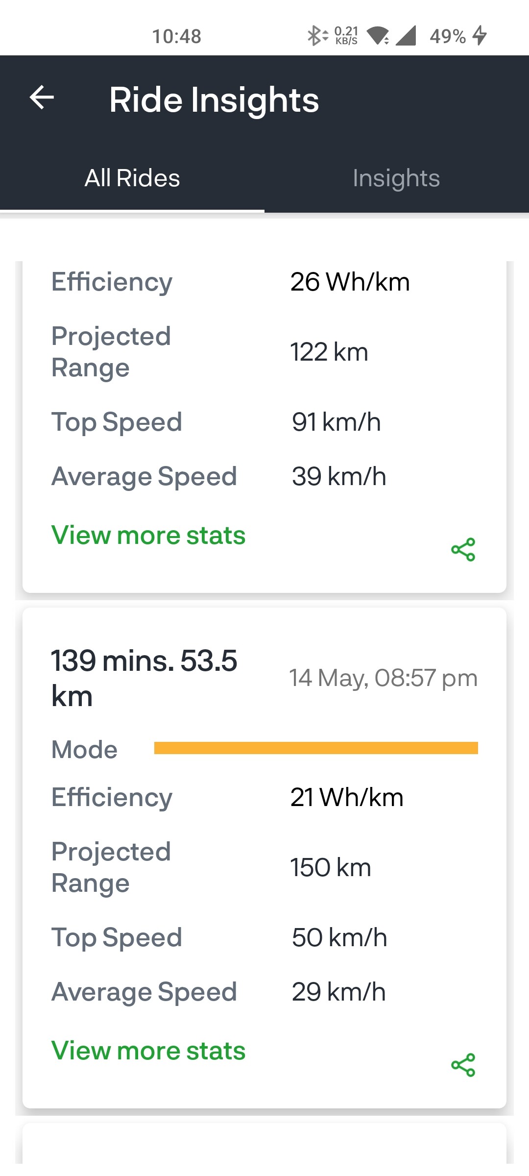

No mine is gen 3.1. No coasting regen yet. This is my personal best in last few months.
Single rider. No pillion. Charger in boot. PSI 30F and 33R. Sports mode throughout the journey.

I tried to do an efficient ride by throttling as per requirement plus coasting !
This was done with 5km range left, crawling to the nearest Grid (which was a Vida charger and one of the guns was melted, the other refused to work until I tried and re-tried for 15 minutes because I had no option)
AND
With a puncture in the rear tyre so it was sitting at 15-20 psi (later discovered there were 3 punctures)
I think on a good day, I can squeeze out 16-18wh/km :smiley:
