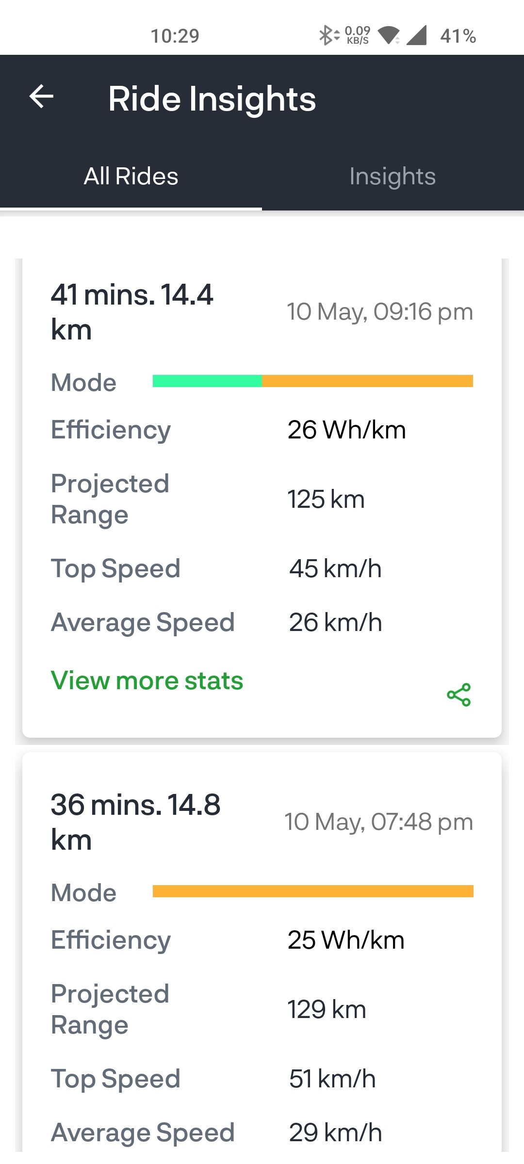

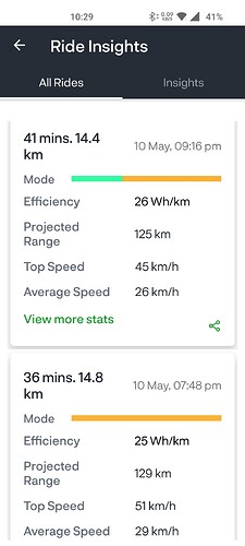

I have been projecting the good range based on how much range I could extract from 100-55. I didn’t get much chance to test 50-0, but I am aware that the drop below 50% would be much quicker.
My recent experiences confirms it and the range projection is very unreliable.
  1. Two weeks back, when my brother-in-law took the vehicle, 24 kms drained the battery from 60-0 and he had to push the last half km. The last 30% didn’t fetch even 10 km. I was surprised and I didn’t believe that at first.
  2. Last week, I had 65% SoC. With my usual ride, I would be able to get 20 km before sub-40. But, just in 15 kms, SoC dropped below 40%.
  3. Today, I started the vehicle with 39% SoC. My usual ride, known route. But, I was consuming double the juice than usual. Just for 8 kms, I consumed 14%, much much higher than my usual.
Learnings:
  • Need to check the battery health from service centre. Anyone knows the procedure to do this?
  • Don’t believe the range below 50%. Consider only 50% of the usual efficiency.

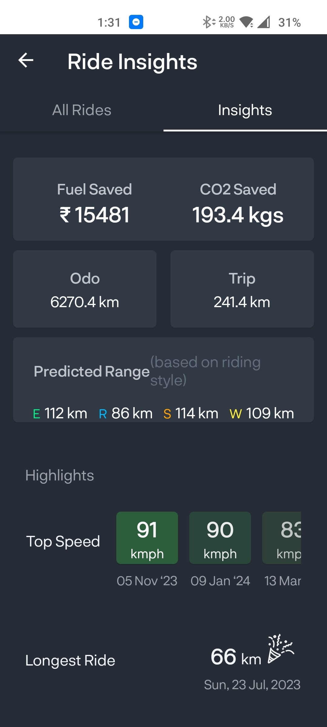

Just came back from 35k service and was told battery degraded by ~15%. However, the ride back home gave 28wh efficiency and traveled 65km with 98% battery before battery shutdown in the middle of the ride. By this calculation, the battery degradation is above 25%. Should breach the 30% mark in next 10k kms. Will company look into this calculations or they just reject replacement claim by 15% to 20% battery degradation from the SoH data on the dashboard?

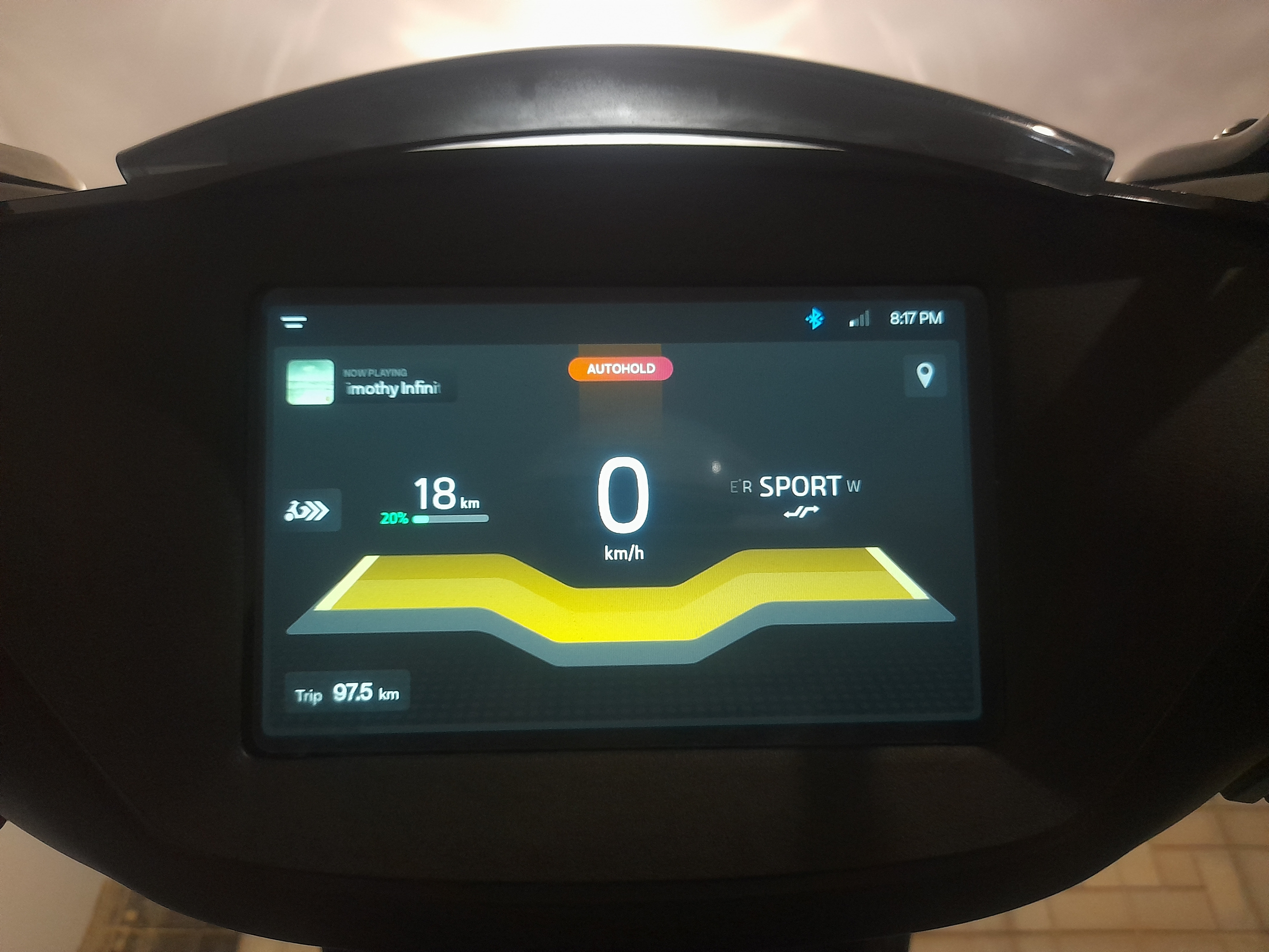

Again great figures. These are with pillion. Total weight 140+ kgs. More weight of charger and water bottle in the boot.
Eco mode switched on automatically coz of lower battery.
Do you keep coasting regen on?
