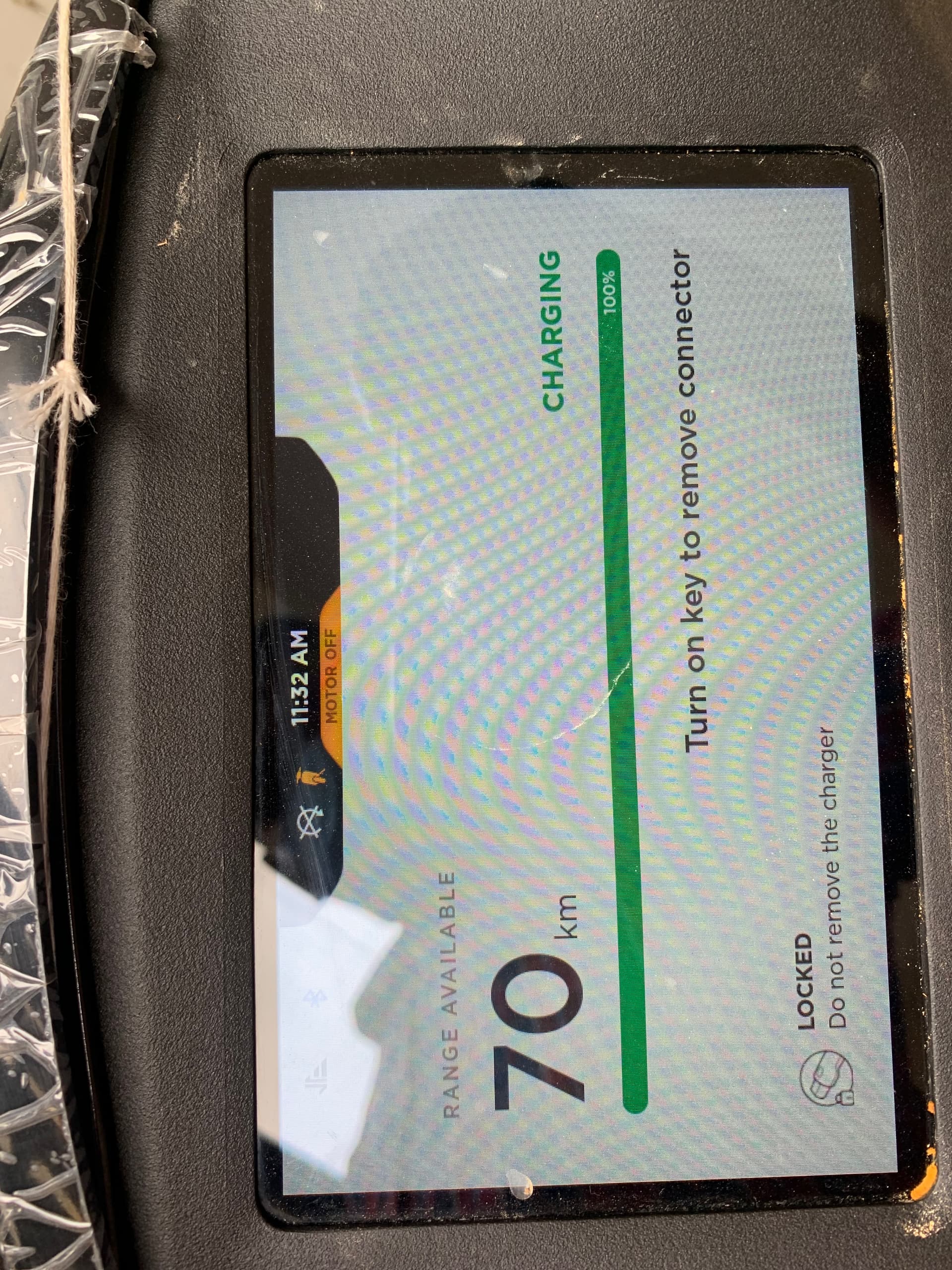

It’s brand new bike. Yesterday only I received. 100% charge shows only 70k
The displayed range is according to the selected mode. You must be in Ride mode, if you change it to Eco you will see 85.

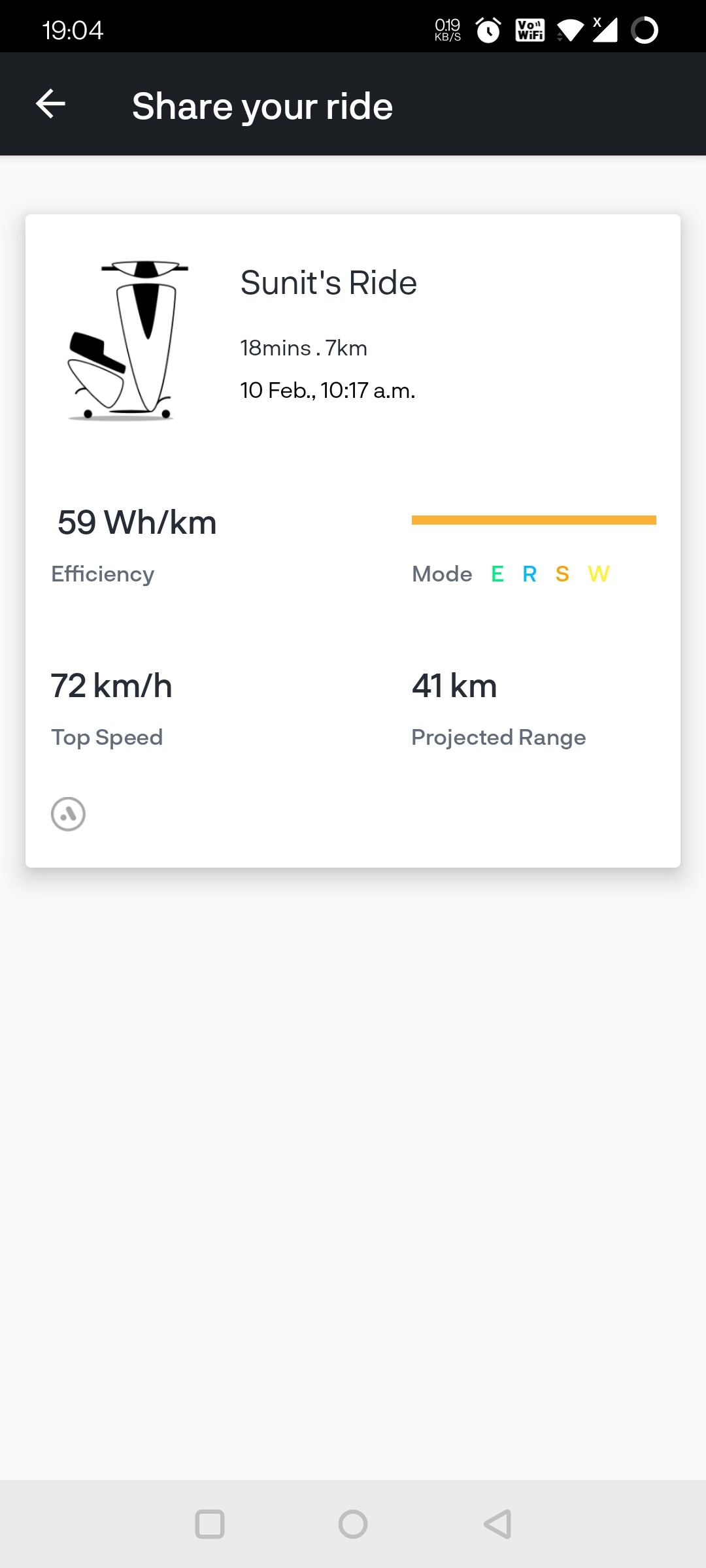

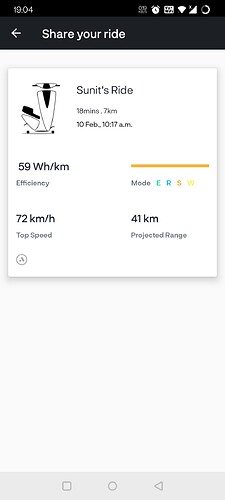

You will also soon note that the range shown on dashboard is indicative and it is just the charge% multiplied by a constant depending on the mode. The actual range will be notified either in trip meter or on app.
Probably your flight in Ride mode. Check on Ather app for confirmation.
