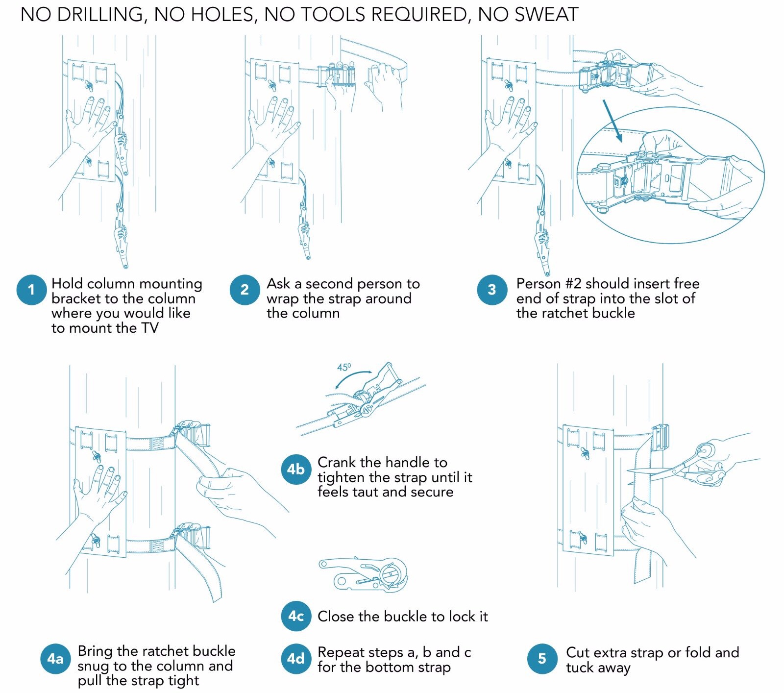

This does look like a better option. Will Ather do installation in this way if customer asks for it? Does anyone know if Ather supports installation on thirdparty/DIY floorstands? I canât spend 4k for the floorstand.
@khomath84 any idea where can I order this online?
This is possible when all sides are free. Not all pillars will have all 4 sides open.
I donât know if Ather will install pod on third party/DIY stands

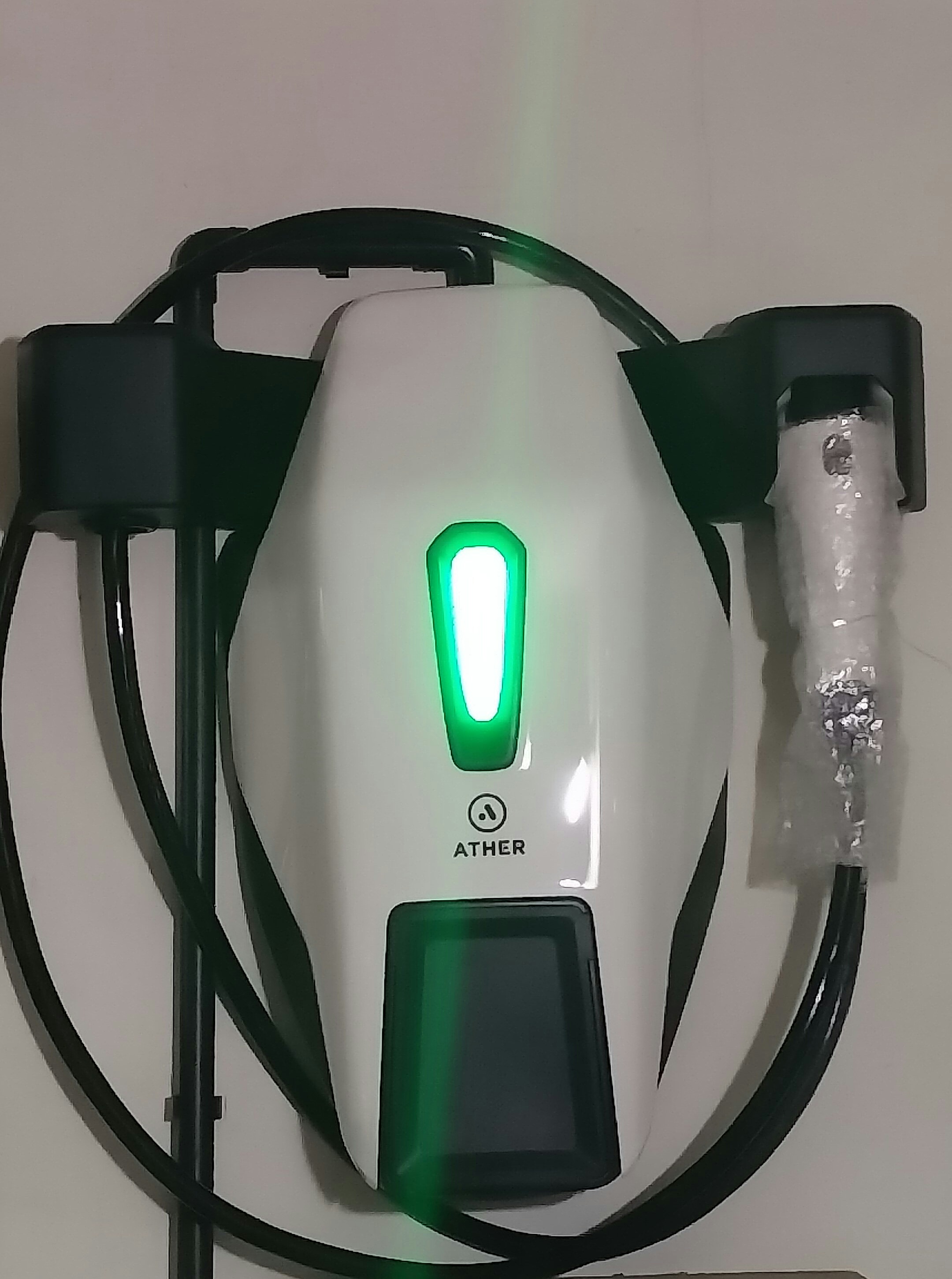

Hi, just pre-ordered one today. I have a question regarding the point installation. Can it be installed indoor rather than outside the house as the wire can be sent through the windows while charging?
The point will blink green while charging! You donât want your entire house lighting up.like that at night!
Also, the wire may not be long enough to reach the vehicle comfortably.
