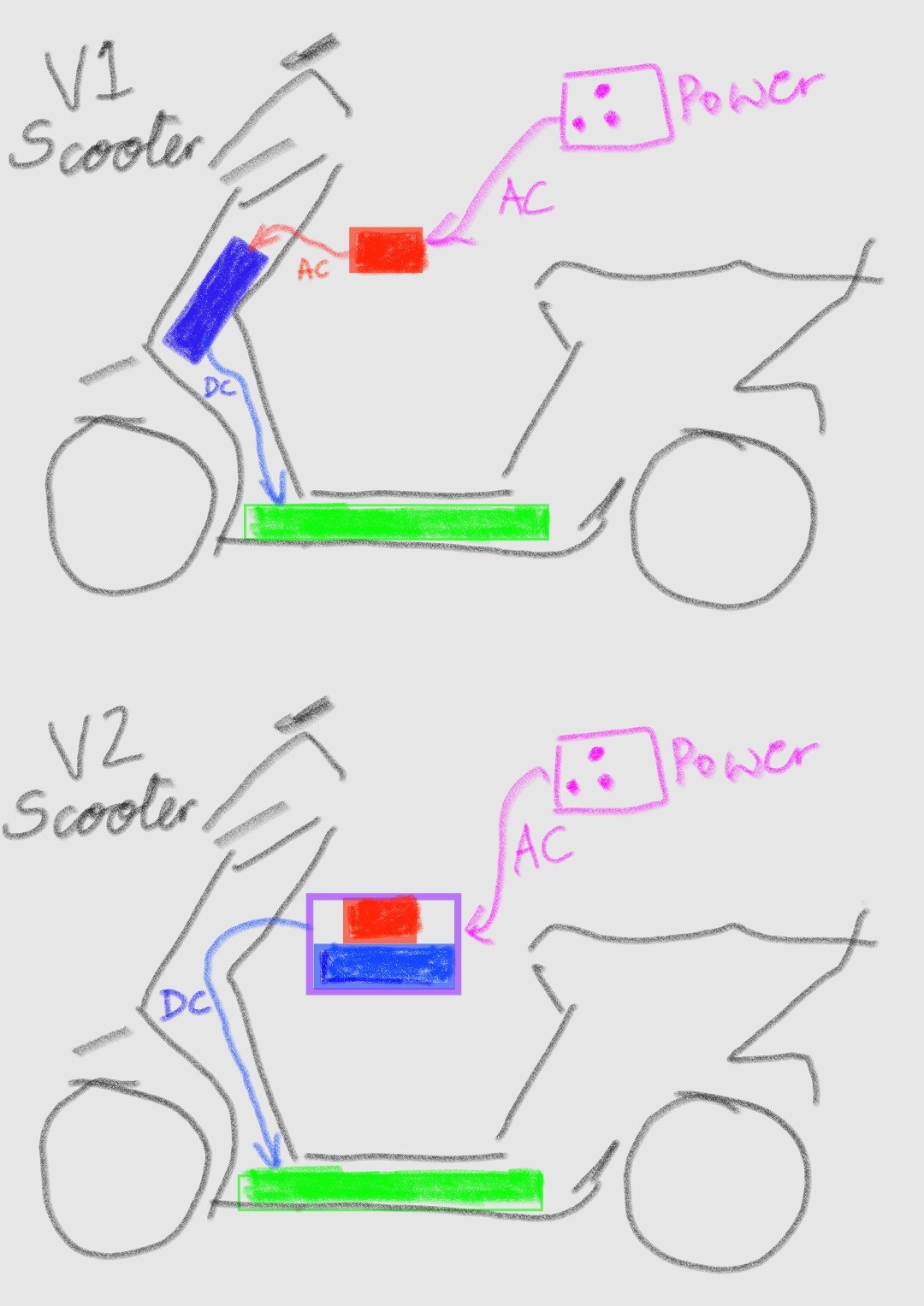

Just because it is DC, it doesn’t mean that it has to be faster. Basically there was an onboard charger in the old scooter whih used to convert AC current to DC current before supplying to the battery. Hence the v1 Portable Charger was small.
V2 scooter’s on board charger was removed and hence that part had to be moved to the charger. That’s why the V2 portable charger grew in size.
So, as you can see from the image above, it’s a location change and nothing more. So the charging times also remained more or less same.
