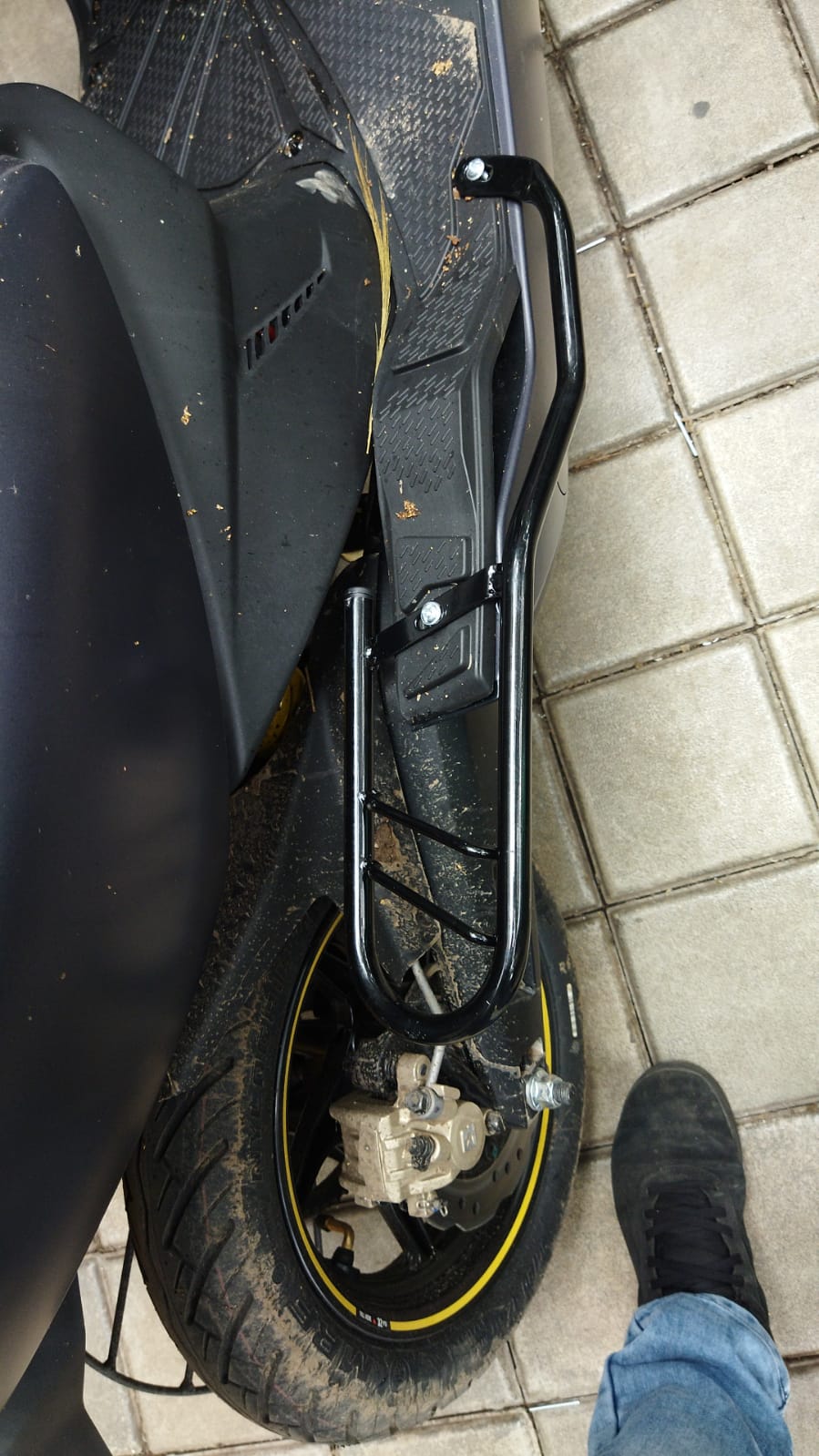

Ather does not sell any official or certified accessories for any 450 scooter.
Do you have any photos? How come nothing is there on the website. I doubt it will be from Ather.
They are Ather itself, I have personally tested foot rest when i have gone for test ride and full payment.
Here it is. It is available in Ather Showroom, Pune
Priced at INR 768 as on today
