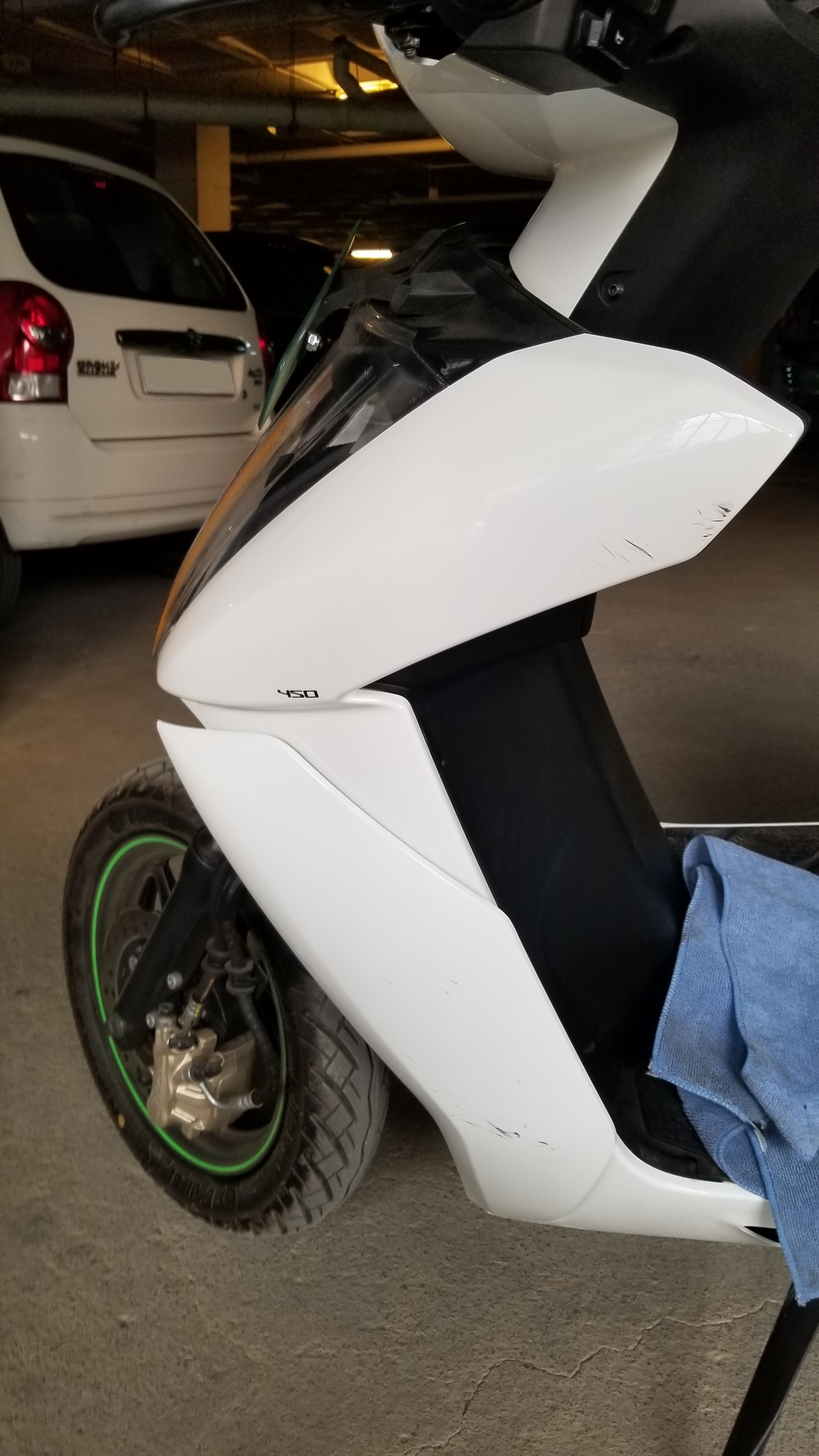

Sad to be one of the first ones to report this, but My scooter fell last Saturday due to an idiotic mistake from me
A friend met me near my home and he rode my scooter. After he rode it and parked it, we spoke for some time and he left. He had turned the handle to the right side. Because the handle was turned to the right side, it was looking nice. So, I took some photos in that place itself. Then, I went to the scooter from it’s right side and tried to lift the scooter to sit. Before I even realised, the scooter flew away from me and fell down. The motor was still on and without realising that, I had twisted the throttle a bit!

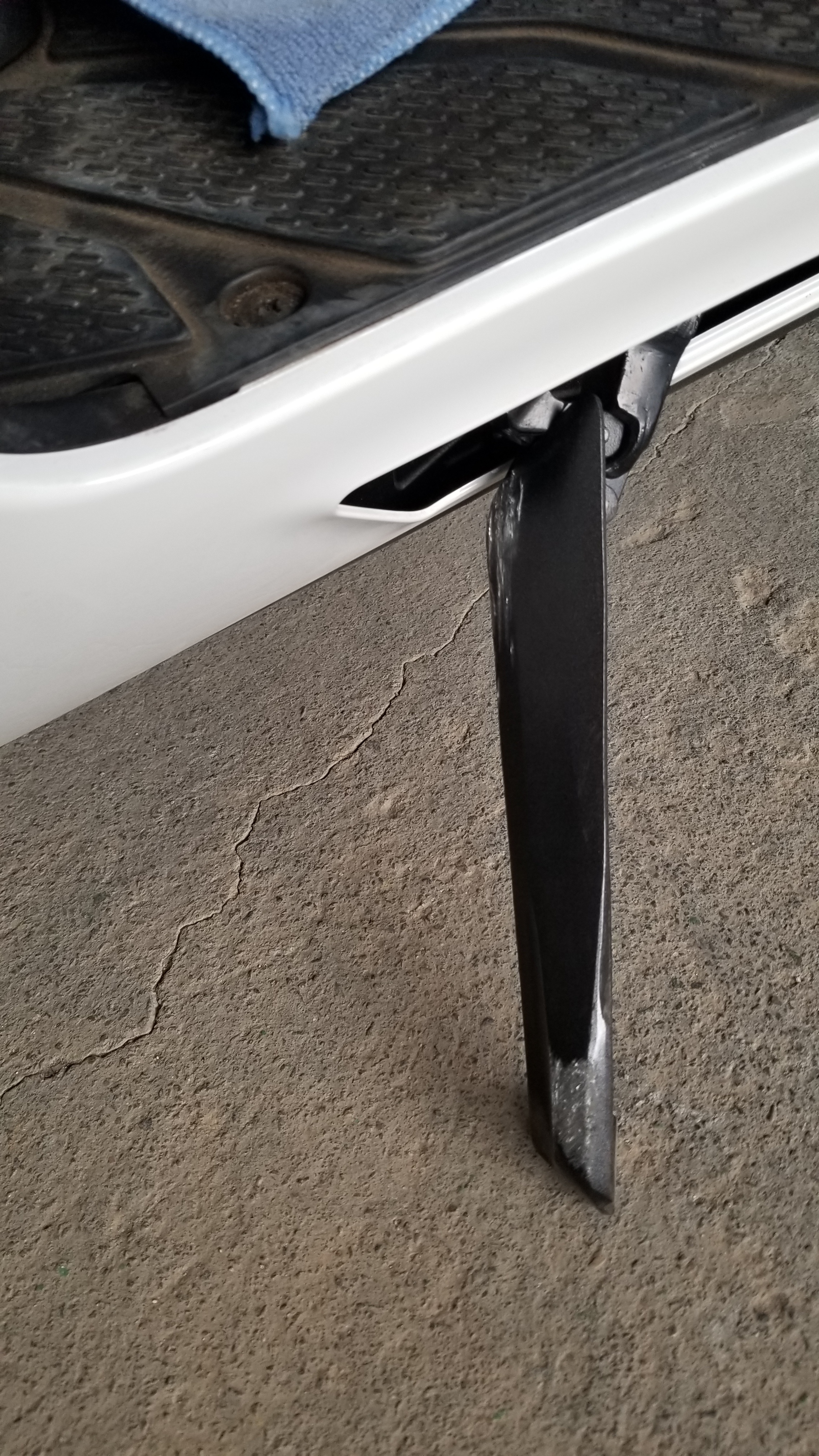

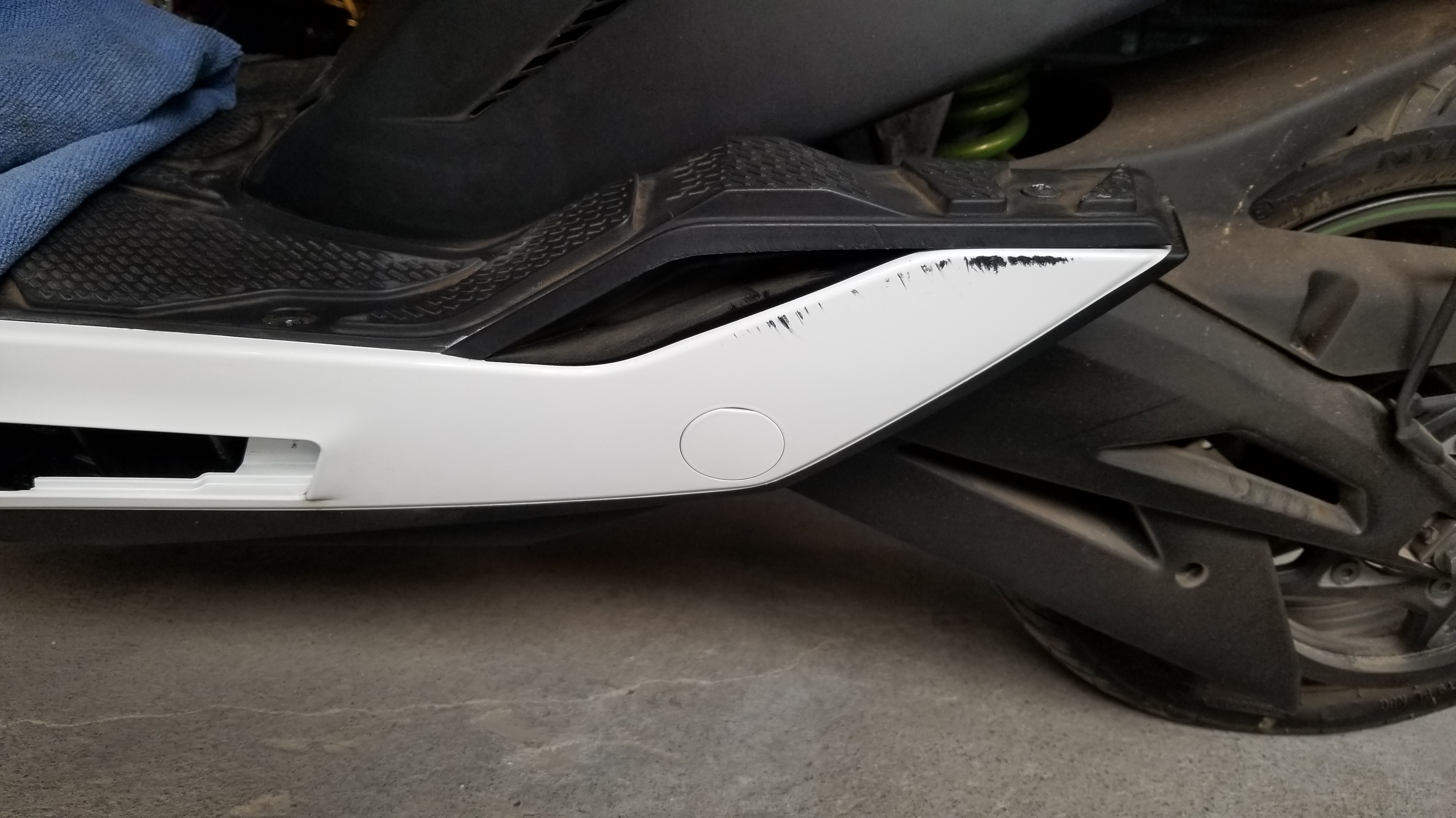

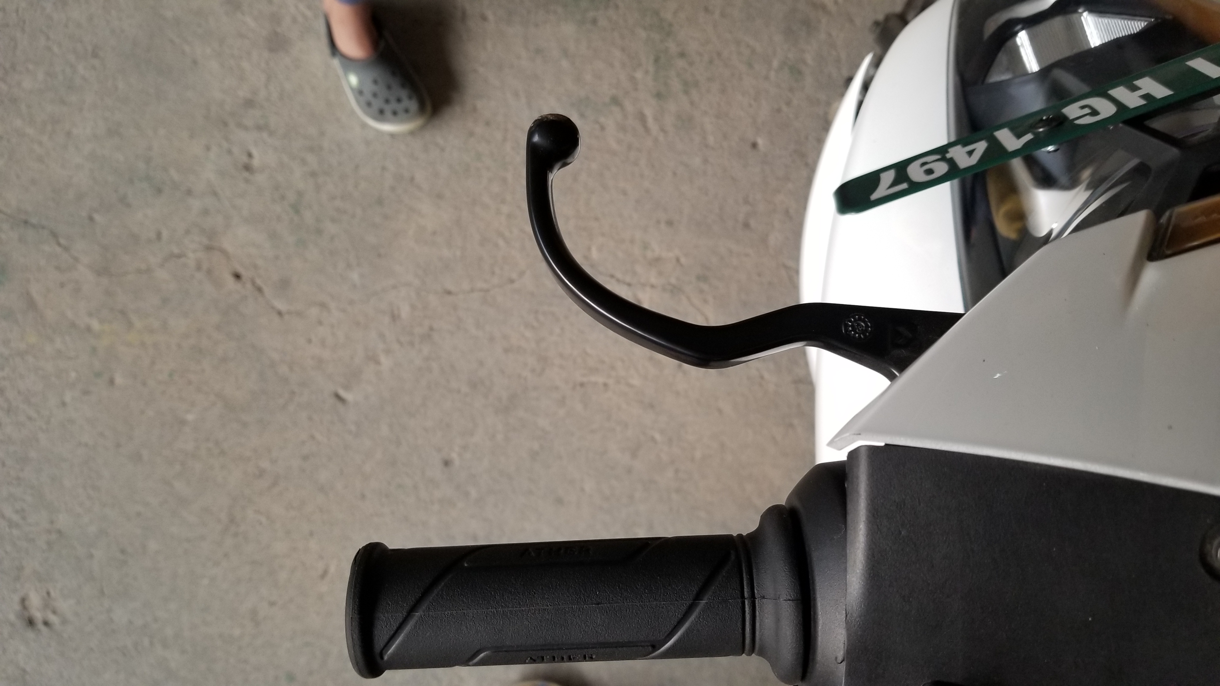

argh! I had not checked the engine kill switch. That gut wrenching feeling before you lift…really bad. When the scooter was lifted back, it was a sad sight, Left side panels had scratches all over. It was not a heavy fall but it was tarmac and not grassy ground. So it was limited to scratches. the side panels, the side stand and the rear grab rail had scratches! then I saw that the entire weight had fallen on the left brake lever and it was bent!
Although it was not a big damage and the vehicle was in perfect running condition, I can’t see any of my vehicle with scratches. I parked it in the parking lot, called the road side assistance and explained them about the mishap. It was a Saturday evening and hence the pick-up was scheduled for Monday. I was feeling terribly bad but felt a little better when I heard from them that mine was not the first such case. I informed Autovert too and they told me that after the Estimate from Ather, we can decide the further course of action.
Monday morning, the vehicle was picked up an hour before the scheduled time and it was taken to their IBC office near dairy circle. Later in the afternoon, I got an estimate of 4000 for replacement with new parts (3 LH panels, side stand, LH brake lever and the grab rail) and 500 labour. After thinking a bit, I took a call not to go for Insurance for such a minor damage. This meant that Autovert/Digit will not be involved. This was informed to Autovert.
Tuesday Morning, I called up to check the status and I was told that it’ll be delivered by 8PM the same day. the bill was generated and the payment link was sent. Exactly by the time I reached home, I vehicle reached home too. as good as new. The replaced parts were returned to me.
