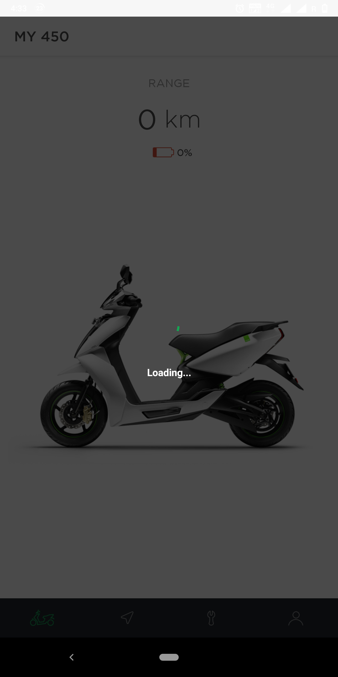

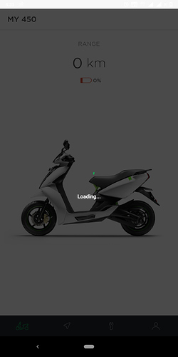

@abhishek.balaji, need help on the Ather app
Just took my flight delivery. After reaching home from Ather Space I thought to check my ride statistics on the app.
I’m stuck at the same screen for sometime.
It keeps on showing loading irrespective of any other action
I have tried in Mobile data and WiFi both.
Log out and login
Cleared cache and storage
Uninstall and reinstall
Nothing worked out. Is it an issue from Ather server or something?

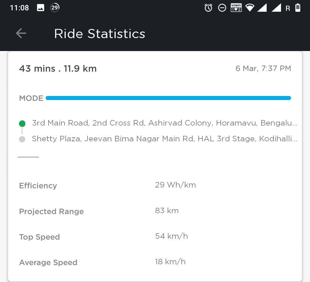

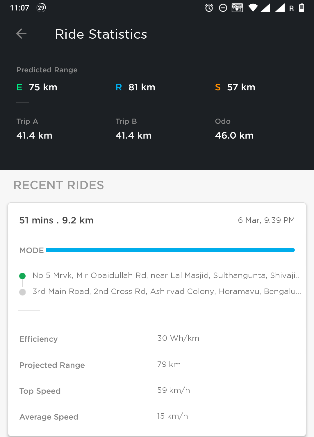

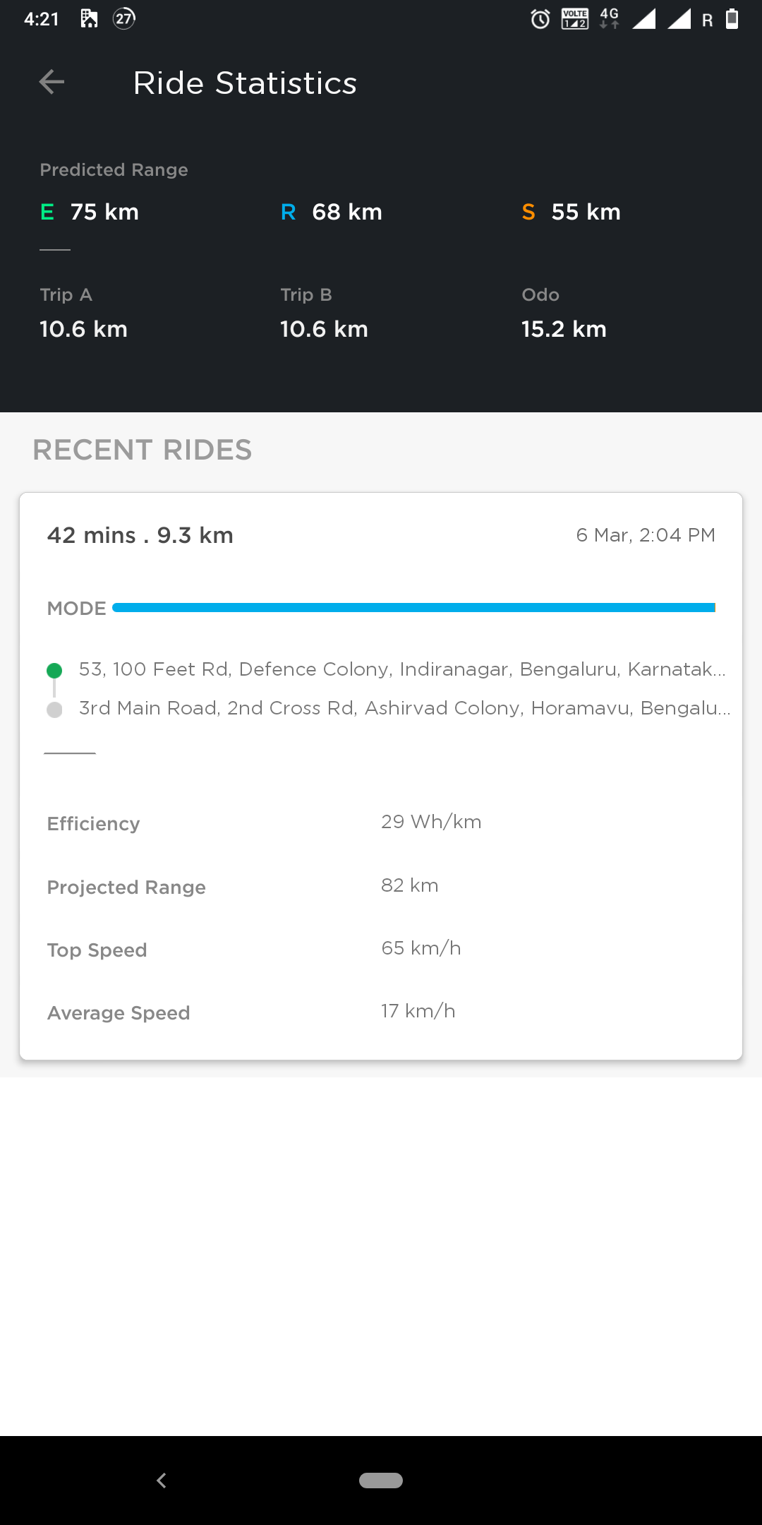

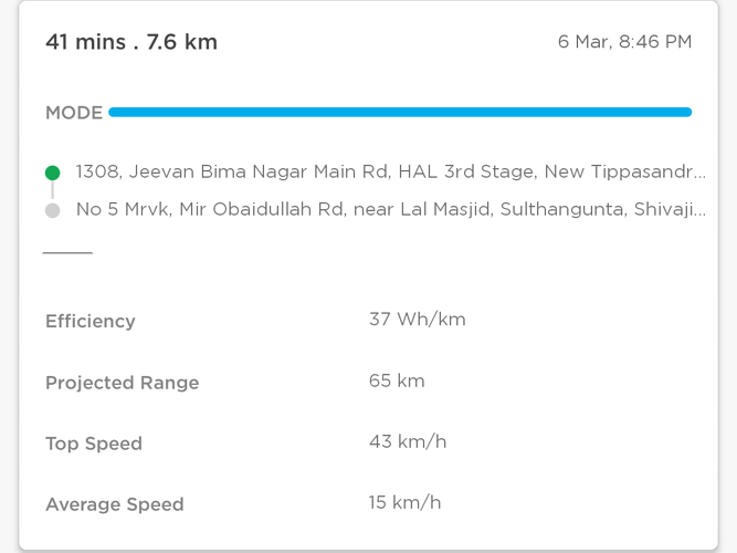

You were able to crack the 30 Wh/km barrier on Day 1! That’s great. It took me a couple of days to get below that barrier. Lowest so far is 27 Wh/km. Edit: my lowest

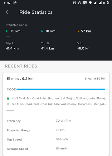

To add some more insight, attached one of the ride stats - my friend drove the flight who jaw-dropped with the performance.
It’s his first ride on EV, he didn’t get Wh/km et cetra, et cetra. Only thing he understood is brake responsiveness rest he heard as blah blah blah
