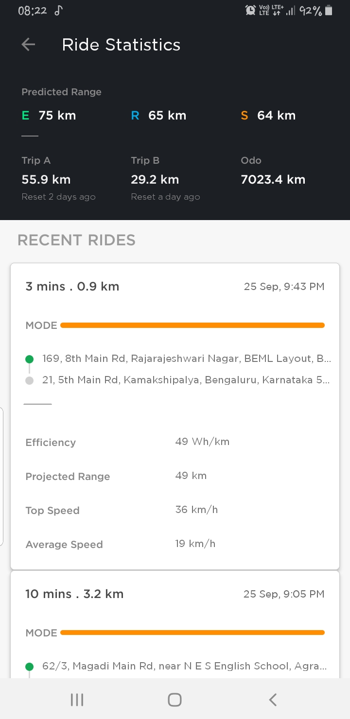

7k reached.
After OTA update I was disappointed bcz of reduction mileage. Now my flight is recovering back.:blush:

Congratulations… After the OTA update, the ride statistics no longer get updated for me on the app. Did you do anything to get it fixed as I see it’s working for you? I had raised a complain with Ather, they stated this is an issue across users and they were working on it.

109 km is ur predicted range in 1 full charge ?
