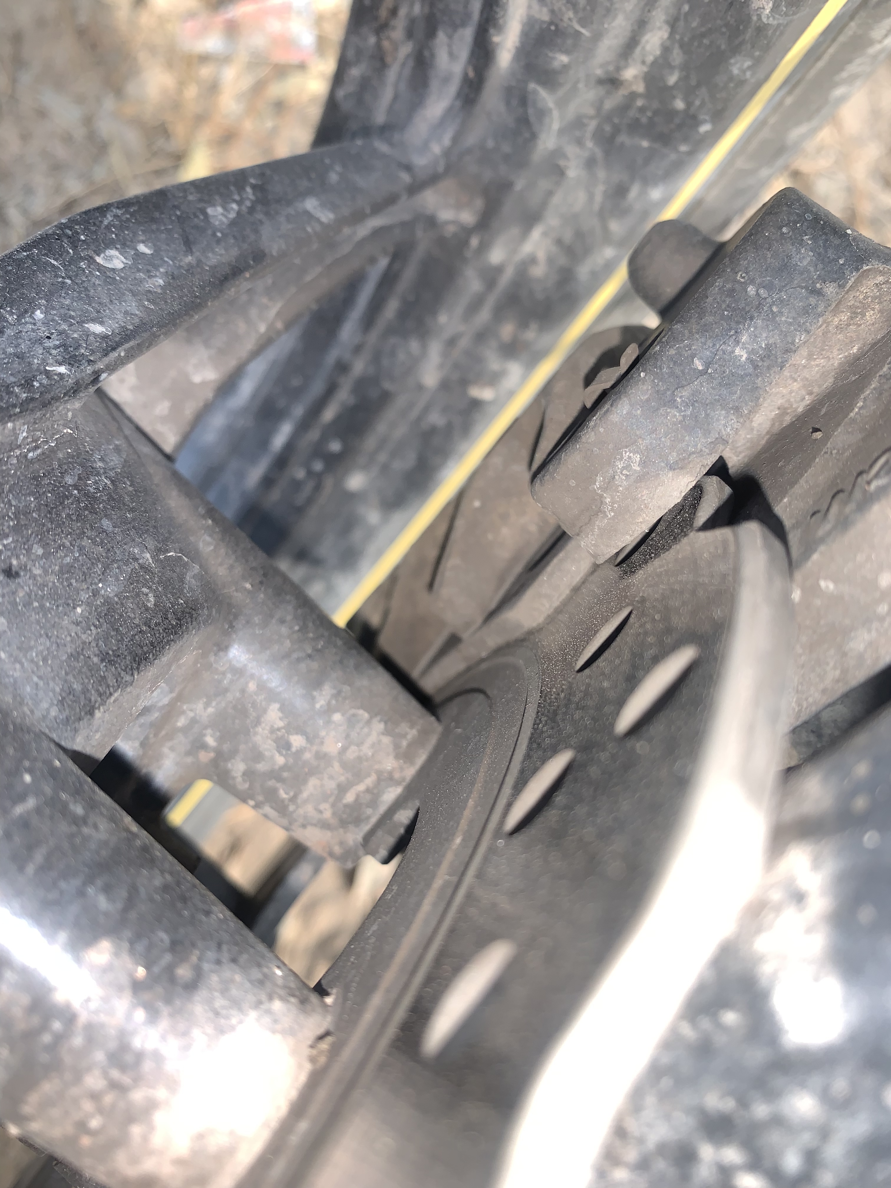

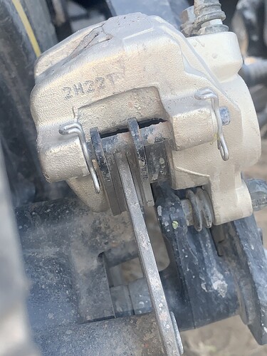

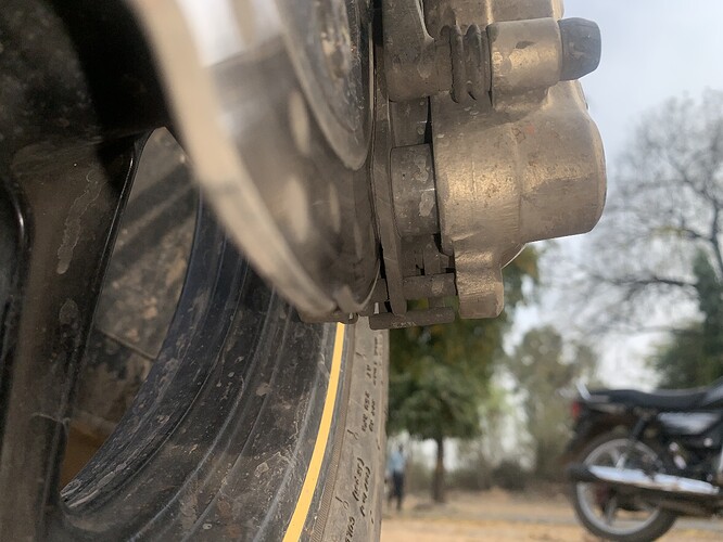

Photo of the rear brakes from the back of the scooter.
How much brake pad life do I have left?
You have quite a bit life left. But why this question?
It’s fresh as new no issue.
Not more than 1k KMs

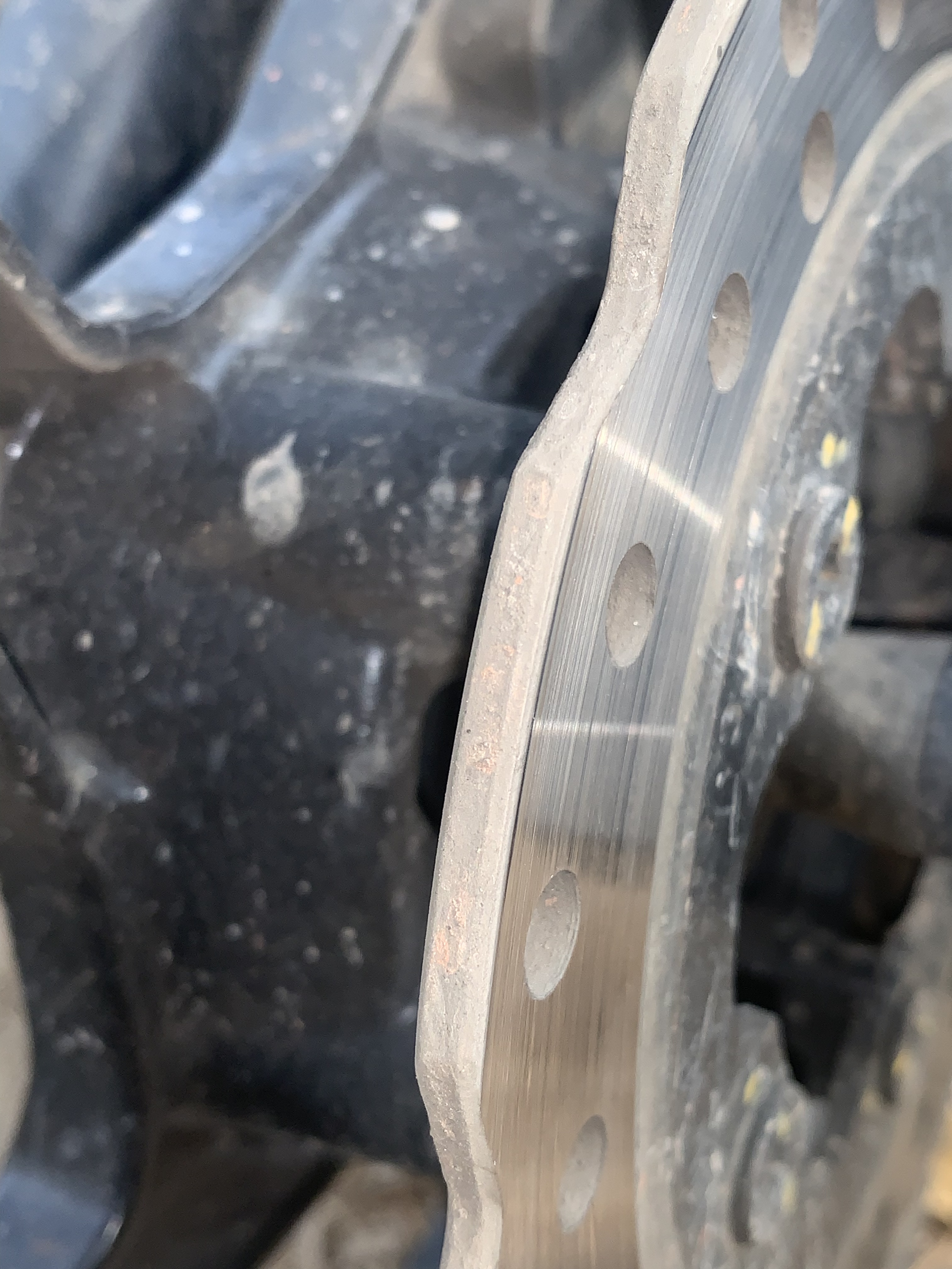

Front brakes, from the front of the scooter. The disc has scratches like usual but its still smooth to touch, the scratches can be felt only using my nail
Yup, this is how I also expect mine to be as well. Thats why I’m doubting the service guys.
I had weird sound coming from the brakes at around 9000 kms but it stopped after 9100, so I think that was probably just debris
Your front disc pads are worn out completely. No doubt on that. But you have plenty of brake pad life left in rear.

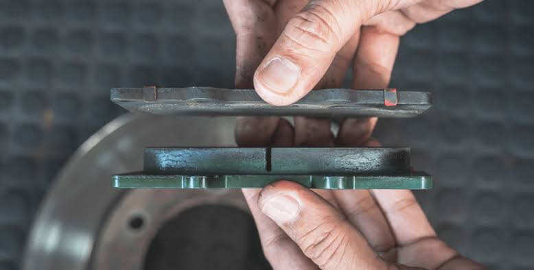

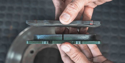

There are notches on the brake pads. When you can no longer see them, it’s time to change soon.
But they are pretty difficult to see on Ather. Pad thickness helps a lot, 1-3mm is very low.
