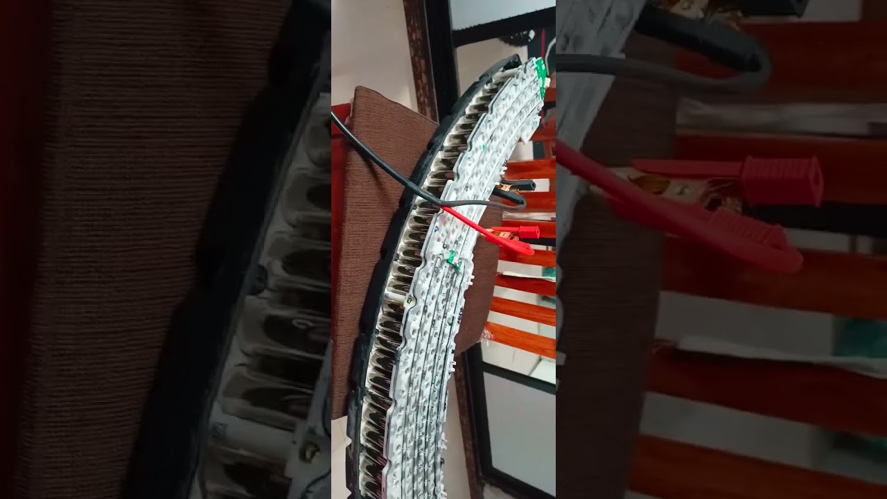

Cell level battery pack repair, he claims he can do Ather as well!
Probably can be done once before magic smoke appears while riding in rain or extreme conditions.
Also, probably changing a single cell is not a fix as much as having a weak one. That wil be the weakest link.
Yup that was my first doubt. I don’t think he’d be able to waterproof it OEM level. Only those who know what they’re doing should go this route.
that is the sketchiest cell balancing I’ve ever seen, If a well designed BMS is there, like one found in Ather, there is no such need of Cell balancing, My 4-year old Ather is still good with at least 90% true range. ~35k Km done.
PS: looks like he is just charging the cells not balancing it, balancing requires individual series connected to a aftermarket balancer and then charge the cells making them reach peak voltage and then drain it a few times then repeat till desired results .
And guess what if it gets blazing in fame they will blame it on company if anyone is doing this the company should blacklist therie batteries so the company doesn’t get blamed
Damn. Yeah right he’s just charging it while skipping the BMS. Not good
