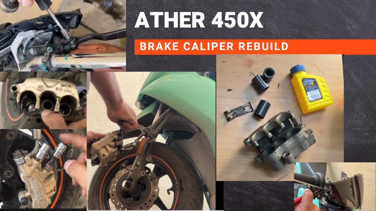

I managed to fix the front disk Caliper myself

you explained everything good, but the grease part is wrong, it should be applied only to the wall of pistons and on the seals but not in the rear part, you are contaminating the brake fluid.
