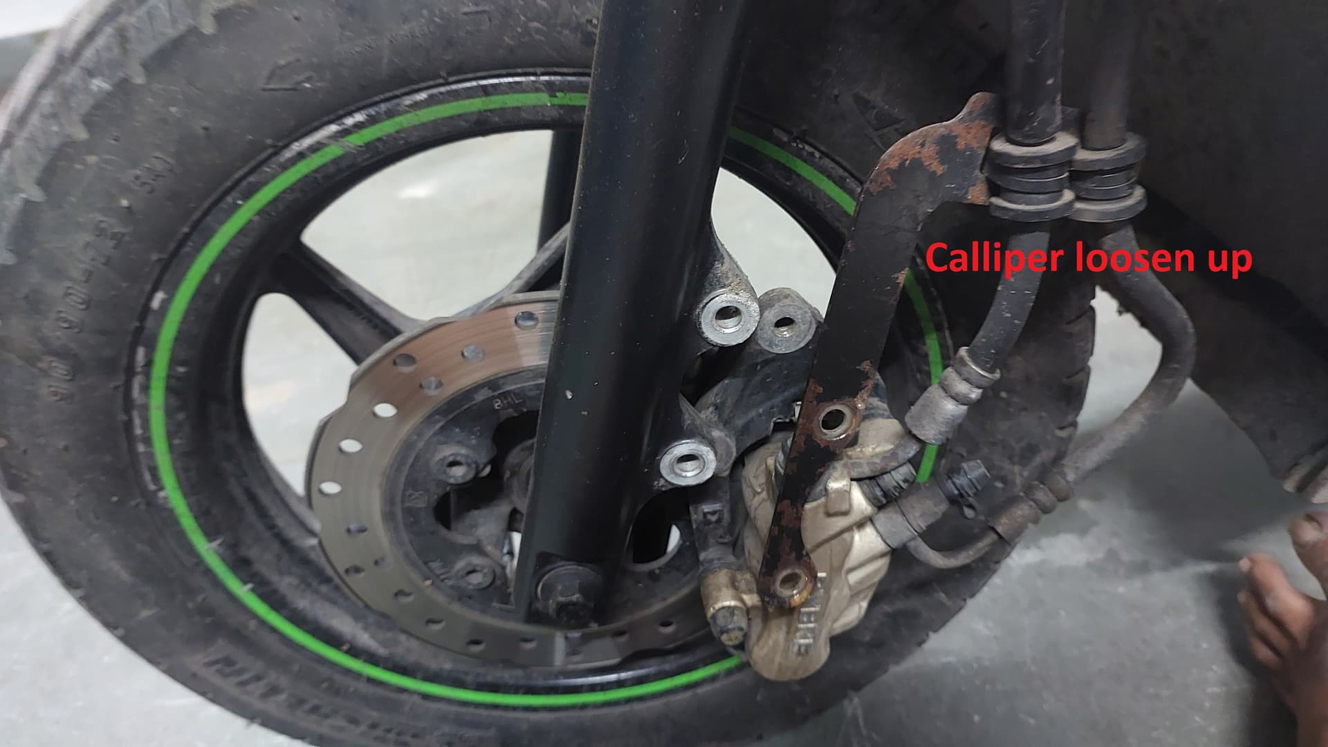

After the calliper bolts are Removed slowly pull away from the Disc shown below

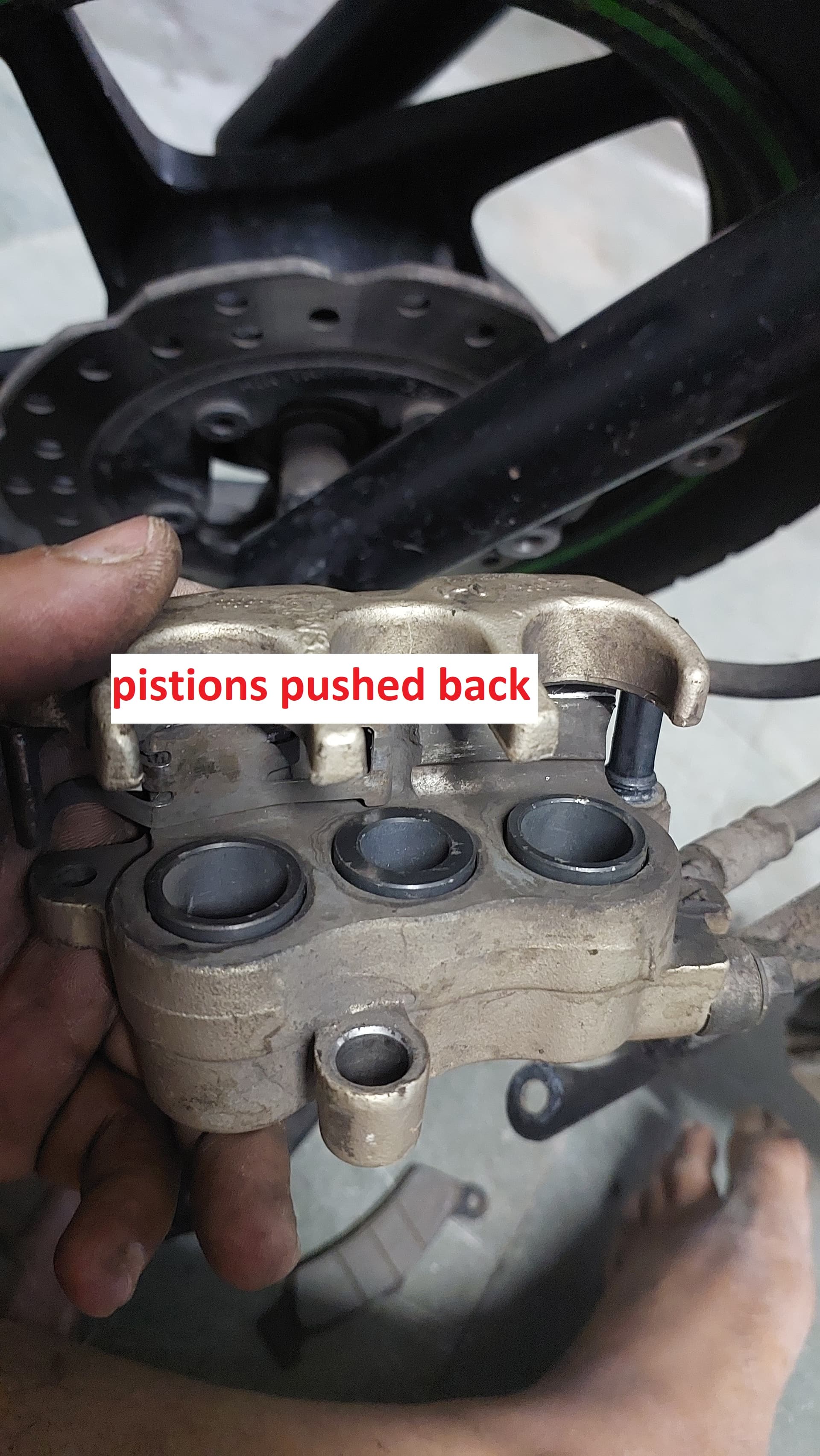

place one of the worn-out pads in the calliper and start pressing on the right side brake and left side brake till all 3 pistons touch the pad,
Spray it with brake cleaner around the pistons and dry it out (do not push them back with brake cleaner on it let it dry completely or, it might contaminate the HYDRAULIC brake fluid)
now using the old pad push back the pistons with the help of a screwdriver or piston pusher

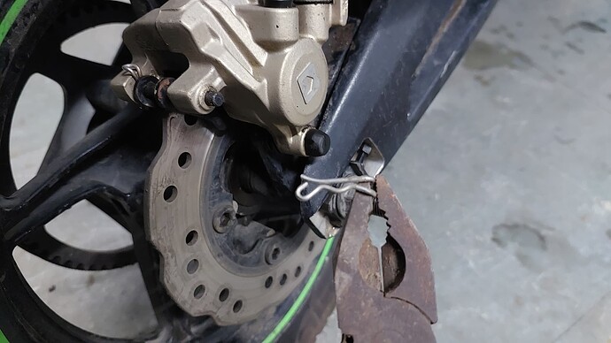

Locate the Locking pin’s quarter pin and pull it with the plier.
Now slide the locking pin into the wheel side.

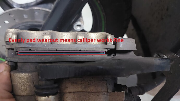

Inspect the pad for even wear. Important.
If the 1 pad is worn out more than the others, it means the calliper guide pin is not working properly and needs to be lubricated. (Topic will be covered in future)

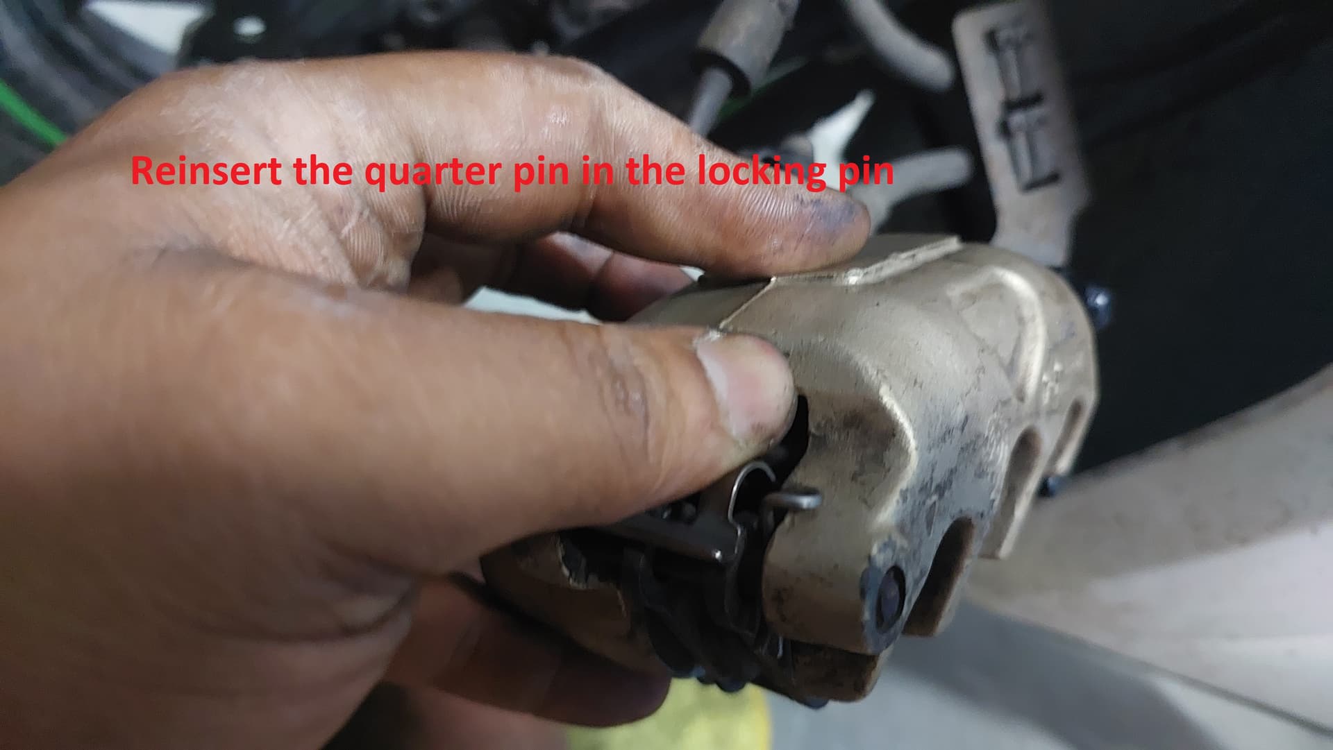

Reinsert the locking pin into the calliper
Reinstall both quarter pins into the locking pin

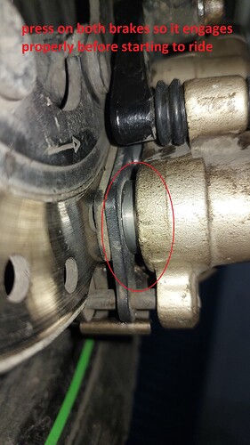

Now press the rear brakes to engage the pistons firmly
Now we are done with the pad replacement
