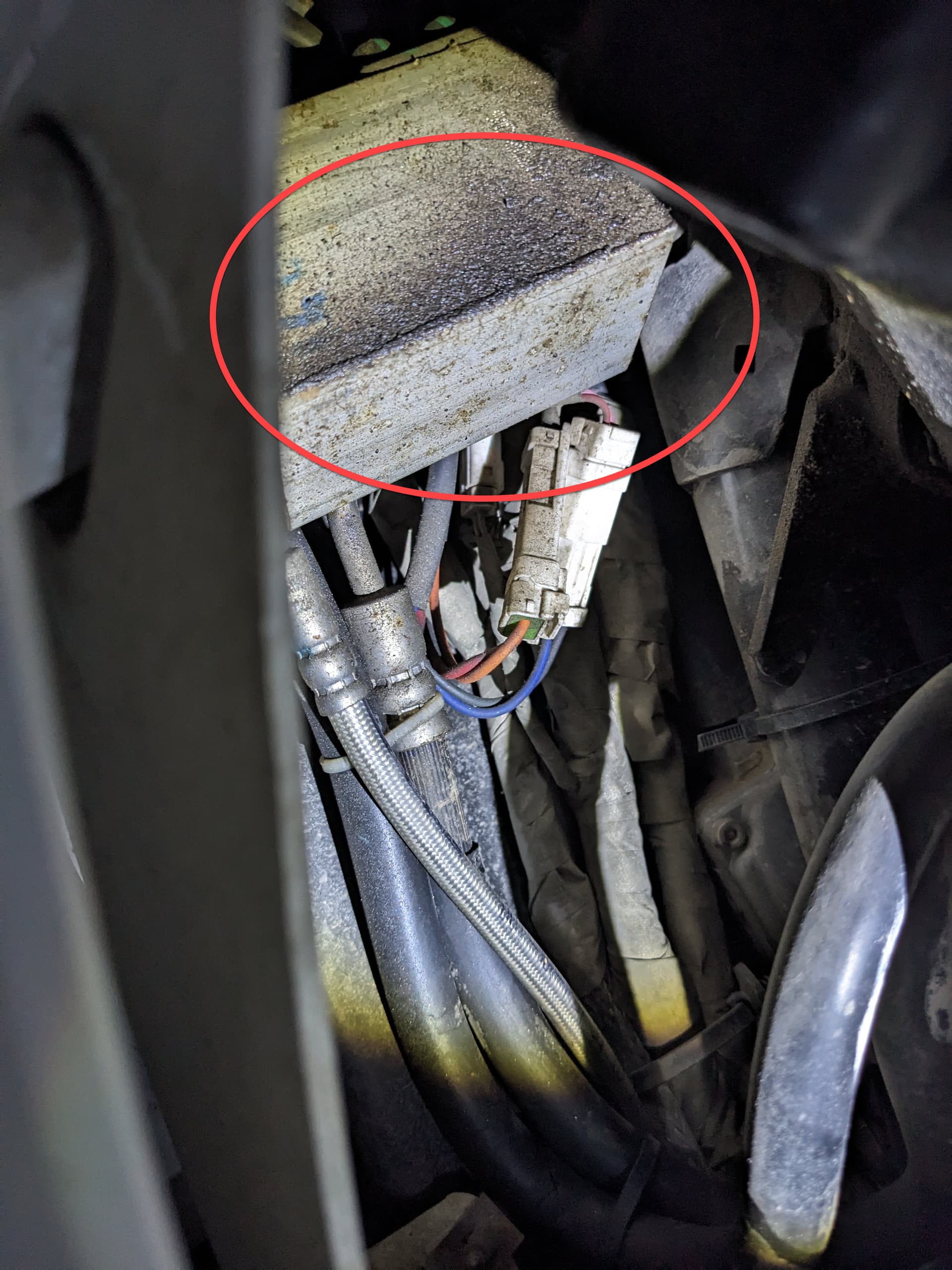

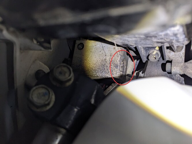

Today while riding my Ather 450 (bought: June 2019, ODO reading: 6700km), the back brake was having a squishy feeling. I checked the rear brake lines and everything seemed ok and could not spot a leak. Brake fluid level seemed low. I also thought of checking the CBS unit (located above the front tire on the left side when facing the scooter) and spotted a leak. I later read the unit is called an equalizer or pressure regulator (not 100% sure, if someone has more info on this please share). I could spot a leak coming from a hole on the side of this unit (please refer to the attached pics). I was wondering if anyone had a similar issue and what was the solution (please mention the spares and labor costs)?

Is it dripping when you press on brakes?
If yes try to analyse where its coming from, as I can’t see the actual leak. If its coming from a bolt holes, then its a easy fix, you need m10 copper washers and remove the bolt change the washers and refix them.

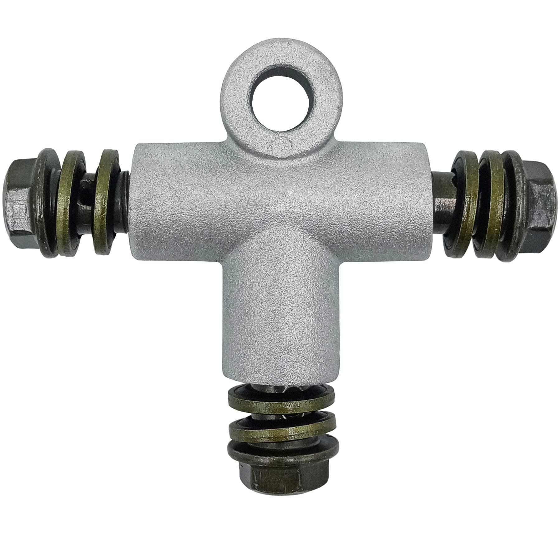

But if the body is cracked and leaking then this part is mostly unable AFAIK. You will be left with 2 options, get it fixed at Ather or buy a T joint (as this unit is mostly does a job of that) and fix the hoses to it.
Something like this
Got this repaired at the Ather Service Center, Kudlu gate, Hosur Road, Bangalore. As per them, one of the bolts on the valve had come loose and caused the leak. I did not have the service plan so the total repair cost was Rs. 693. As per the new Ather service guidelines, repair labour costs are not covered under the service plan. But I was actually surprised when the advisor told me that if I had the service plan, I would not have to pay anything. Here is the break-up: Break Bleeding - 141.60 (yes it’s break and not brake, copied it from the bill ,:grinning:) Replace HOSE ASSY PROPORTIONAL VALVE TO FRONT CALIPER - 551.06 Total: 692.66 Note: They did not have any specific labour code for repair so they have put the codes for the nearest thing to repair. Also, I had asked them to wash off the leaked brake fluid from the front portion but this was not done.

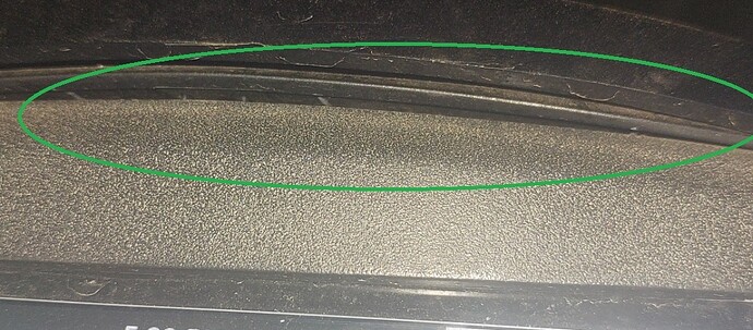

Ather service is bad here in Chennai too, They are just pushing the time limit on scooters to be fixed as soon as possible without fixing them properly. This is the Vela Automobiles here in Chennai.

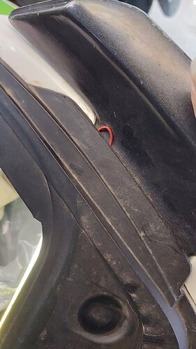

My scooter went for a shroud check-up as I was concerned that might have cracked because of overtighting the mirror bolts, thank god it’s not, but they did not align the shroud back in the panel properly leaving a huge gap.
