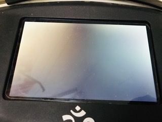

Hello people and Ather Team Kindly help me out fellow members of the forum!

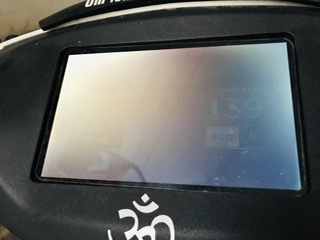

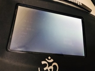

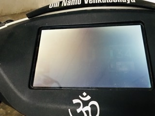

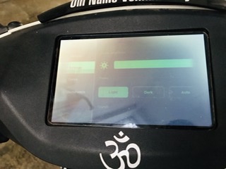

I’m facing this peculiar issue wherein all of a sudden from 2 days the display is blurred out and the readings are visible in a very pale way and flickers sometimes! I’ve neither kept my vehicle outside while it was raining nor ridden it in uneven road surfaces or while it was raining!! Even if it was ridden in rain it must be alright as it’s IP67 rated!!
I’ve raised a concern in the Ather app but no one has got in touch with a possible solution!
This had never happened before and I think it should be covered under standard company warranty
But even if it will be replaced how am I supposed to get it swapped as I’m in basic Ather connect plan
@abhishek.balaji had got his screen replaced at his place (home) some time back due to yellowing of the screen and I just want to ask if that can be done in my case too at the convinience of my home!!
As either picking up and dropping the vehicle by me to IBC Knowledge Patk is also not feasible or by Ather is also chargeable as I’m not covered under Ather One 360 plan!!
Kindly suggest a possible solution for the same! Thanks in advance! @tarun @swapniljain @abhishek.balaji

This should be covered under the 3yr warranty for sure. As for doorstep service, I am not sure under current circumstances if they have sufficient staff to send out for a house call.
Please log a ticket, customer service team can elaborate on the options you will have.
Hey,
The team will reach out to you to understand how this happened, and if it’s covered under warranty, you should get this fixed.

I’ve already logged a ticket in the app but no one has reverted back!! Thanks for your kind suggestion!!
Hey got an update from the team that they’ve reached out to you regarding this and arranged for a service slot for the same.
Yes thank you @abhishek.balaji

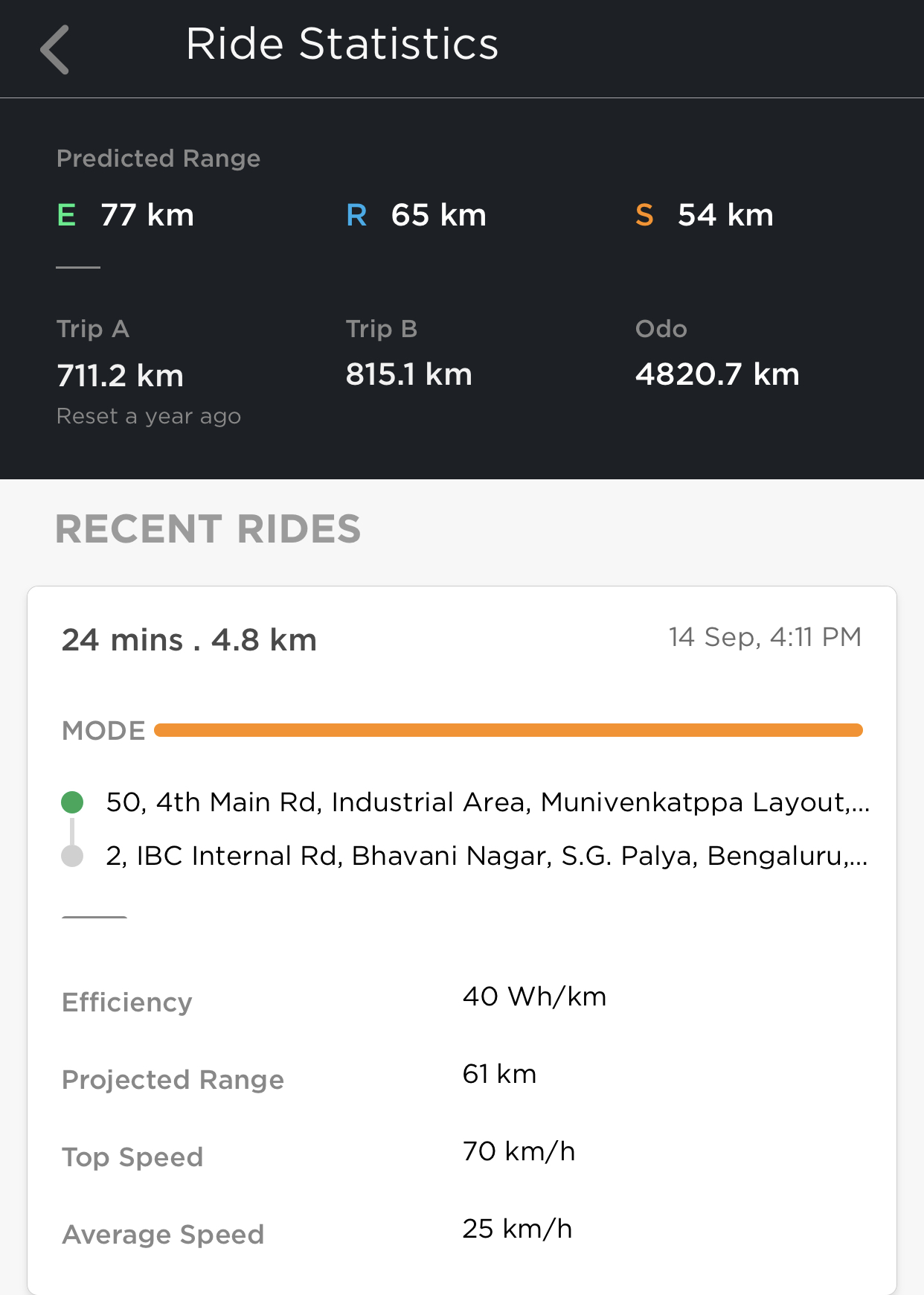

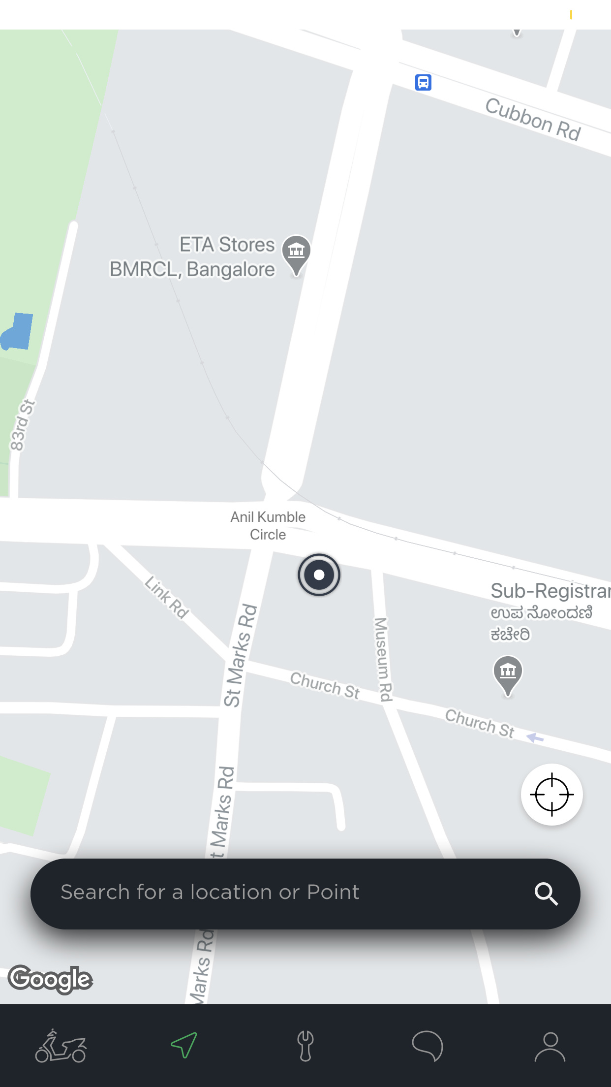

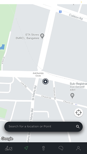

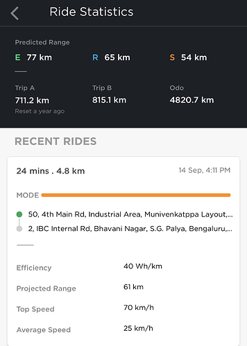

I was randomly going through my Ather 450’s realtime location and it was parked at MG Road next to Anil Kumble Circle for more than 2hrs!
And the same is also reflecting on the Ride Statistics page that it was ridden to the same location and hence its not a GPS sync error and not something which the customer can tolerate!!
Kindly look into this as soon as possible and revert back to me on why was it used??
I have also attached screenshots from my Ather app for your reference! Kindly look into it as well…! RGT! image|281x500
Why has this been so?
They are not using it for personal use. Even my vehicle was showing the same location while being serviced. It’s either that the GPS signal is inaccurate due to being inside the service building, or they temporarily lock the GPS to that location while servicing.
Yep, I’ll confirm this in a bit. The addresses shown in the screenshot indicate that it was moved from the NS Palaya service Center to the IBC service Center.
Calm,
I’ve seen this particular location on my phone too. Sometimes when th internet is damn lo it shows this location. It’s happened when it was parked in a basement once and once when I gave it for service. ![]()
What about ride statistics then!?
@dr.rakshithgt the pin at Anil Kumble Circle is a location that we all know since long now. Earlier it used to be near Lalbagh. It’s a location which comes up before the correct location is updated. Moreover Anil Kumble circle is more than 5 kms from IBC. So you can ignore that if you ask me.
The ride statistics part…Ather has a Proto Lab near Jedi Mara signal (Just begind Vega city mall). I don’t know what is the issue with your scooter but it may have gone there. It is around 5kms from IBC.
Ather Energy Proto Lab 7th Cross Rd, Industrial Area, Stage 2, BTM Layout, Bengaluru, Karnataka 560076 080 3951 3589 https://maps.app.goo.gl/JZjdWwFMp8VooADh6
Yes I had dropped it there (Proto Lab) myself since the customer support executive had told me to drop it there instead of IBC since I had issues with my screen which is mentioned in above post and didn’t want my vehicle to be picked up by service team from my home!
I was little concerned when I saw it there but am releived after getting to know that it was a known thing due to GPS error during service! And one last thing which I forgot to mention is that I saw many (more than 4) prototypes of Ather450’s which were camouflaged and were in bits and pieces lying in the proto lab!
