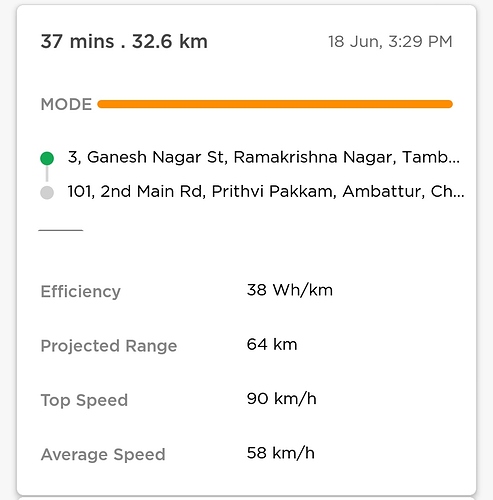

To all my #low power mode club members (M017 & M019) & Ather software version 4.1.4 friends,
I like to update you all my experience nearly after 3 months after the lockdown and M017 issue,
Due to the error the pickup was dam slow and I have highlighted the issue to the service people.
After one week of my observation in local took my flight to a long ride and the performance was really amazing
You can see the amazing numbers in terms of average speed / top speed / efficiency / timing…
Thanks to the Ather Service Team to identify the issue and fixing it.
But one strange thing is I am encountering this problem only after the periodic / regular service Jan 2020 & May 2020 (Hope I won’t get during next service)

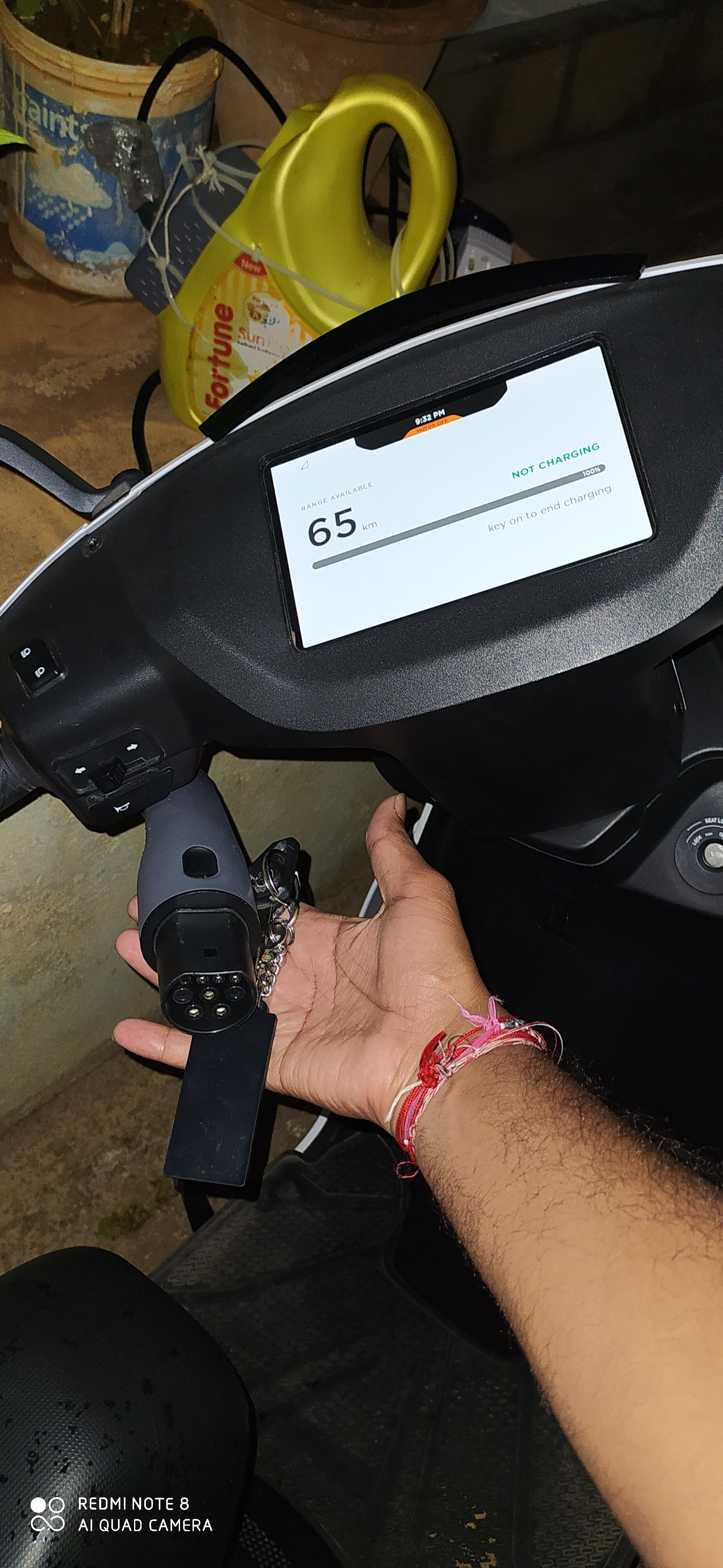

After , 5000km General service facing problem below
- While driving dashboard getting auto restart
- After removing charging pin still showing it’s under charging
- 15kmph to 25kmph having to irritating noise from motor

Did the noise go away or still present after service? I am also facing similar nosie from 10 to 25 kmph
Had a similar issue months ago. Turns out it wasn’t the motor. Checking belt tension and realigning the back wheel fixed it for me.
Issue not solved still there
