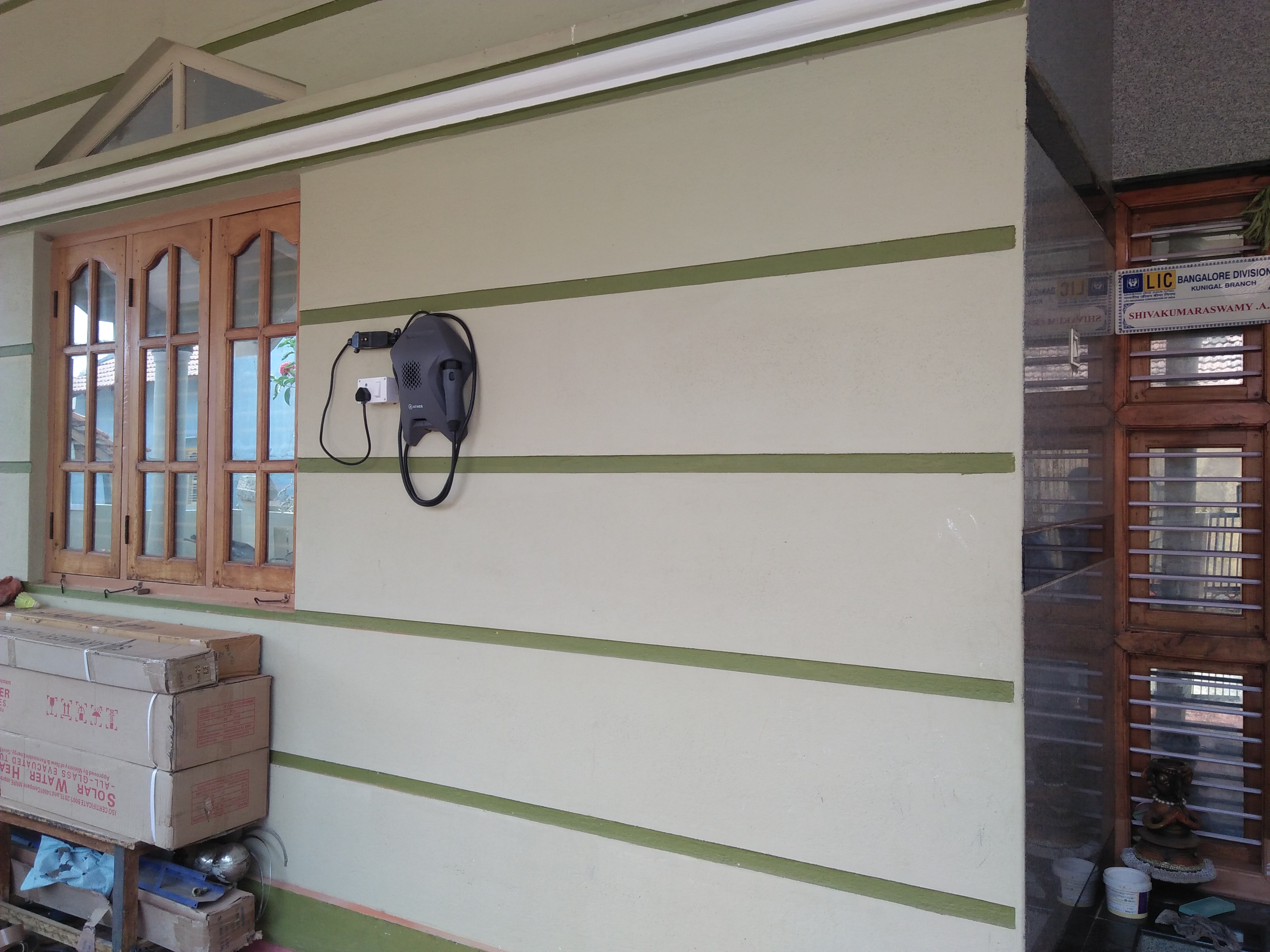

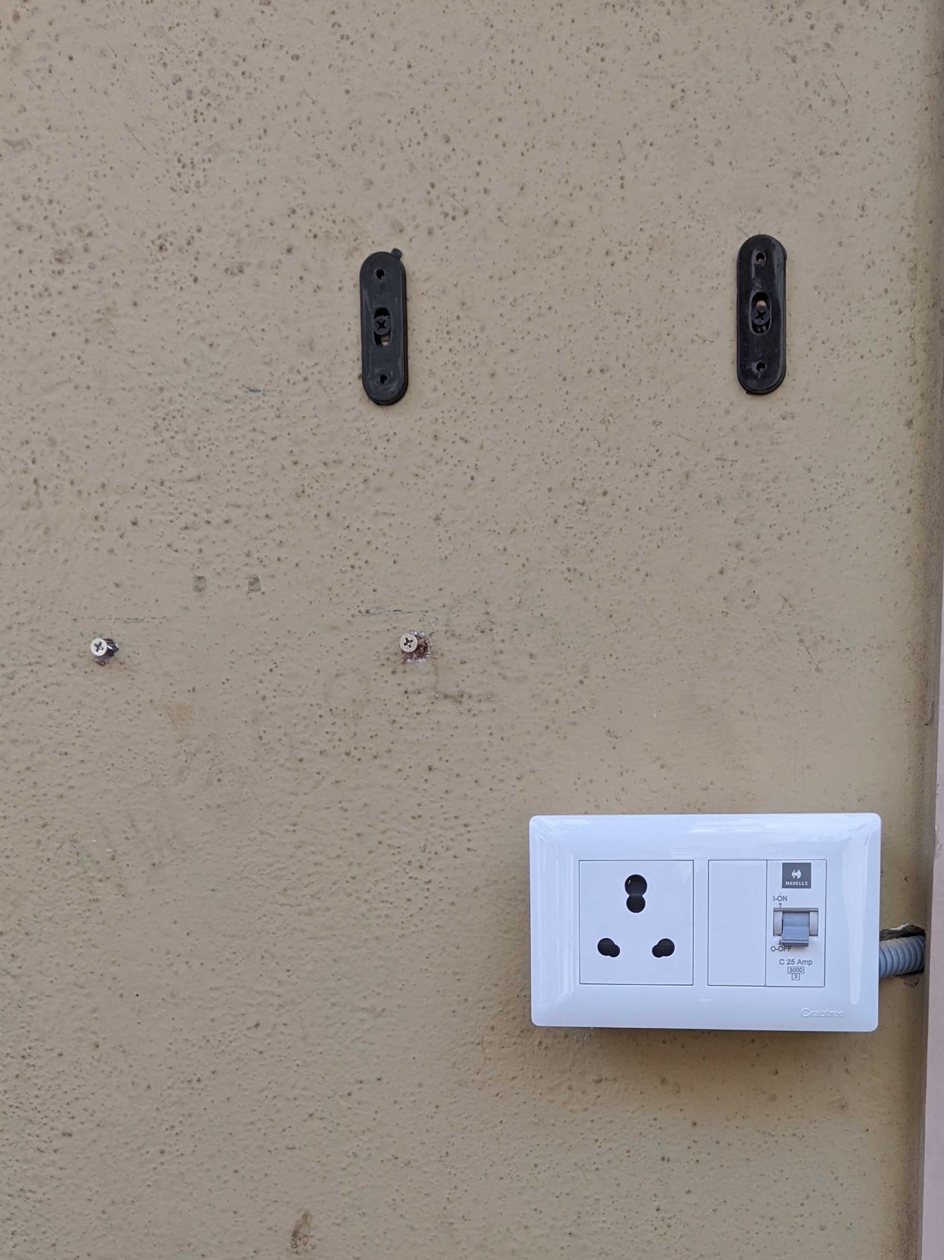

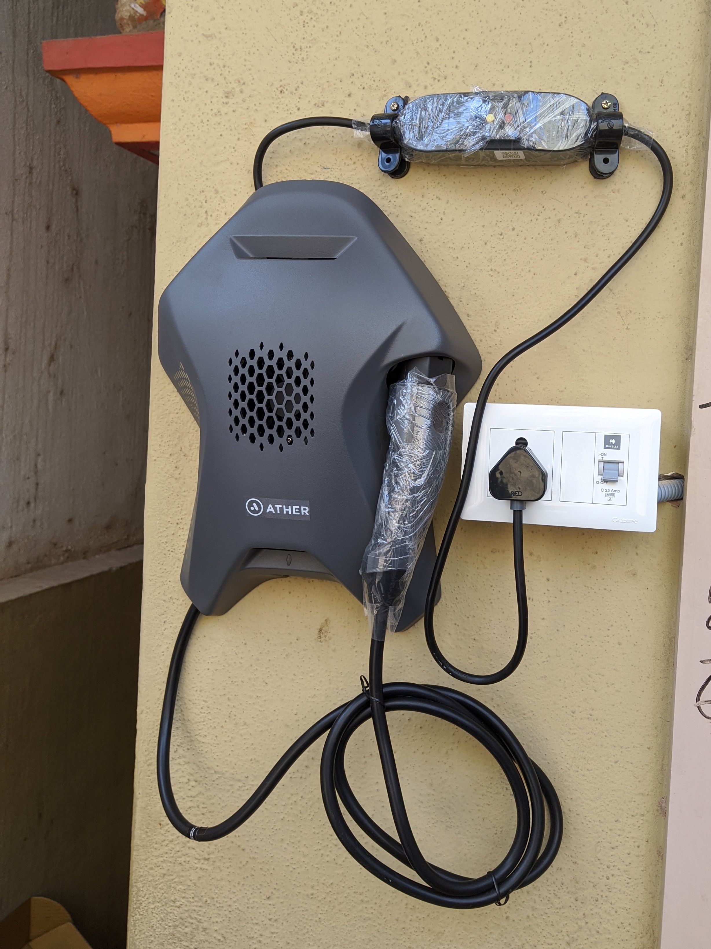

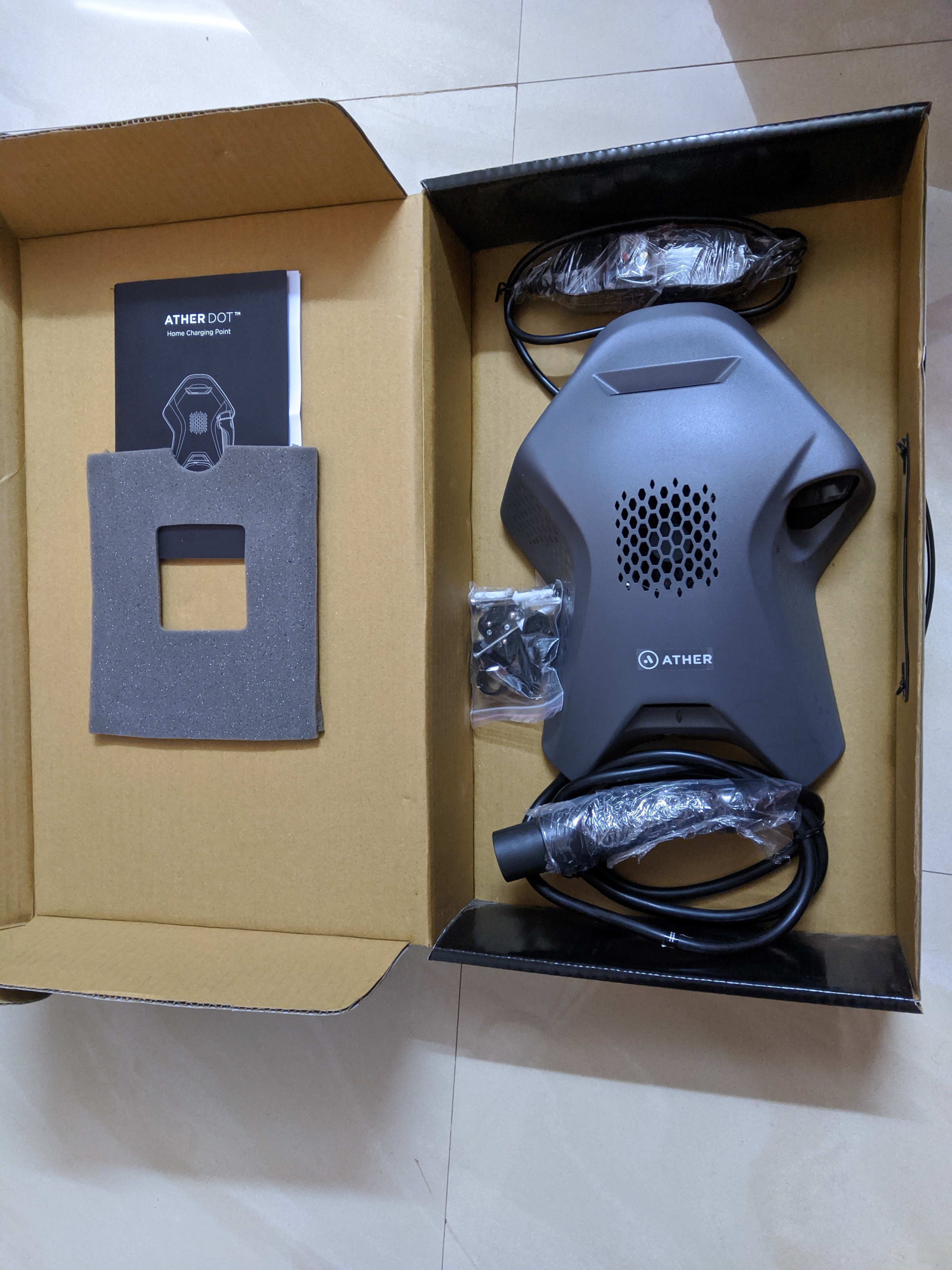

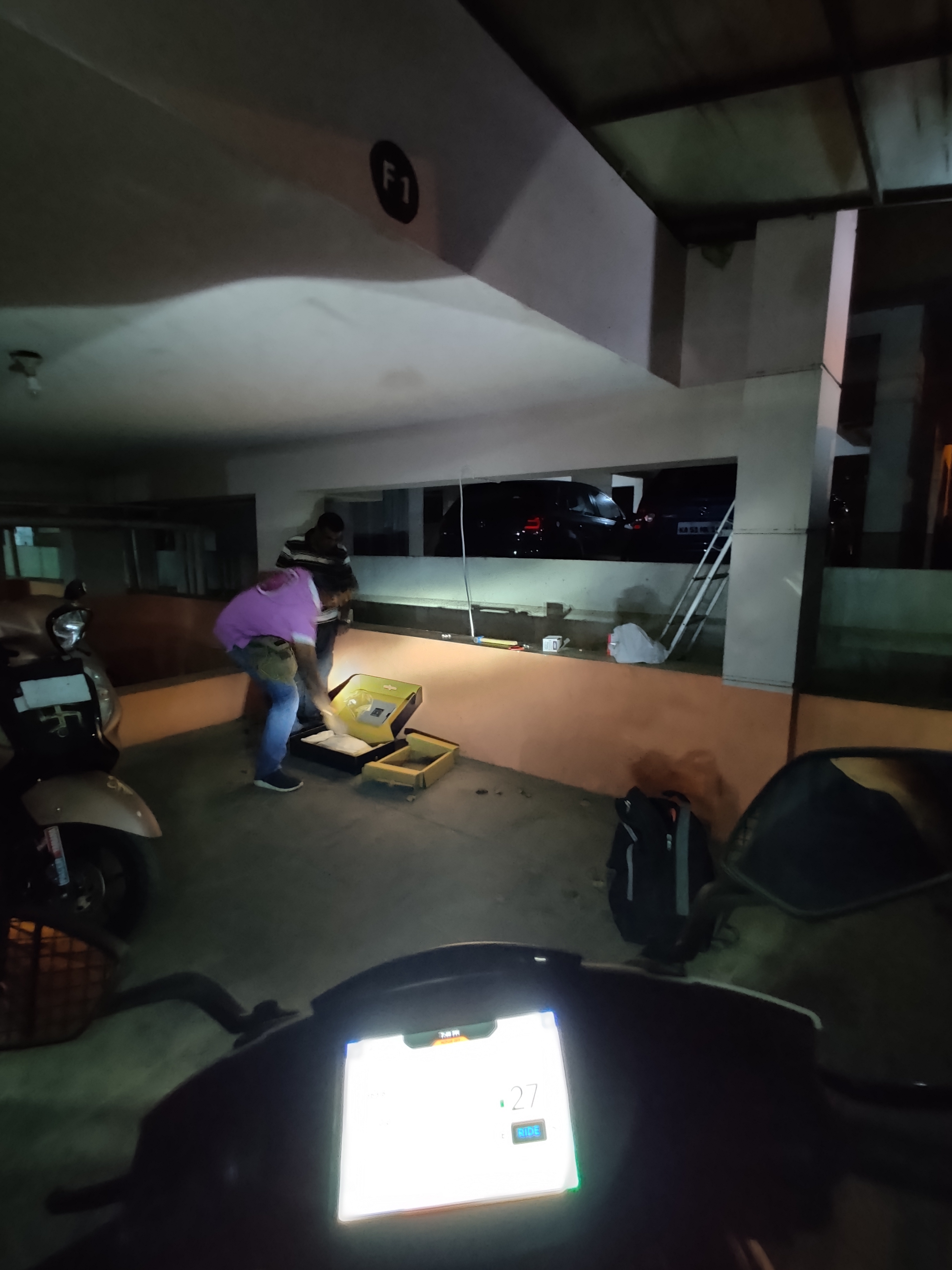

Received dot yesterday.
Called local electrician and got it installed today morning before leaving to work.
Installed the Dot in a detachable way so that I need not worry about thefts. I can attach and plug it to the 450 whenever required.

Looks awesome. It would be great if you put out the bill of materials. Like part name and costs for setup. This will help Others interested in this kind of installation.

Extra things needed are:
- 6A socket. I used a 16A(just to be future proof) socket with MCB which costed INR600. Might reduce your cost if you go for 5A socket which costs around INR150.
- 1.5sqmm wires(length as per requirement). I used 1 meter wires which was about INR40.
Other materials I used was from whatever was available with the Ather DOT.
Also INR300 for the electrician, which you could avoid if you are very familiar with home wiring and are confident with it, but I highly discourage taking the wires into your hands even if you have some electrical knowledge. Either you can ask Ather installation people to do installation in this way(if they are okay with that) if you have opted for Ather expert installation. Or you can take help of your local electrician.
Overall including the charge for the electrician youâll spend around INR500(again depends on how your electrician charges you for installation and considering that you go for a 5A normal socket instead of 16A one).

The position of Dot is too high. I think you should park the vehicle adjacent to the wall to charge your flight.
