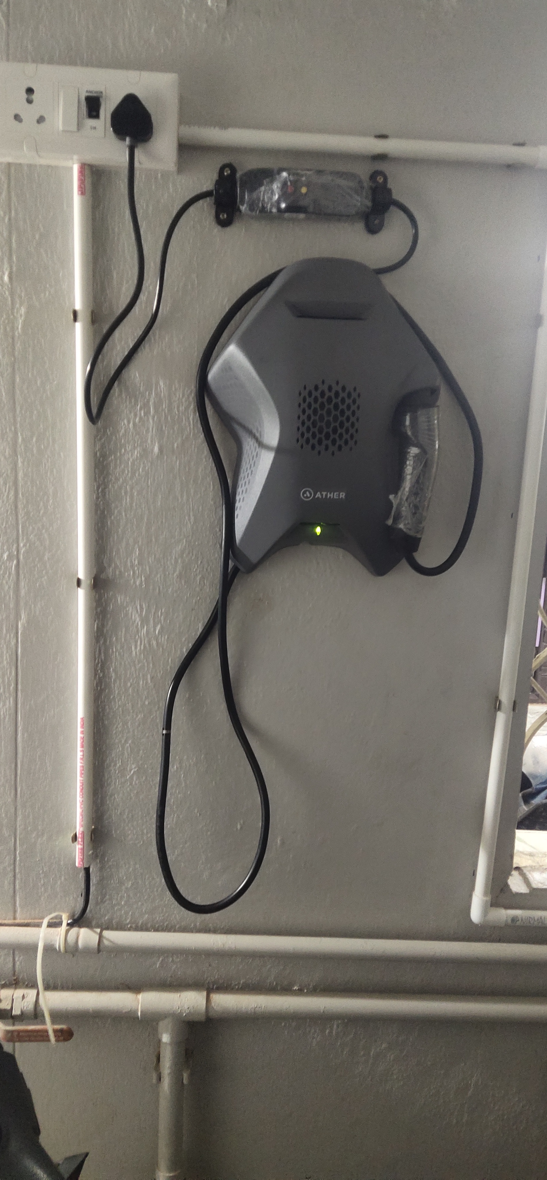

It’s almost perfect what the electrician did all at the house. Out of blue, he asked me to enter inside (below the staircase) and guess what I found 20A sockets for all the floors to the left :face_with_monocle:. Even builder forgot the sockets exist at the ground floor.
He told you should have called me when Ather team visited.
6 meters of wire is what he got and flush finished the job.
No separate connection from 1st floor. No more ladder. No more messing around with clean installation.

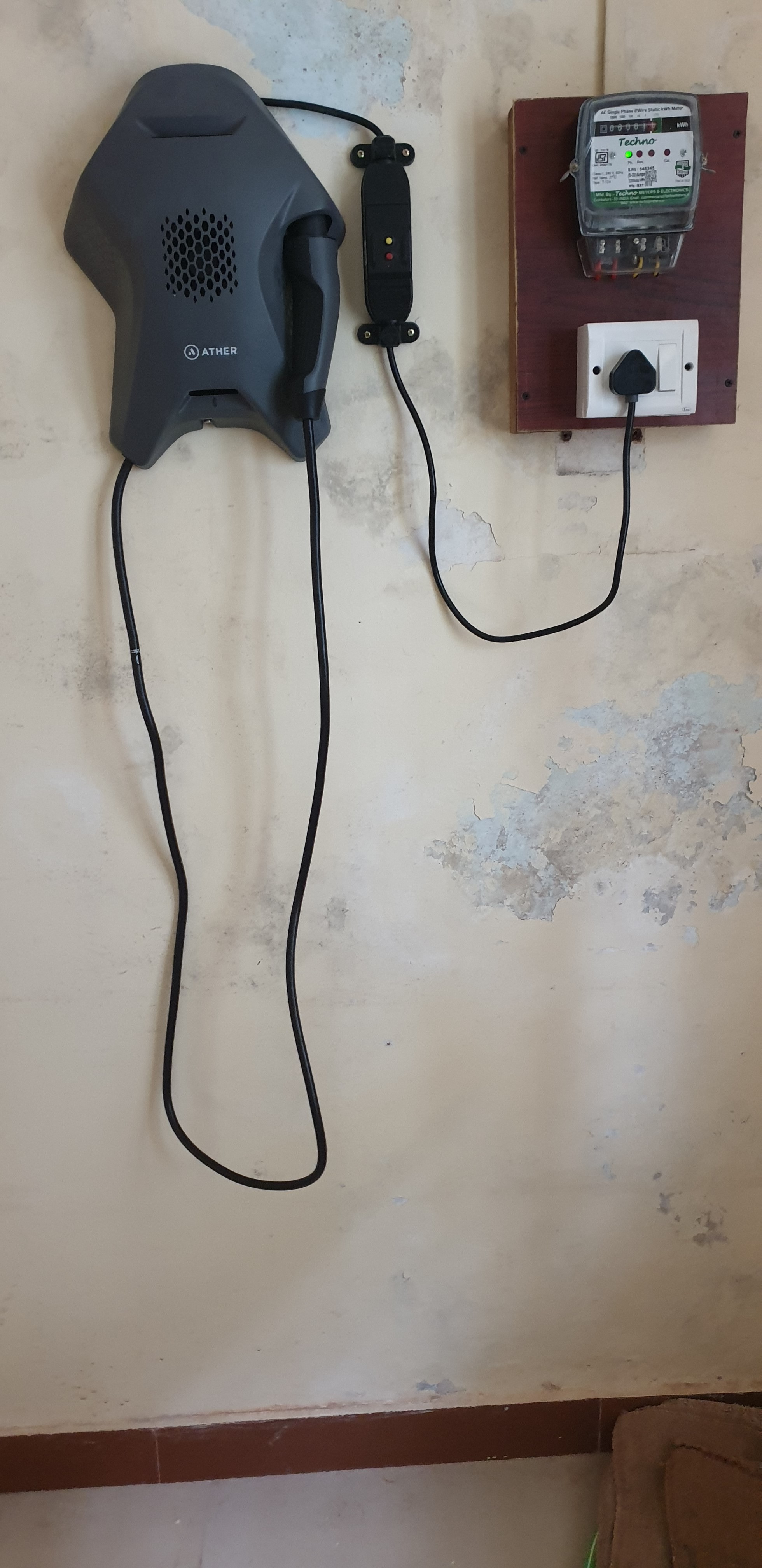

I stay at a rented house, just a short distance from in law’s house, I was in a conundrum as to where I should get the DOT installed, so did not go for Ather team installation mode. Since, the owner of the house didn’t want the tiles to be drilled for putting this charger, I drilled this onto a wooden plank and hung that onto the window grill. A bit rudimentary but worked for my predicament. Only concern I had was what if steals the charger, I am not sure if they achieve anything from that but still that thought lingers on in my mind.
Yes, the same popped on my mind when the Electrician questioned me “What happens when somebody steals your Dot?”
I was like uuugh… “It would be useless for him because it charges only my scooter”
But, still I had that though surfing on my mind for a day.
To be safe arrange to hang the plank inside the window (Other side of window) and draw cable out that will solve the theft issue.
that thought did occur when i did the installation, but it would mean that I cannot close the window :slight_smile:
In case, I proceeded with that, I would need to remove the wire connecting the charger to the connector and then reconnect it, as the connector doesn’t quite fit through the window pane.
