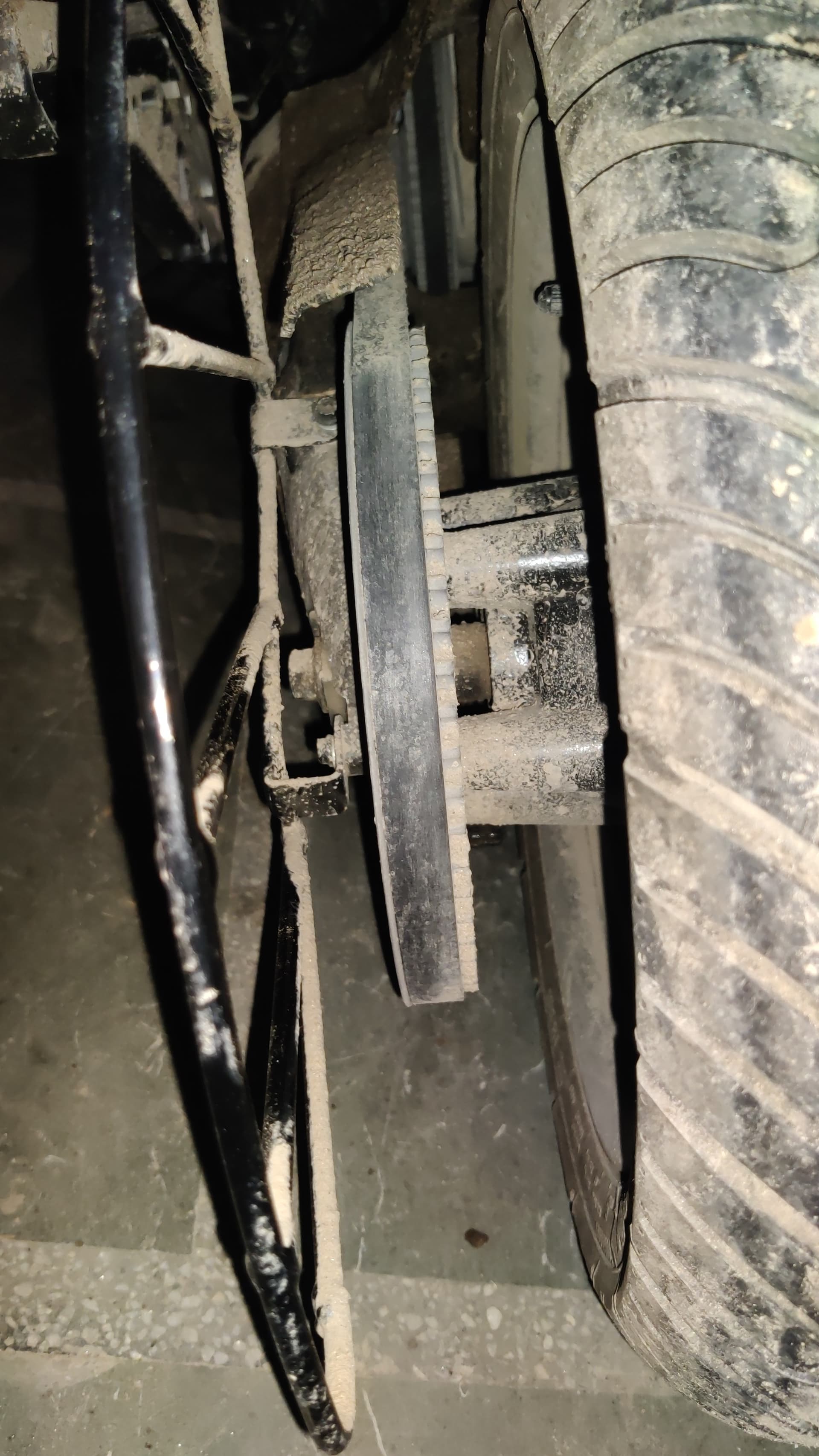

Man, that looks really messy. Try cleaning this and put belt dresser.
Ah. That’s because I traveled through mud.

Your belt looks so different from others. Mine is the 3.1. Got a month back. My belt looks plain.
I request you all to upload your belt pictures here.
Gen 2 belt have those lines or grooves. Gen 3 doesn’t, so it’s making its own lines.:joy:
So which ones are breaking?
Gen 3/3.1, but they are not braking all the way. Just developing some cracks on the outer surface only.
Gen 2 has groves on the Belt and Gen 3 doesn’t , soo plain Gen 3 Belt is cracking on the outer side, My Belt has Many cracks and to my recent visit to Service centre for 5K service and also I raised the same via Twitter for which I was given a feedback form after the service to close the Twitter issue,coming to the concern I was informed that it’s a normal thing and all Gen 3 gonna have those cracks on the Belt so the next question I asked was , how many kms will my belt last? They said it completely depends on my riding style but on an average some get it changed in 10K service and some at 15K service, as Ather Assure plans have been discontinued saying “Product Abuse” , are they gonna cover it under warranty if the Belt breaks? And how many kms does the belt is covered under warranty? What if they say it’s a product Abuse and we need to purchase it and won’t be covered under warranty?

OK it may be issue with desing of belt As you saod that gen 2 belt have groove but not gen3 it may be true But my belt which i posted is of gen3(Means i own gen3 scooter and this is my belt)
This is a Gen 2 Belt , from Gen 3 they started giving plain Black Belt which gets cracks on it after 2-3K kms
correction Gen 3.1/Pro pack has the plain belt,Gen 3 has same belt as 2
Gen 3.1 was introduced in Jan 2023 and i purchased on October 2022 , mine is only Gen 3 and in service center also I saw all Gen 3 has plain Belt , do u have that grooves belt of Gen 2 on your Gen 3 from day 1?
Nope Gen 3 also has plain belt. Plain belt has been used since April/May 2022 whenever the Gen 3 deliveries started.
Yes i have it from day one

I have a october Gen 3 and I have only seen plain belt on 3.1 since 2023.Atleast in maharashtra
